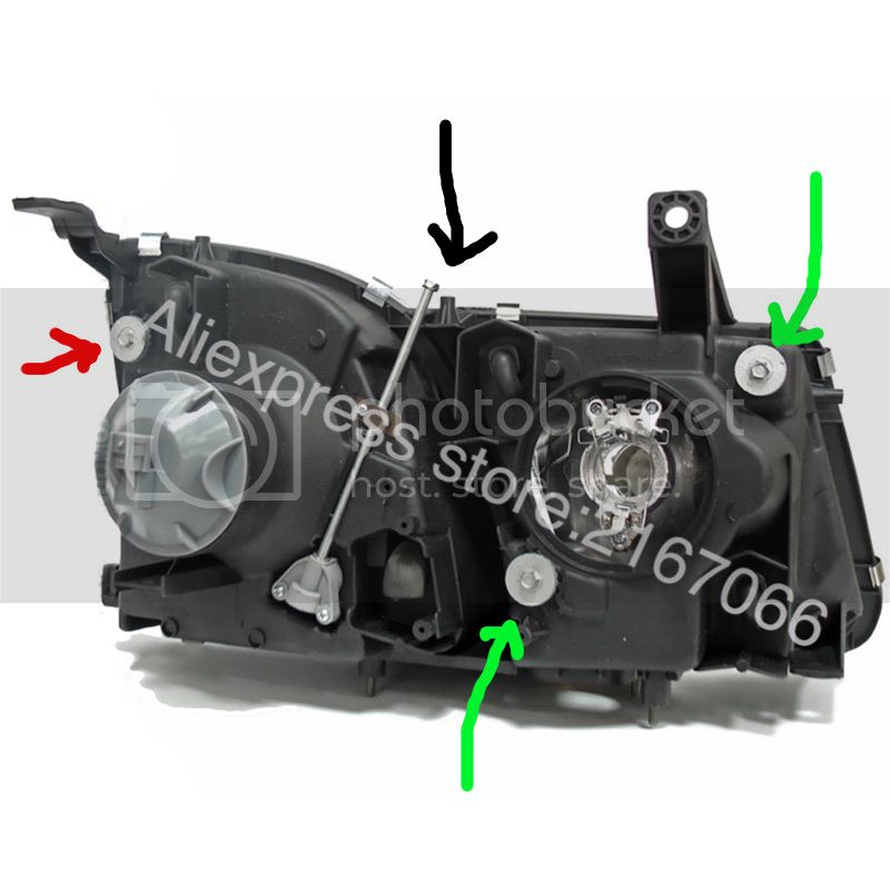

There are adjustment slots/bolts, accessible from the top of the headlight that work as adjustment bolts. The up/down is on the inner side of the headlight (left side of drivers headlight looking at it) and looks like a long bolt sticking up. The left/right is most likely covered with a metal "protector" and is on the outer side of the headlight (right side of drivers headlight looking at it) and is your standard headlight adjuster. Pretty simple after that. I have pics I can upload if your still confused.
There were several variances of the LX headlight when it came to the backside. Heres how mine looks:
The red arrow is left/right, the black is up/down, and the green arrows are for the high beam. Let me know if you have a different set up.
