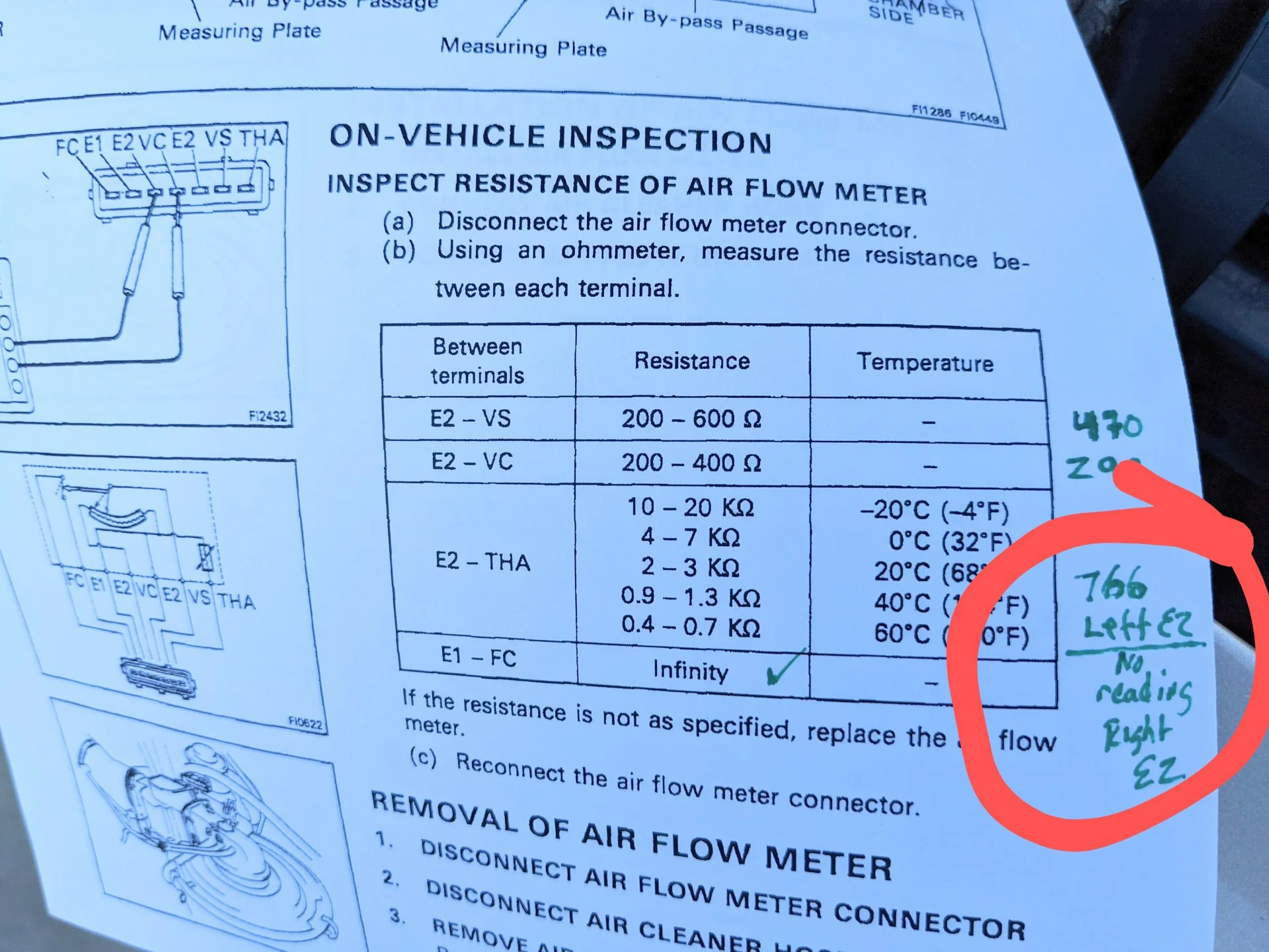

Checked the AFM today per factory manual. Does this mean it's bad (see resistance reading for E2 - THA)?
E2 -THA value looks incorrect to me too (unless it's almost 140F where you were testing).
Yeah one side of E2-THA seemed high and the other side was reading infinity
Well it was hot yesterday (SC) and i had just run the truck so the engine bay was probably 100 degrees... not 140 though. It's interesting that I was able to get a reading for E2-VS and E2-VC for that right E2 pin but not from the right E2 - THA. A short? Need to clean the terminals? I sprayed some contact cleaner in and it made no difference but I haven't used sand paper/etc to clean the pins. Also need to take it off the air intake so I can do the second part of the test (open vs closed resistance).
Any other guidance?
Any other guidance?
Removing the afm from the vehicle is the way to go. I use alligator clip test leads for all these tests because they make better/more consistent contact with the pins. That is interesting about which E2 to use. The circuit diagram makes me think they should read the same. Have you removed the cover for the circuitry?
Yes both E2's seem to be wired together on the circuit diagram so they should read the same. I haven't removed the cover, is that a possibility without damaging it?
I know that people have, but I personally have not. Much more commonly done with the 22RE (very similar EFI system).
