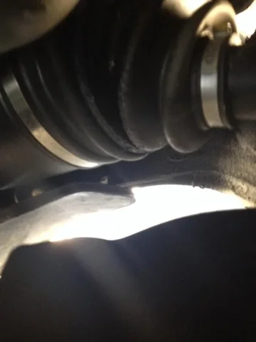

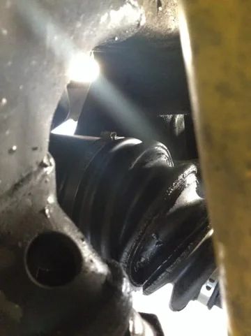

The boot itself has not come loose. The rubber has a cut/worn spot it in. My question is if anyone has had an issue with the quality if the rubber boot itself, ie crappy rubber product. The rubber failed between two of the folds after only a week or so.
Here are a couple photos. My concern is that this is not something that should wear out so quickly, there is little to no friction in this area and I have not taken it anywhere that I could tear the boot.

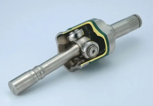

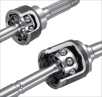

On a side note, are there any photos of an OEM joint next to an aftermarket joint? I'm interested in seeing the design difference.
I think I have come to the conclusion that the napa Tripod style cv joint just doesn't handle the angle as well as the toyota OEM rzeppa joint design. Here are some images of the OEM (top) and Napa (bottom). Bear in mind this is only as to the upper(inner) joint, both Napa and OEM use the rzeppa design on the outer joint.
I am also pretty sure that there is a QC issue with Napa parts, the PS has a napa CV joint from the previous owner(not sure when it was installed) that appears to have held up just find. Nonetheless, I will be installing OEM on both sides.

No tears or cuts, two shafts in under two months, boots wore singular small slits between rubber folds and shafts started clicking within two weeks of each install. I was doubly careful to check for tears the second go around. In the first posting of pics you can see where it appears that the rubber has essentially worn its self down.
