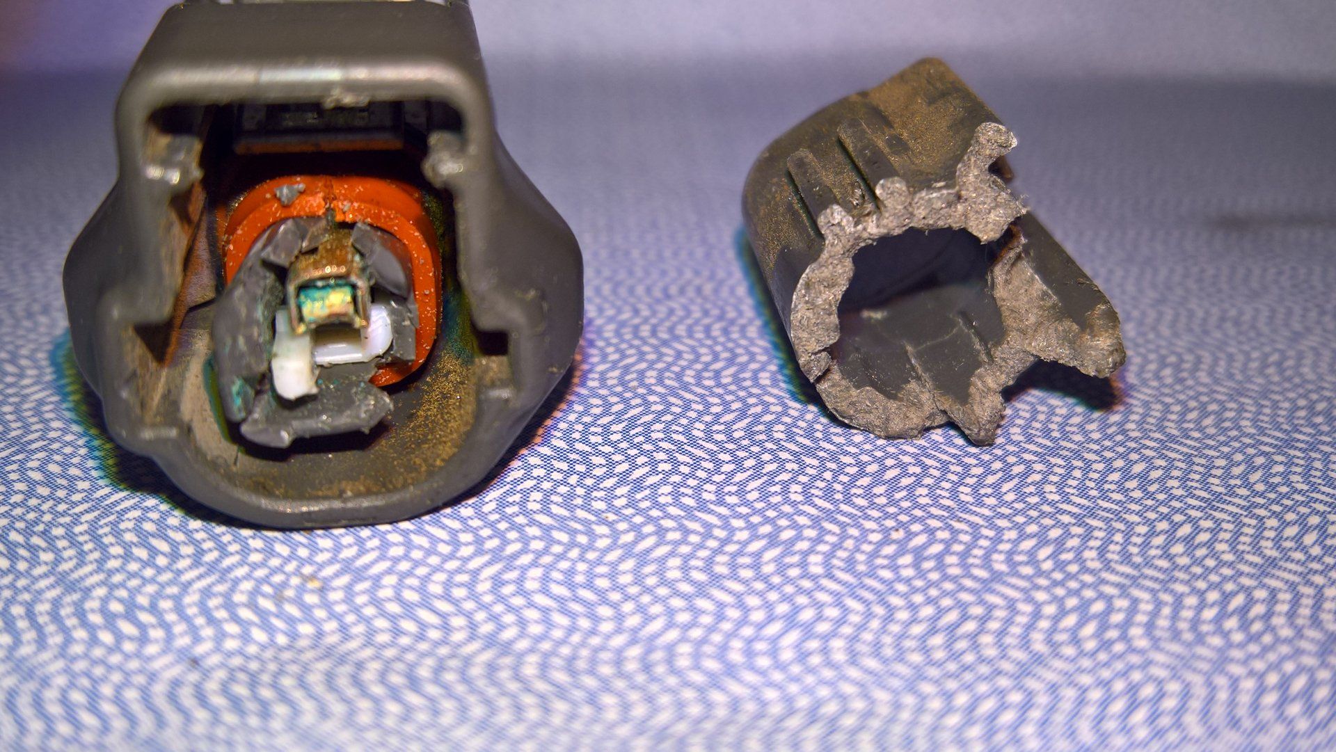

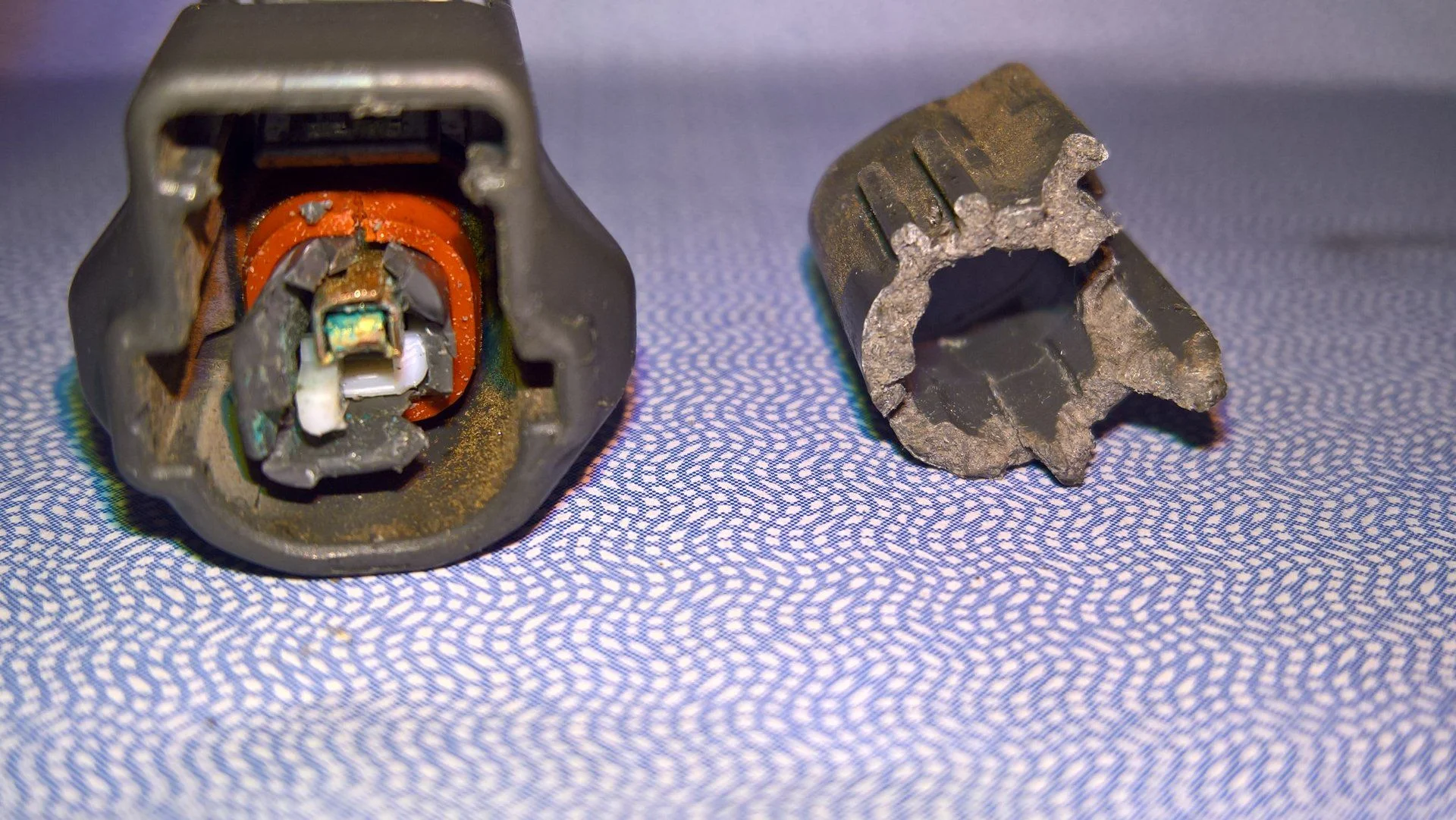

Recently found the #2 Knock sensor connector to have snapped off, the connector was just loosely hanging on the knock sensor, the tip off was an intermiitent loss of power.

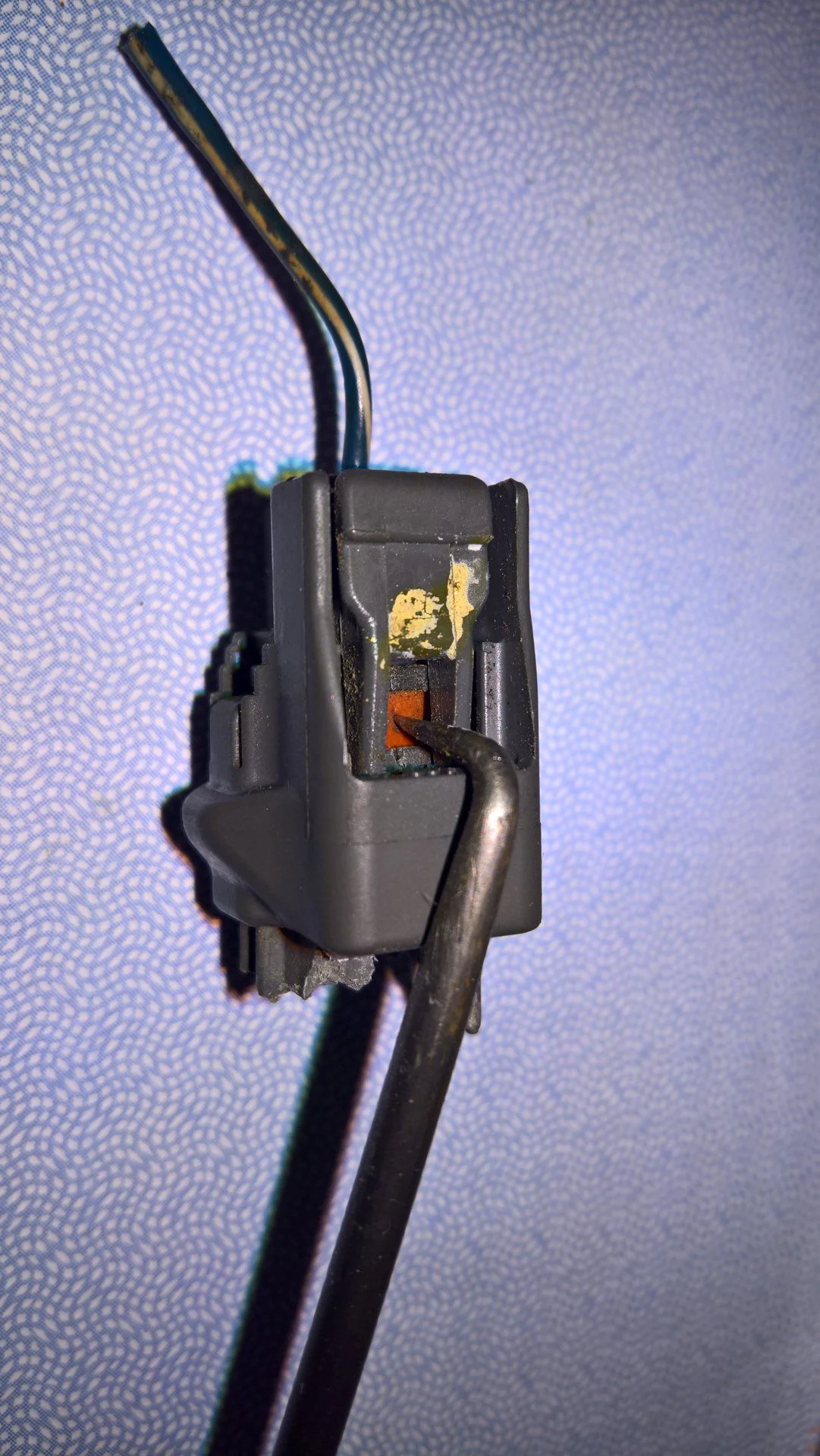

So the sensor connector piece was stuck inside the harness connector and after a few tries was unable to remove the stuck piece so cut the harness wire in order to work on it with two hands.

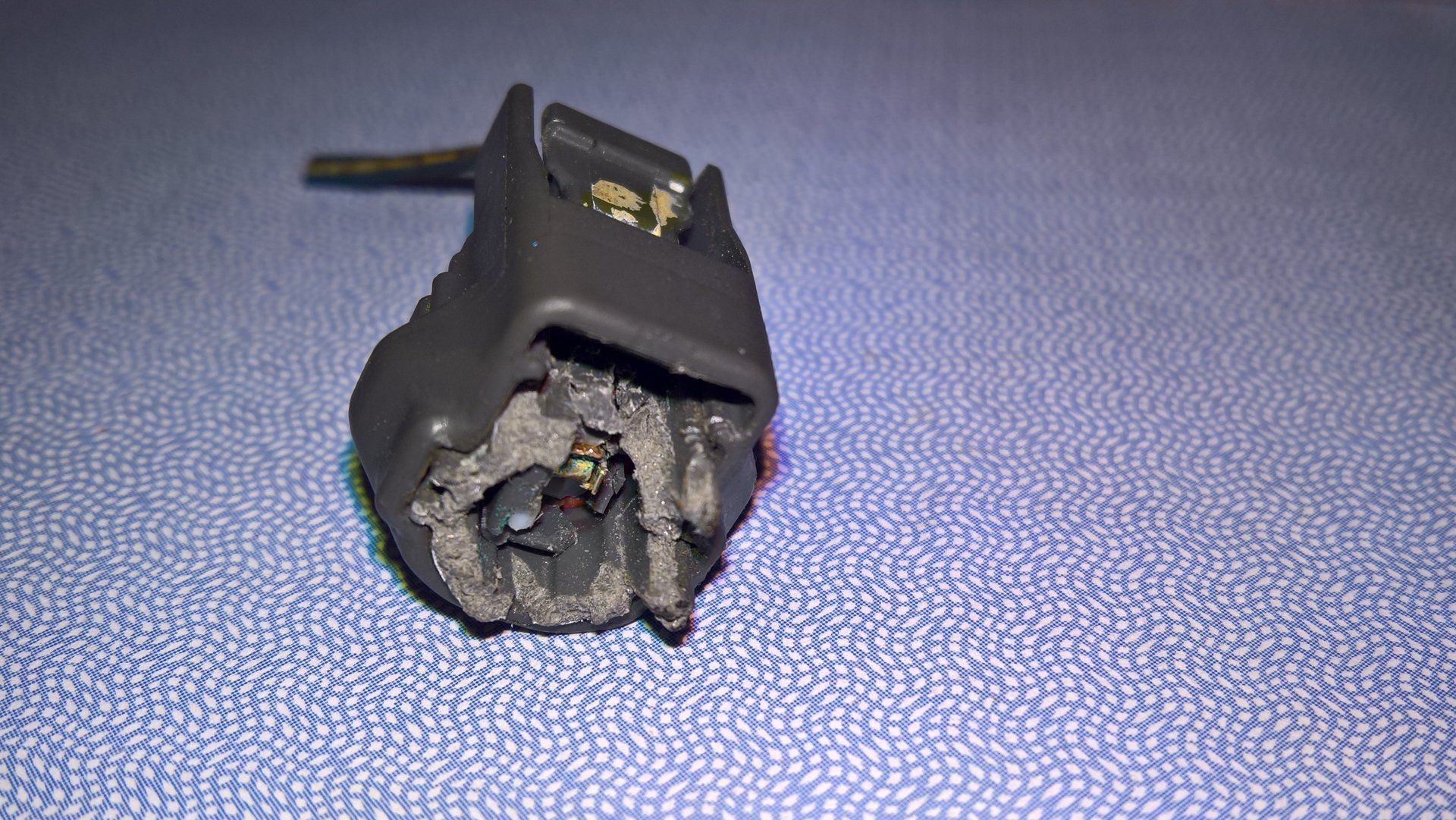

Once out on a table was able to pry out the stuck piece piece using a pick but then found the carnage I had self-inflicted on the connector trying to pry out the stuck piece while working up through the wheel well.
Got so focused on trying to pull the stuck piece out forgot that you could put a pick into the top of a connector to pry out a stuck piece. Having said that, to get the release tab pressed in enough took two hands, one to hold the part the other to press. Just couldn't do it working through the wheel well. Still learning (and relearning).

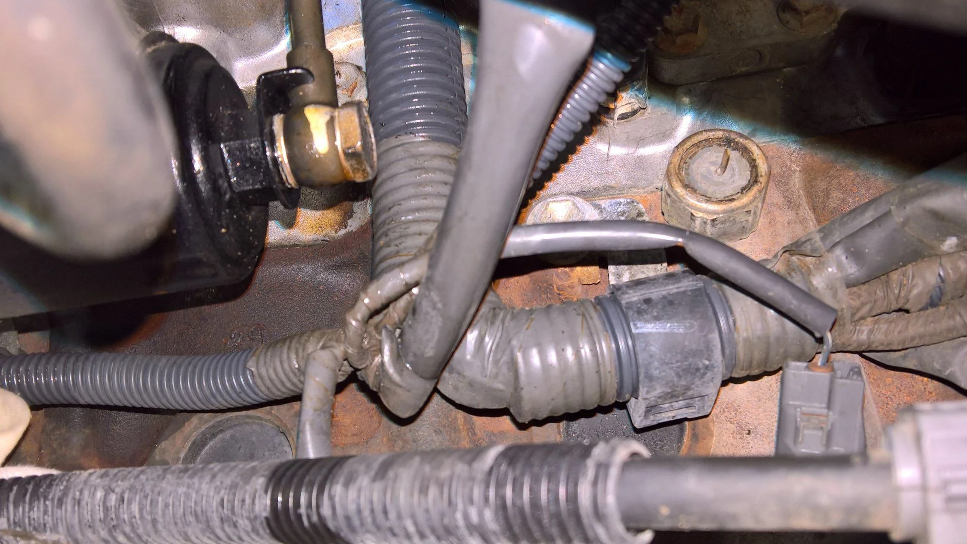

First photo below shows the broken #2 knock sensor as seen
from the left front wheel well (wheel removed) for orientation
The #2 sensor is easy to reach from that position.

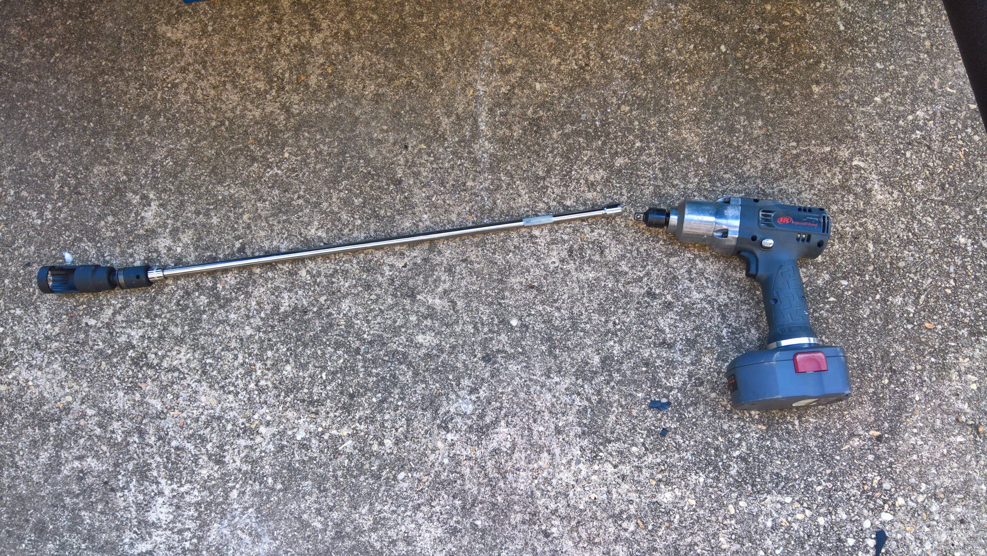

Next photo shows the tools used: 30mm sensor socket (set from HF), wobble extension, 20" extension, 1/2" to 3/8" adapter, and cordless inpact working from the left front wheel well.
