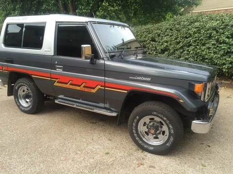

Purchased an '89 a few months ago from Landcruisers Direct. After dealing with rust issues with my 40, this one was my choice because of its essentially without any rust condition.
I'm thinking my first major mod will be a suspension lift. There is a lot of info on 40 and 80 series lifts and I've done both without too much of trouble. I don't see much tech info on 70 series lift. Is the 70 series install much different than a 40?
That looks like a RHD jap import with its original 26 year old sagged out springs, I've always liked the 70 series old man emu suspension it lifts things up nicely without going overly too high and articulates well for standard replacement leaf springs, the old man emu dakkar springs I put in my FJ75 12 years ago are sitting up nice and high the same as the day I installed them I haven't experienced any sag, the OME shocks I put in were second hand and are still operating perfectly, my experience is that stuff works well and has a good long service life, you guys probably have a far greater range of products to choose from than us down here but I guess not so much for the 70 series. If your looking at putting a really high lift in it you want to look at widening the track as well they are a bit on the narrow side and lose stability when you start lifting too high

Thanks for the replys. I'm going to talk with Terrain Tamers and Cruiser outfitters before I make a decision.
Decided on the Terrain Tamer via Ward Harris and Beno. My experience was good. The installation was straightforward.
Finally rolled it out today. As far as the ride, I left the bottom leafs off and the ride is a bit softer than the 25 year old stock.
