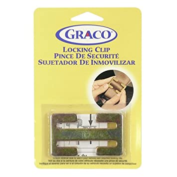

I used a locking clip like this:
to "fix" the length of the seat/shoulder belt a little short and hold the seat correctly (tight). I usually set it to a length where I had to put a knee in the child seat for the belt to "latch".

If you aren't using this clip when you don't have LATCH, then it will never secure. This device is found with all infant carseats that are sold.
You need the clip. It sucks getting the seat tight, but it's a kid so don't do it "good enough".
