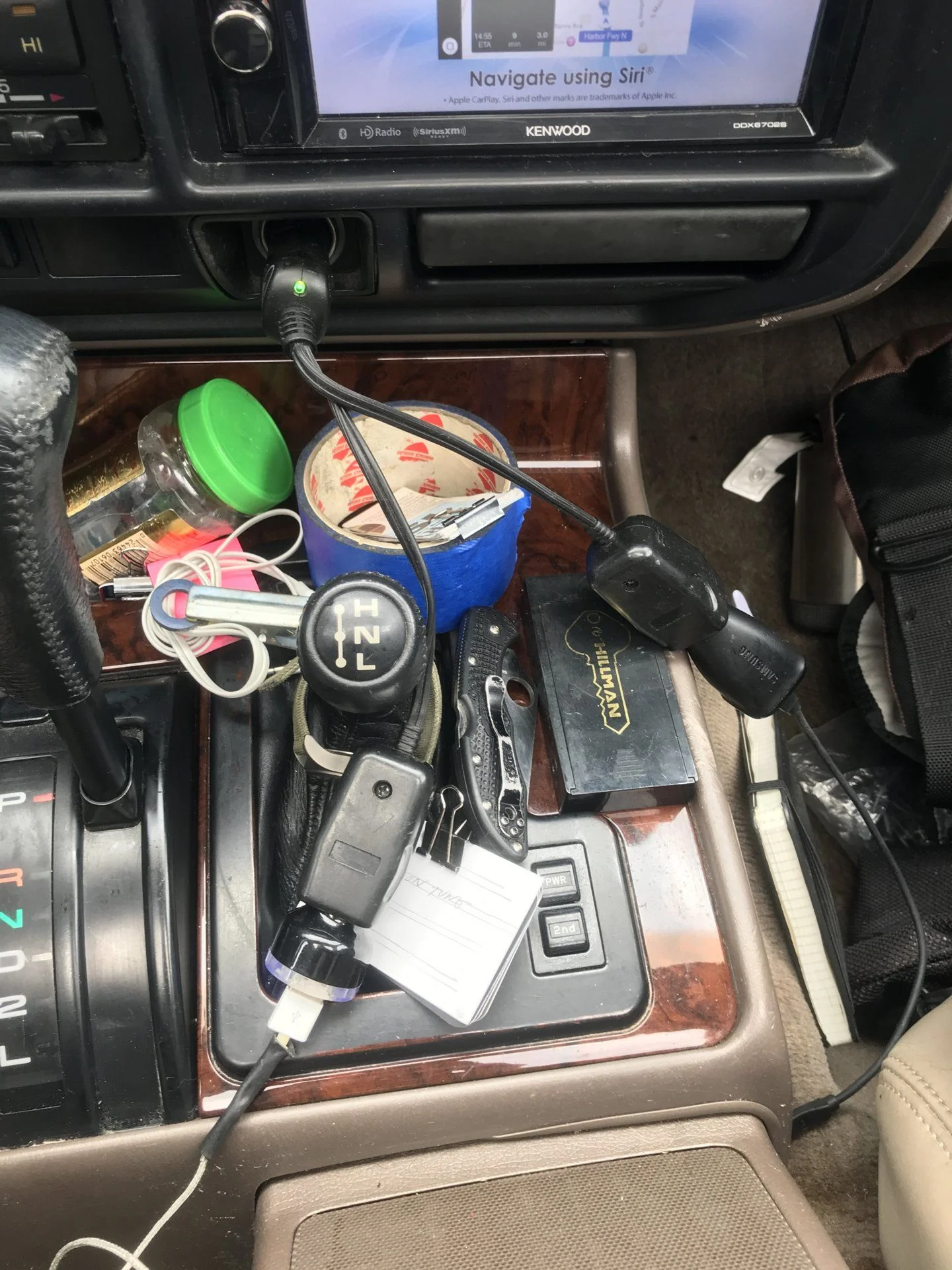

1. is there a good reliable plug for charging a mac air in a 97 LX450 (80 series LC)
2. KEY ON gets power to the cigarette lighter i guess? i guess the Key On pulls more power (not sure how much) than just the iphone charging? is it worthwhile to try to wire some kind of always hot iphone charger and if so how would i do this?
3. i’ve got a cig plug “splitter”. is there a better way to get more outlets and/or any good threads on wiring up more “hot outlets”?
total noob so thanks for any intel.

When you say "always hot" what are you exactly talking about??? To me this would seem that you are looking for that particular plug (or set of plugs in this case) to have power no matter if the key is in the ignition or not. Is that a correct assumption?
Main drawback with this is that if you leave something plugged in you run the risk of completely draining your battery.
For powering/charging your macbook you are looking for a power inverter I would assume. This provides much better power supply to your macbook and will also provide cleaner power. Lots of ways that guys do this, just depends on how many outlets are needed. You could easily mount something in or below the glovebox that would allow for the necessary power supply.

hey man. thanks. yeah, so slowly trying to teach myself low voltage elektrikery. making some progress
just thinking out loud but yeah always hot would be live direct to the battery. switched hot i understand to be what i have now.
so some thoughts? i am thinking it would be a terribly long time for me to drain a battery with an iphone plugged in. i mean. i’d have to dig up numbers but in some ways i am thinking the always hot would be preferable to turning the key to ON and plugging s phone in there to charge it fully.
you know what i mean? i mean, i am guessing but the remount of time it would take to charge a phone to full with the key ON i would guess is more than having a phone plugged in to an”hot plug” that was always on for some number of days.
but i am just thinking out loud really.
maybe i need to keep an external battery always plugged in and when i need to fully charge a phone i pull out the battery and plug it in to the phone instead of turning the key on..?
anyone making a cigarette lighter with no need to invert power?
also - any recommendations on a quality power inverter?
THANKS
