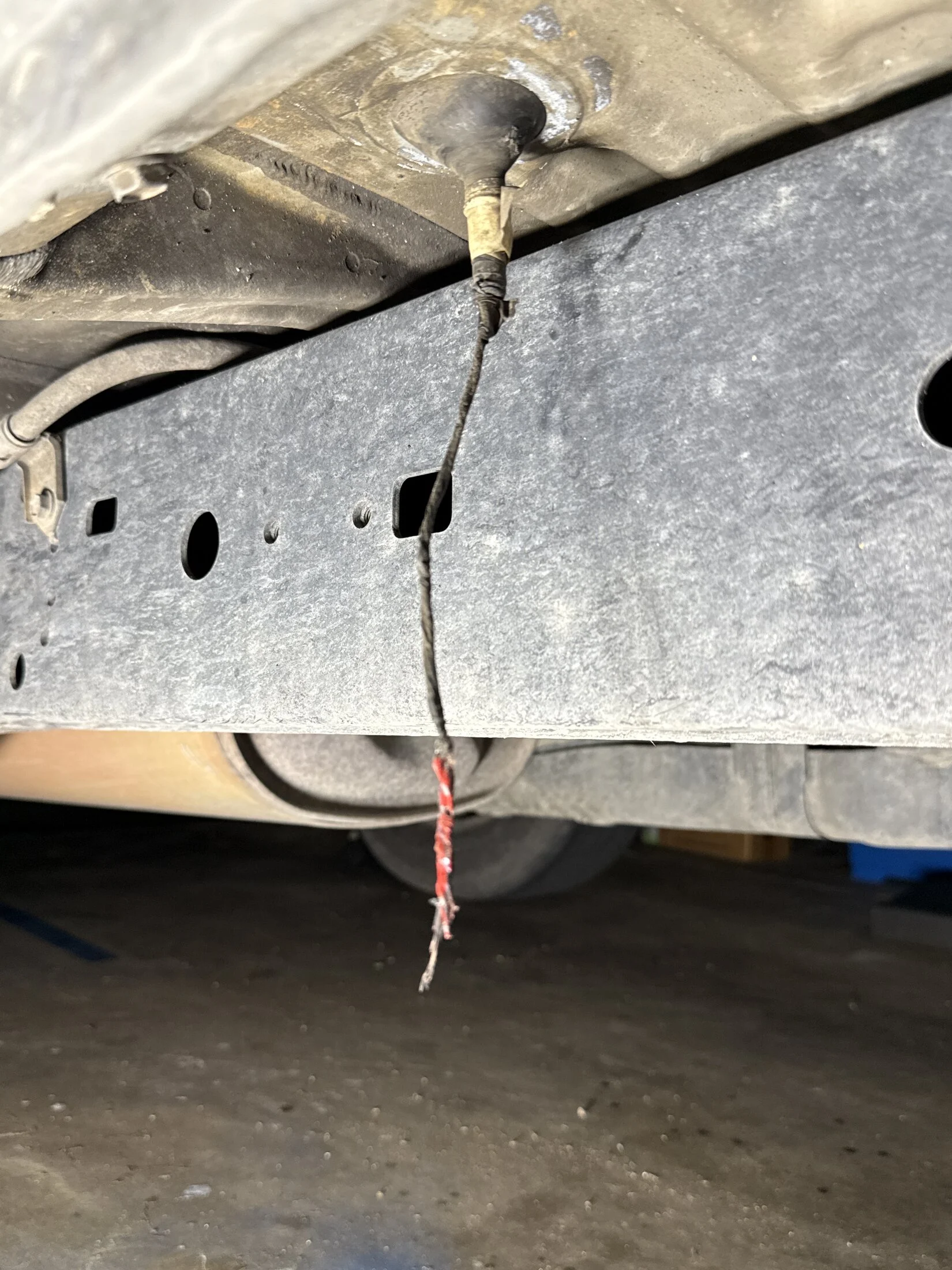

The previous owner of this vehicle removed the running boards in a manner that caused the circuit to short, repeatedly blowing the fuses. I was stupid and put a bigger fuse (15A instead of 10A) which solved the problem for about 10 minutes and then everything above stopped working.

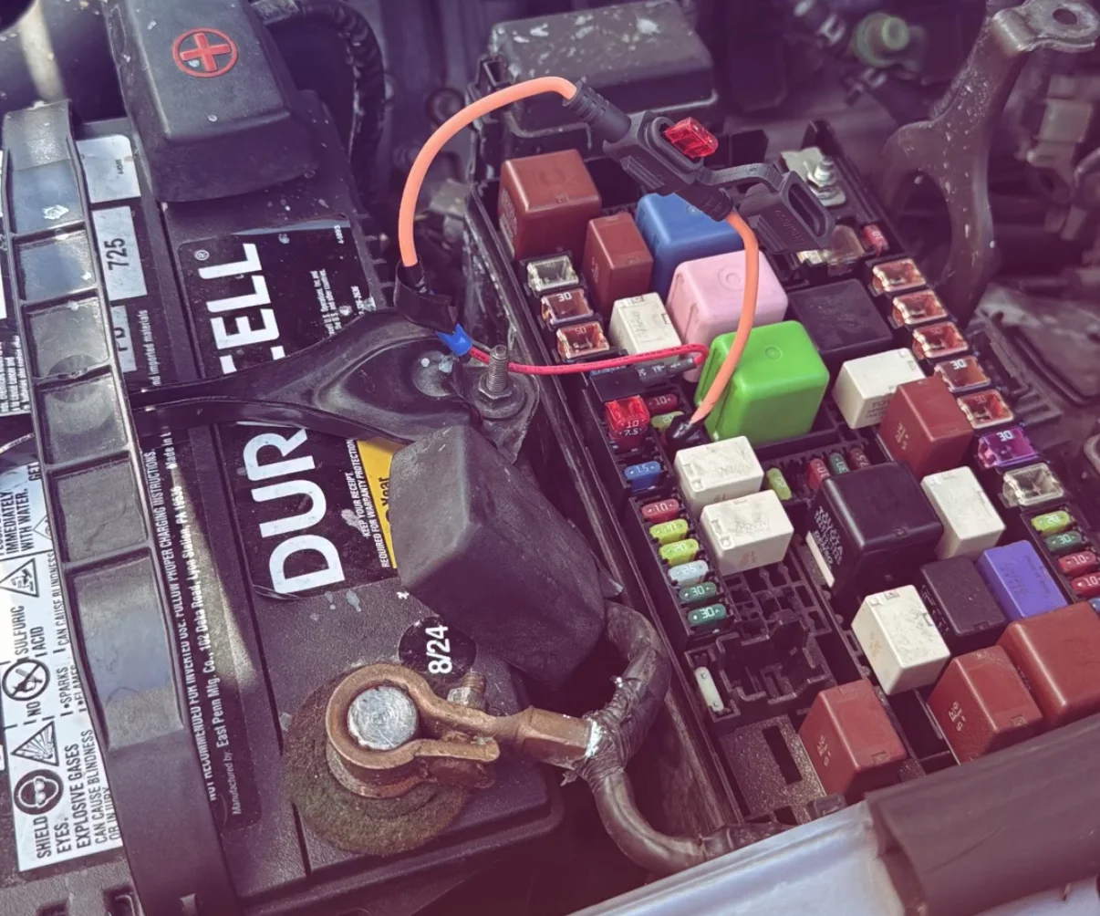

  • Confirmed that the DOME, ECU-B NO.1 & 2, and RADIO NO.1 circuits aren’t getting power at the fuse box, even though the fuses themselves test fine.
  • I can restore power and function by jumping from another circuit using a fuse tap, almost everything came back to life but I don't think I can trust it to stay connected while I drive.

The original culprit.
My fuse tap which fixes the issues.
