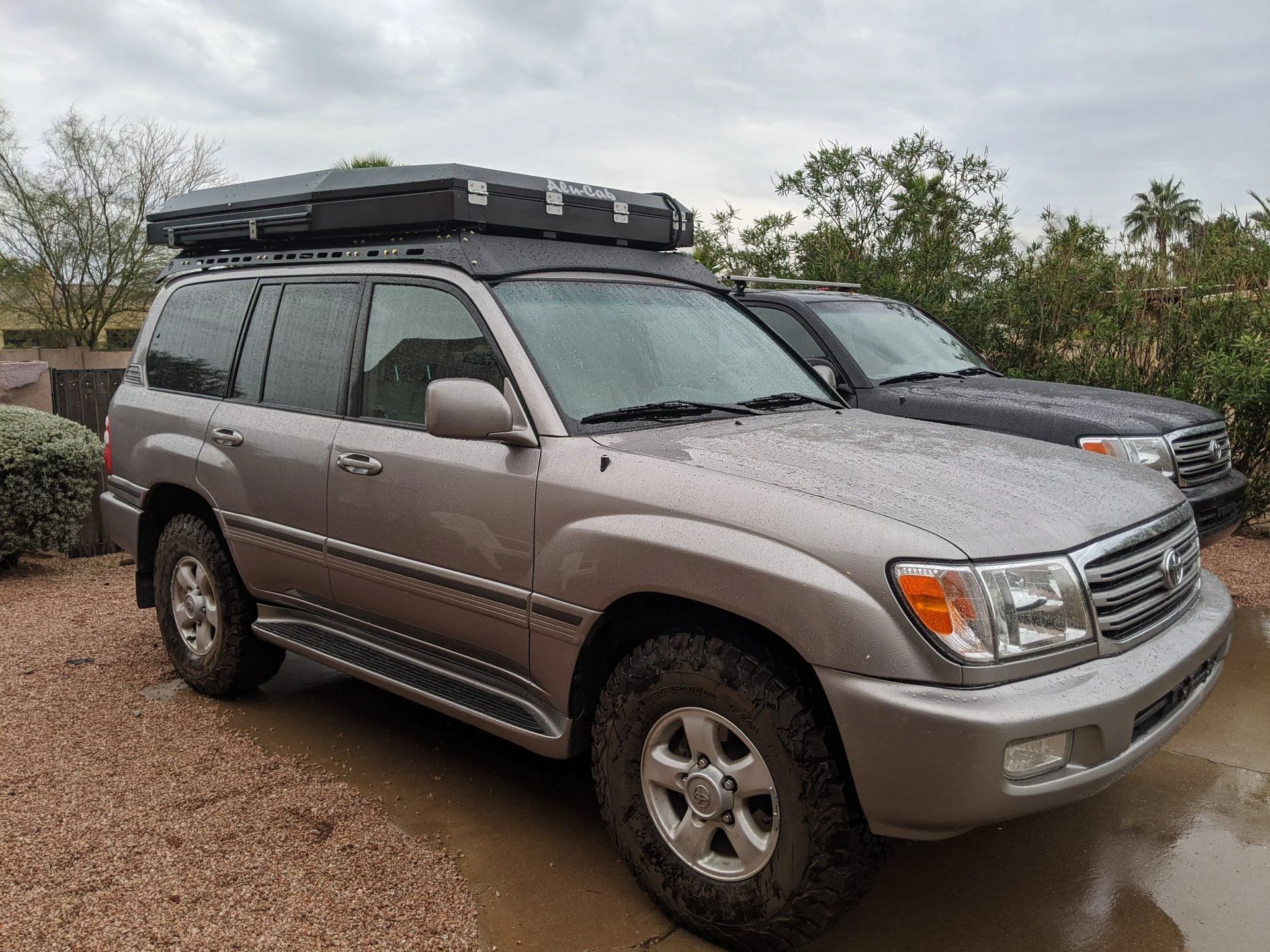

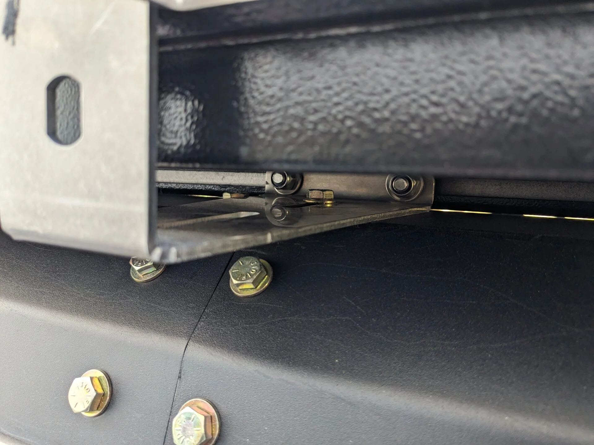

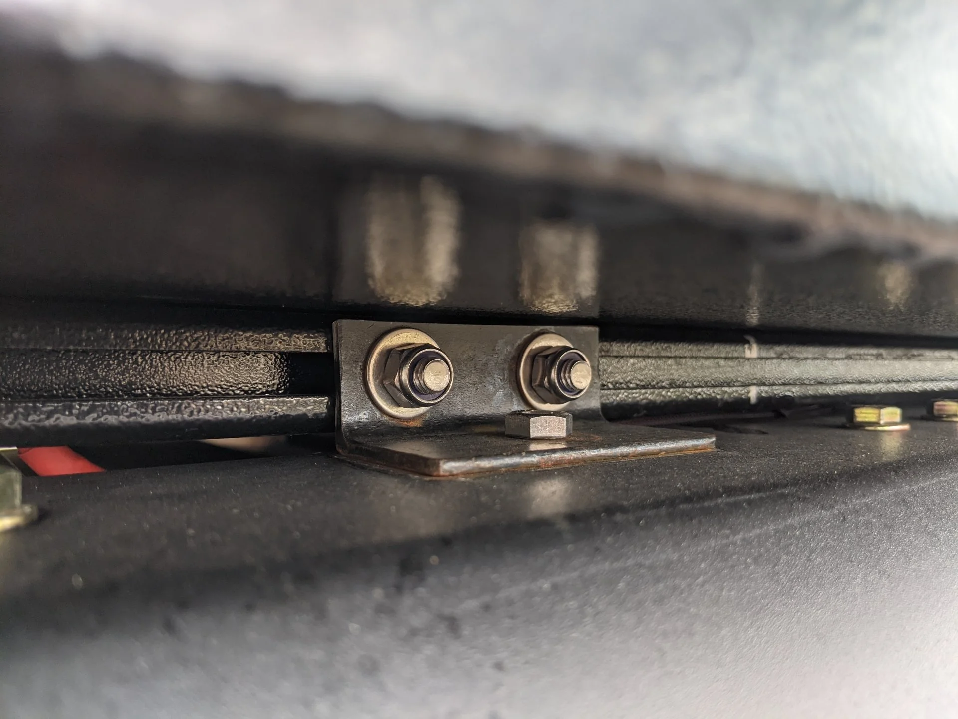

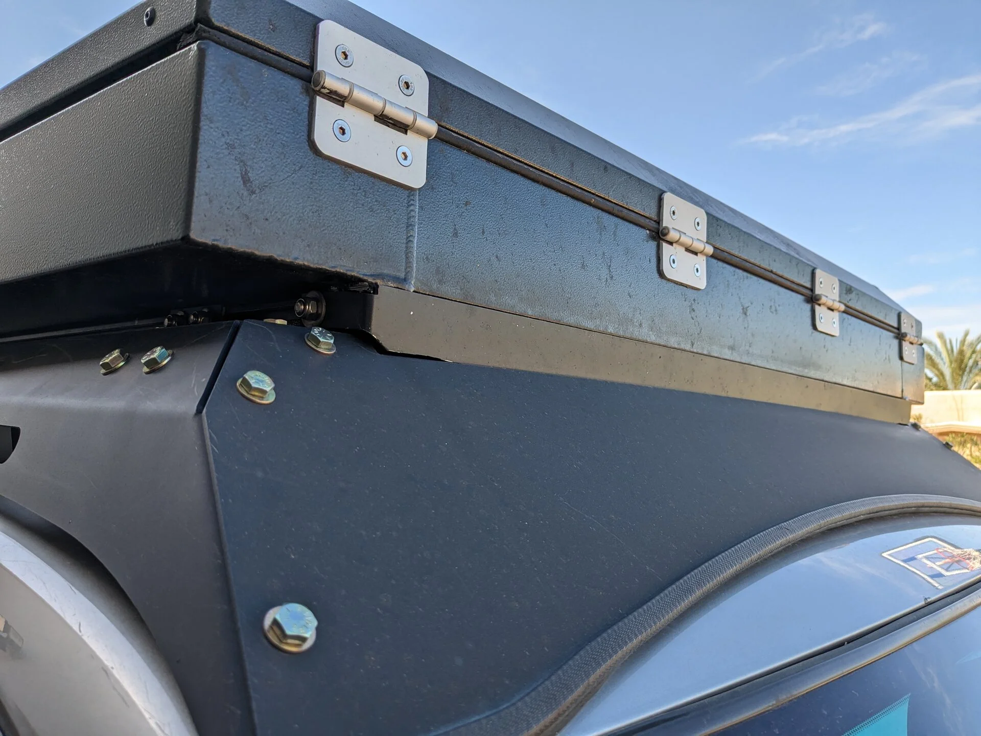

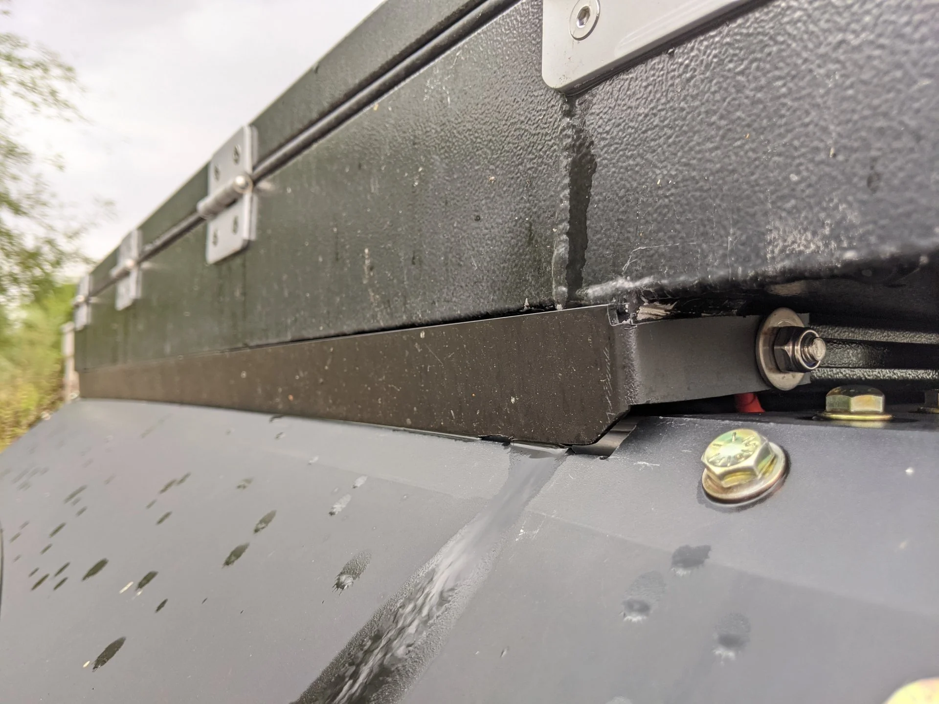

Hey man - I am receiving my dissent roof rack for my 100 series in a few weeks.
I went through the thread and am struggling to understand exactly what you ended up doing. I took am trying to avoid the added height by using the cross bars between the rack and the tent.
Thanks.
Hey man - I am receiving my dissent roof rack for my 100 series in a few weeks. What did you do to get your Alu-Cab mounted to it? Trying to avoid the Alu-Cab crossbars because of the added height it would produce.
Thanks.

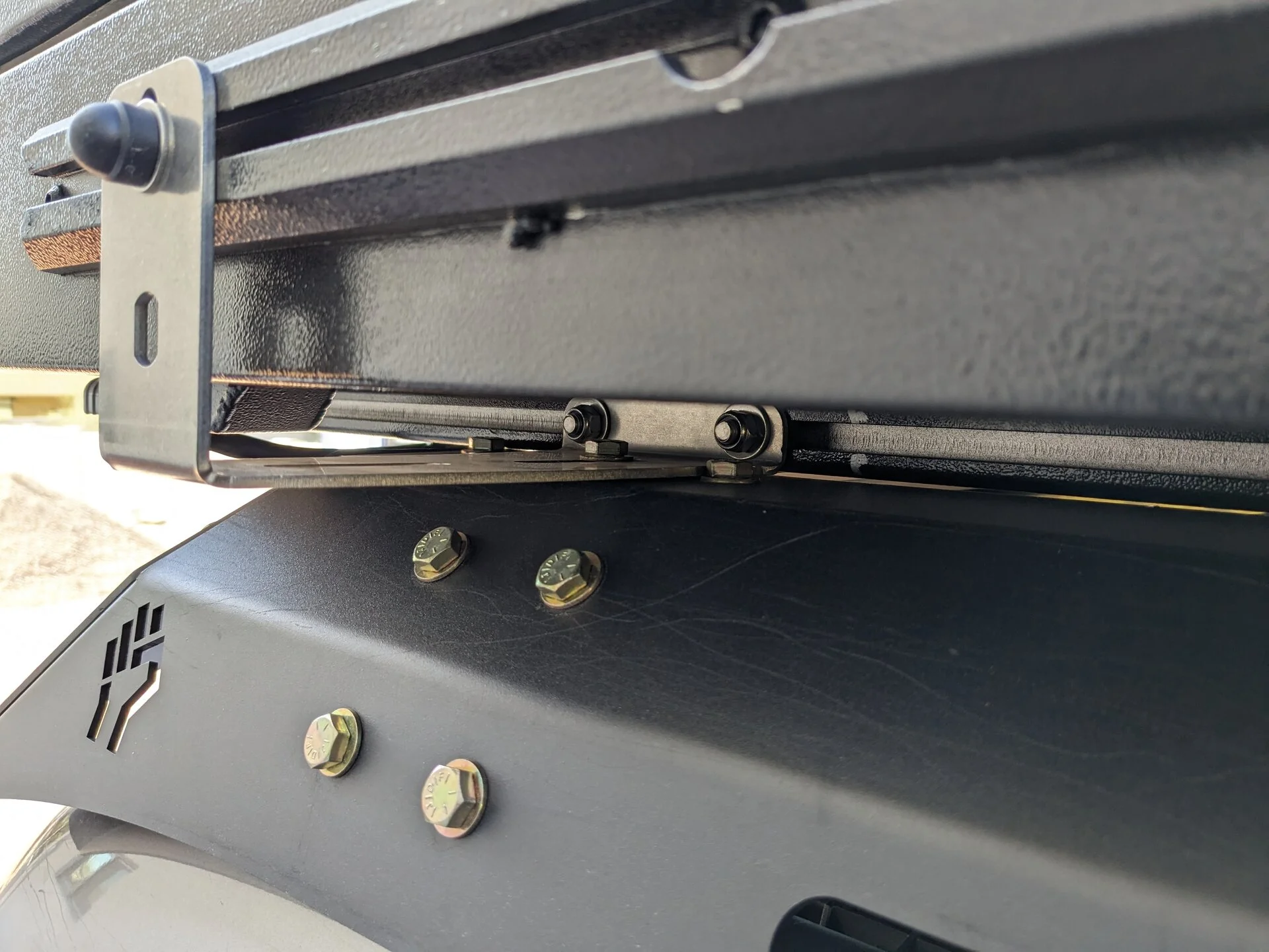

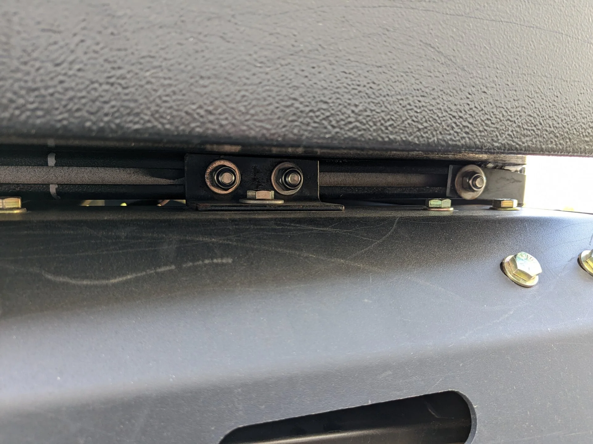

I mounted the tent using a couple of dissent roof rack bolts that lined up with the Alu-cab mounting brackets. I also fabricated some brackets for the very front above the sun roof to tie down the front of the tent. I had to drill a hole for these. The tent technically only needs two brackets, but the spacing on the 100 series roof rack mounts are pretty close together. Also, I also bent some aluminum to mount on the front and fill in the gap between the fairing and the front of the tent to reduce wind noise. It helps a lot. Here are some pics. Hope that helps.

This has proven to be super stable. I've had mine mounted like this for almost 3 years with no issues. I am going to add some rubber or something to fill in space between the bottom tent rails and the load bars. There is a small gap and I've noticed some squeaking while moving around in the tent.
