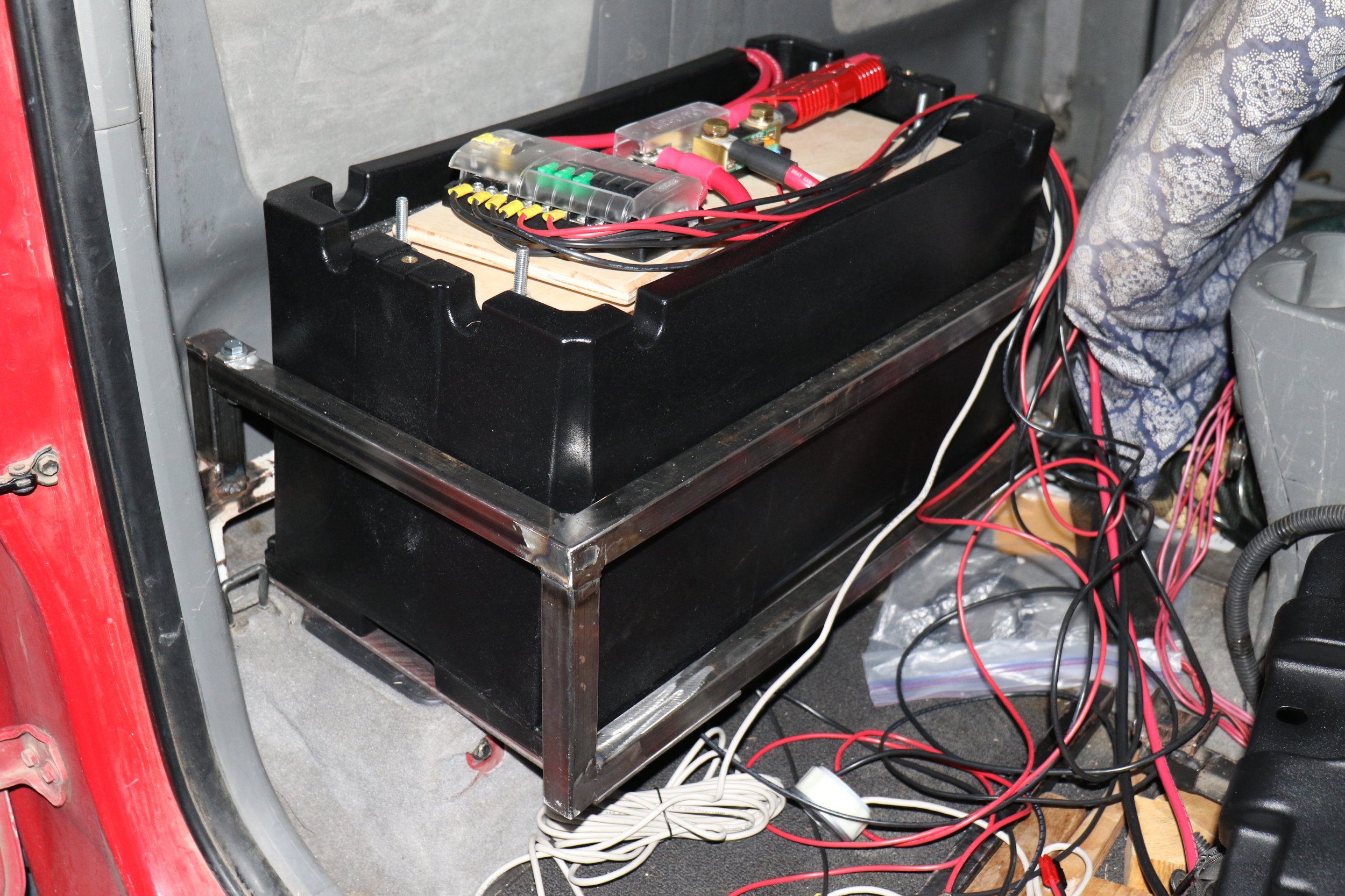

The 230 AH battery in my Taco is one half of the system I built for my travel trailer. I put a 275 Amp Anderson Power Pole on the battery so I can move it from trailer to Taco. The moveable battery has the shunt & BMV-712 attached. The trailer is a 24 v system with two 230 AH LiFePO4 batteries, Victron MultiPlus II 24/3000 inverter, Victron 70 amp 24-12 DC to DC converter, and Victron Cerbo GX communications centre.
The Taco has a Victron 30 amp solar charger and Victron 30 amp 12-12 DC-DC charger bolted onto the Engel fridge frame. I have only used the DC-DC charger once when I ran the fridge all day long on a 115 degree day at work prior to heading off for a week long camping trip so I knew the battery was topped off. The other three full charges have all used the solar panels on the trailer or Taco.
I have been so impressed with the new LiFePO4 battery setup that I am considering removing the dual battery setup in the Taco. Having three large batteries in the Taco seems like overkill, and right now the only benefit the dual battery setup has is when winching, and I seldom winch. If my Taco primary battery goes dead I can always re-wire the Victron DC-DC charger to charge it from the LiFePO4 battery.
