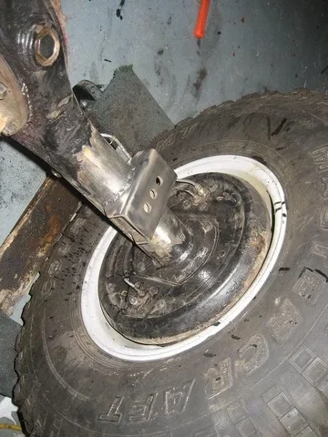

My pinion seal in the front dif had a pretty bad leak. I tried a speedy sleeve but no use. Being that I cant set up gears and I really wanted an air locker I gave justdifferentials another call and a week or so later the big brown truck had it for me. I mounted the compressor upside down but from reading the directions it didnt seem like it mattered. Does it? Also it has a different shape (less ribs) than the third I took out but it bolted in fine. Is it from a different year? I still need to wire it up but the harness kurt at cruiser outfitters sent me looks pretty easy. The last pic isnt a cruiser but my other toy I just picked up soon to be on a trailer behind my 40:)
