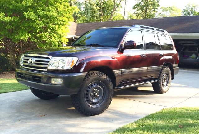

Swapping the factory '06 18" alloys, for 2007 Tundra 18", 5-lug steelies.

Swapped the wheels today - and got new tires. Same size, e.g. 275/70/18 - BFG KO2. As highonpottery predicted, the OE lugs for the alloys work. But, I'm thinking I may want to swap them for a better fitting lug. Might go black... not sure.

Yeah, they do work... and the do look goofy. Plus, that washer is loose. They've got to gof. I found a set (look just like the ones hoser posted - thanks!) from Gorilla - and they're black.
