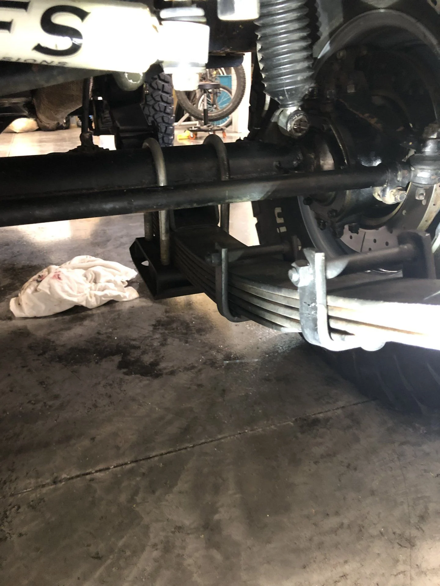

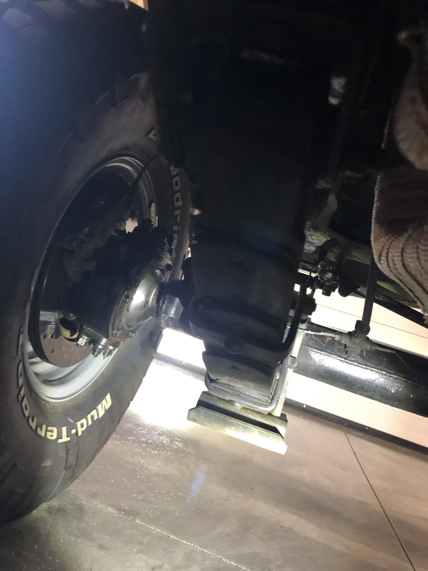

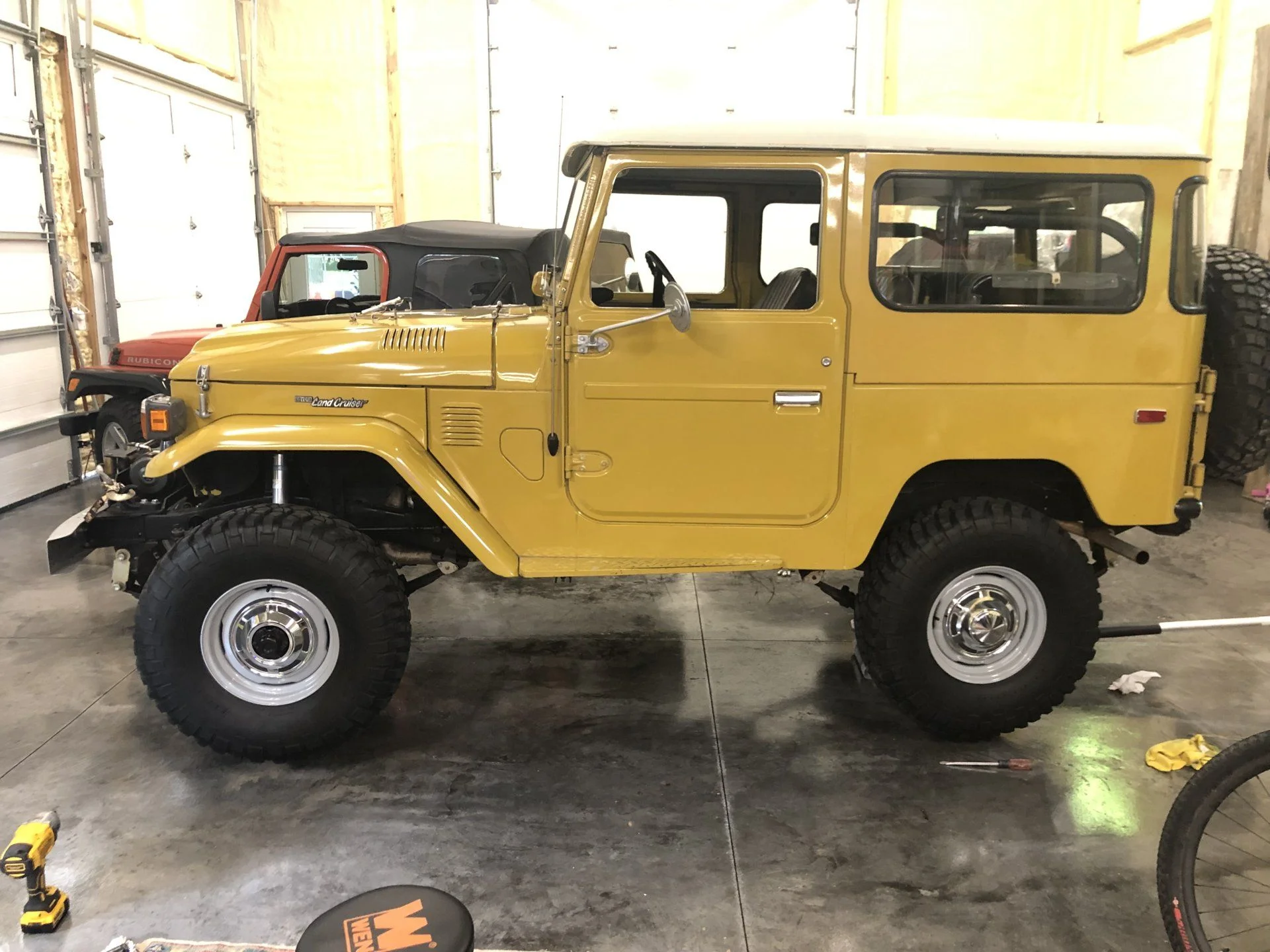

Hello everyone, looking for an alignment shop in the metro Detroit area or will travel to the right shop for quality work. Has an HFS lift, 4”, new TRE, bilsteins but is a bit scary to drive. 33” on steelies, tires 9 years old lots of tread

I don't know of a shop but 4" of lift might have you in need of caster shims. If your front axle has rotated too far forward it will put caster near zero and feel very sketchy when driving. The shims are wedges in the degree you choose and rotate it back to where your front wheels will seek center when you let go of the wheel. There should be some threads about it in the 40 series forum.
The only other adjustment you can do is toe in (which is somewhere around 1/8" I think). Any alignment shop can do this but it will also help with stability.
One other quick thing- if you are getting vibration out of the rear, the rear axle may need the shims too to make the output flange of the t-case parallel (or close) to the flange of the rear axle.
Try the phone app "clinometer+bubble" to make your phone a super tool for finding degrees on your parts.
Good luck!

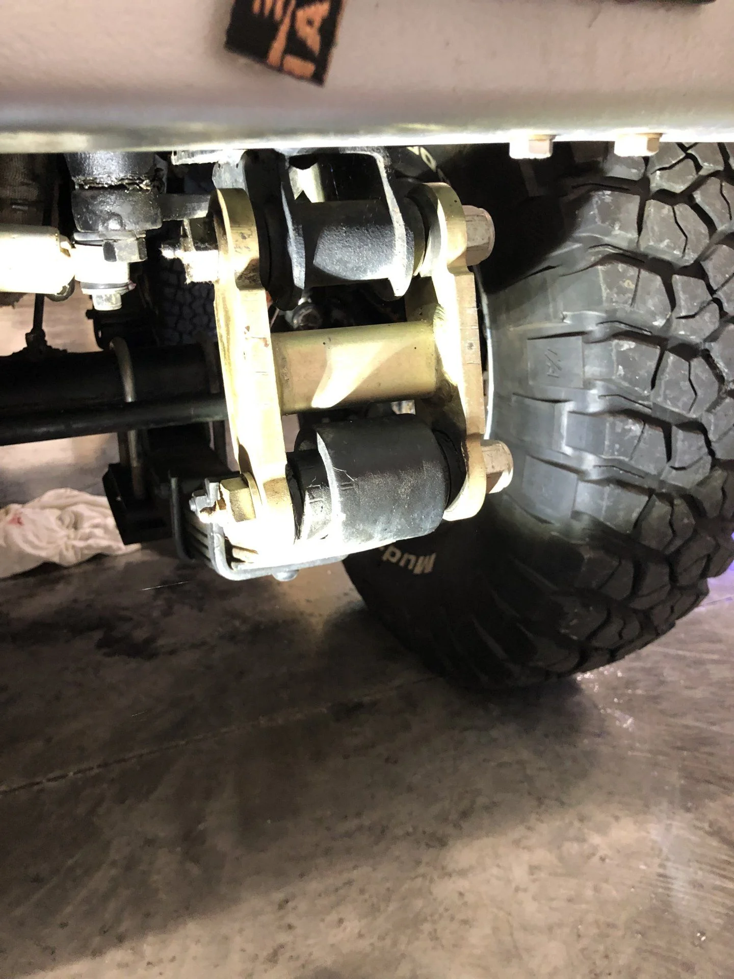

Thanks for the info. My understanding is that if you have a reverse shackle you may not need the Shim’s? I am getting vibration in the rear.

A reverse shackle could help but it still depends on how much and which way the axle housing gets rotated.

I think I just bought some Pro Comp 4° shims from summit or jegs. Cool Cruisers and Cruiser Corps sell them too. The shims were super easy but the crappy part was that the alignment pin in the spring stack was too short. I fabbed a couple up because I was at my shop and the torn apart 40 was my only way home! I think the above shops sell longer pins too and it becomes an easy job. Just check degrees wit the phone app to see what shim size you need to get the rear flanges parallel. The front I am not sure on. A post in the 40 section would probably get answers pretty quick

Did some searching getting some ideas. Trying to understand how to figure out my current caster so I know what Shim’s I need.
Here is a few pics for comparison to yours
Do you know the condition of the steering center arm? That adds a lot of extra pivots and joints to the system.
Thx got it out of CA mostly original paint
