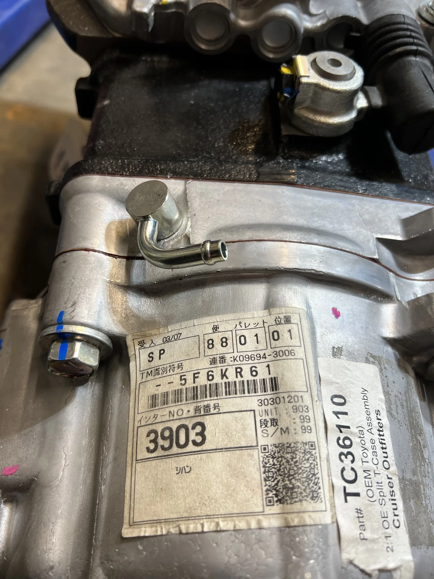

Using grease didn’t work
More bread. I used a marble rye, very delicious, Impressive how much can fit in there. Put a socket on an extension backwards and pushed as much in until it you could use a dowel. I just couldn’t find a proper fit.

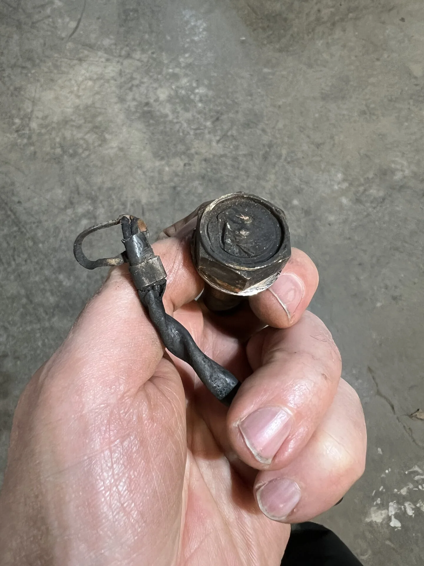

Ben had an issue with his a while back, not sure if he fixed or replaced, but the discussion starts here:
And this came up too:

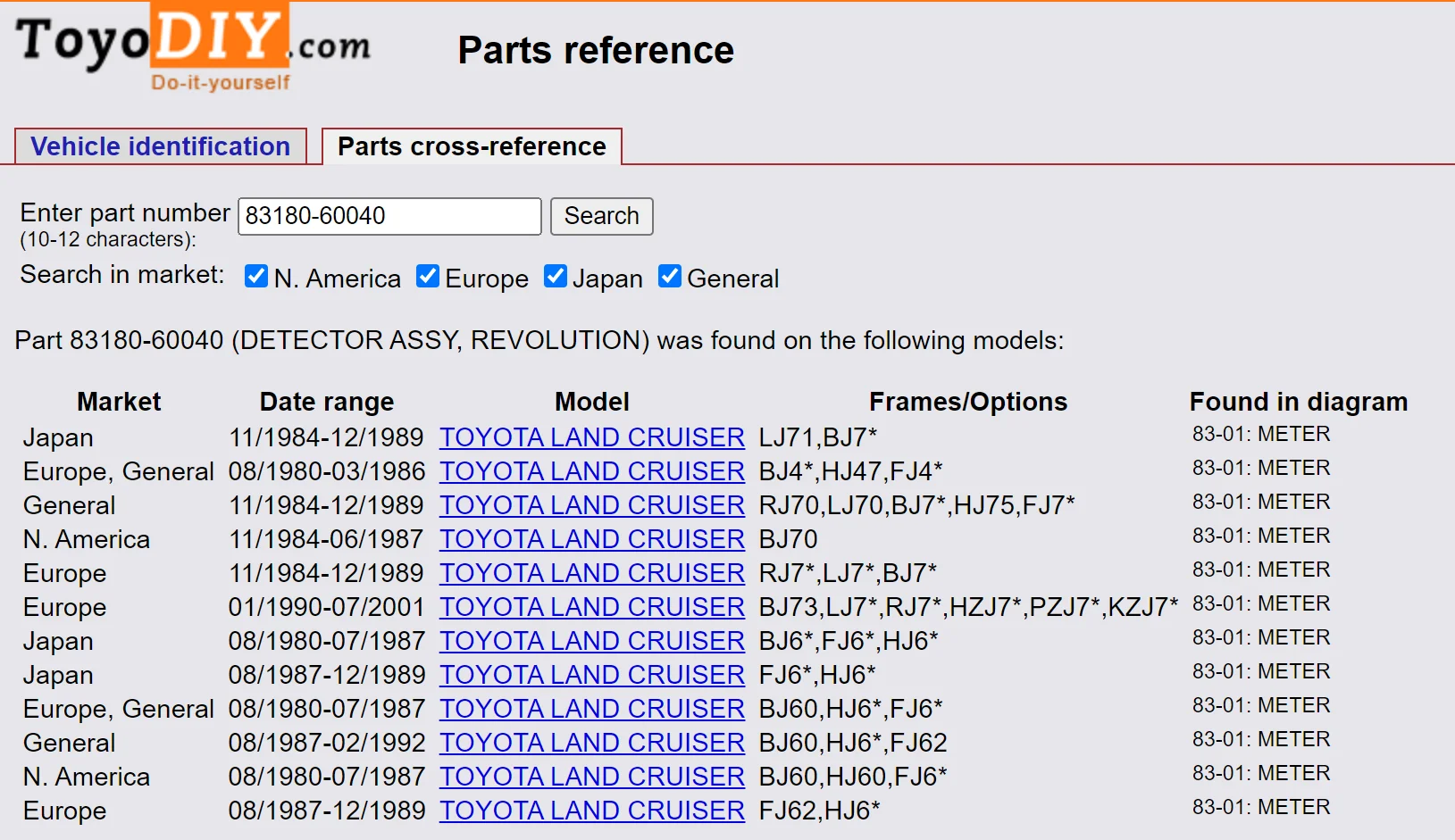

Looks like it is 83180-60040 Detector Assembly, Revolution.
Mine broke as well. I was able to cobble it together with some epoxy. No idea how long it will last but for now it’s working.
I've seen replies that say you can dig into the top with a soldering iron enough to get enough wire to solder the wires together again. Then fill with silicone or something stronger to stabilize that area.
That’s what I did. It’s not pretty but it works.
I had to use a razor and pick to clear it out.
Would be worth it to have a spare.
