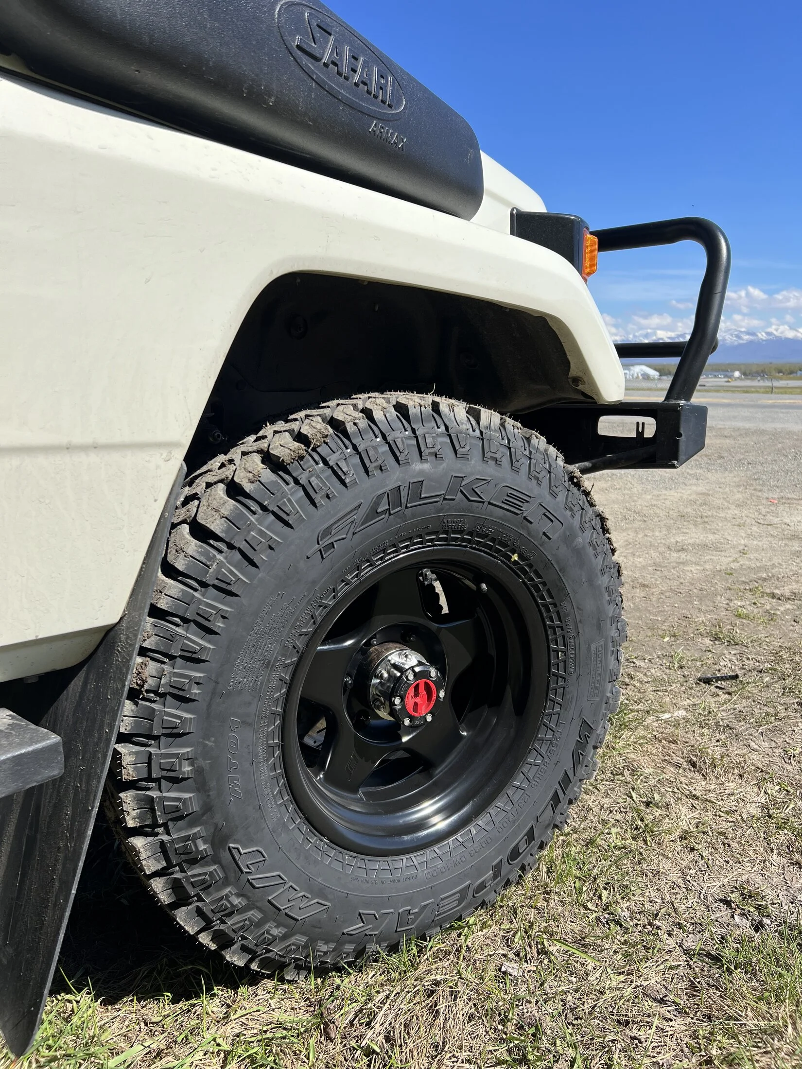

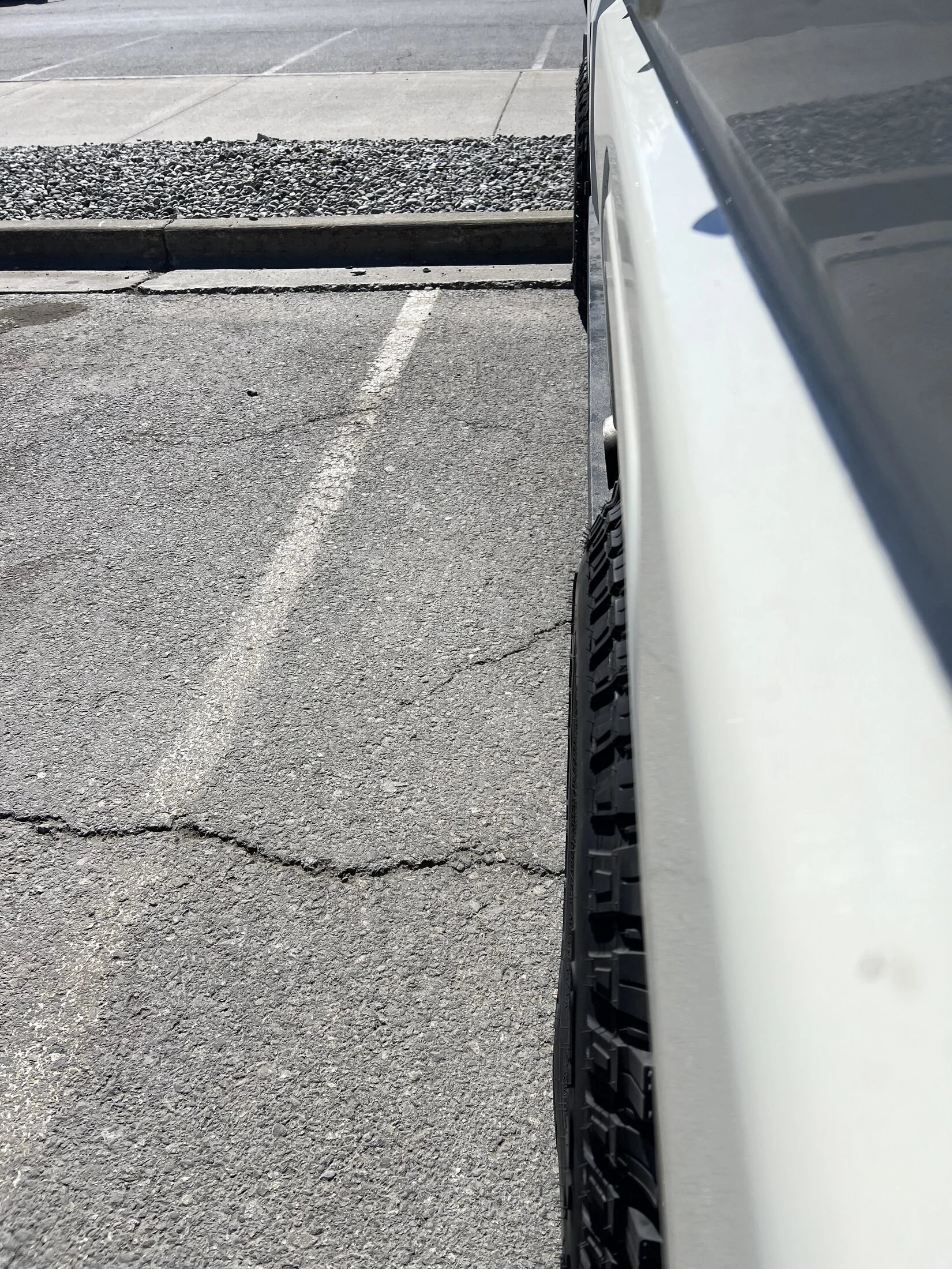

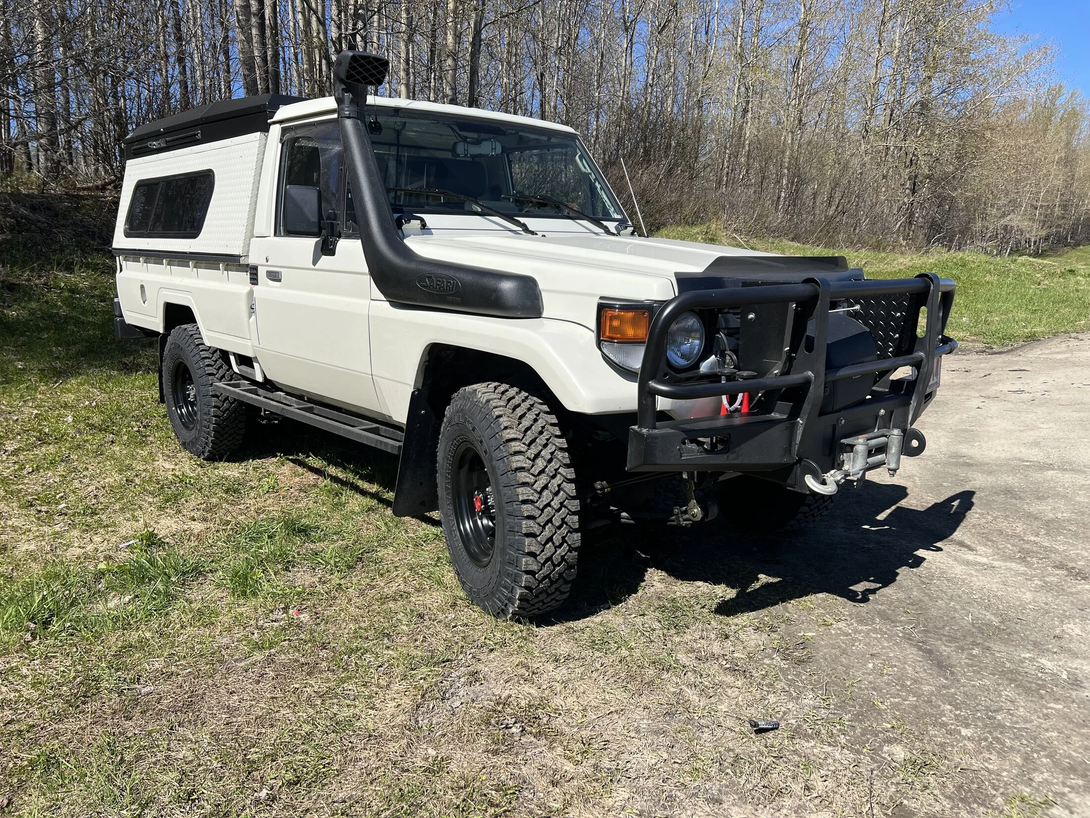

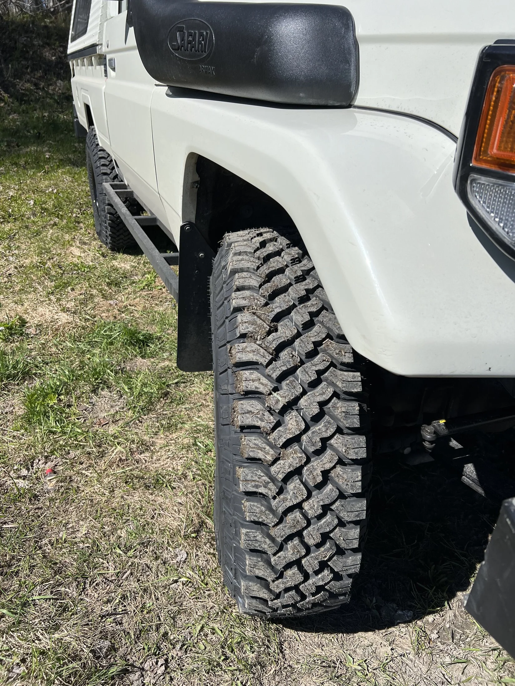

Got some used SCS F5 wheels 16x8 3.5BS. Also went with the Falken Wildpeak MT in a 255/85/16. Might needs some fender flares.
Not with 255s. Maybe with 285/75/16. Flares look good with 305/70/16.
I have the same tire size.
There is always crud splashed on the body but mud does not come in the windows like when I had 285's.
For me, that's a win.

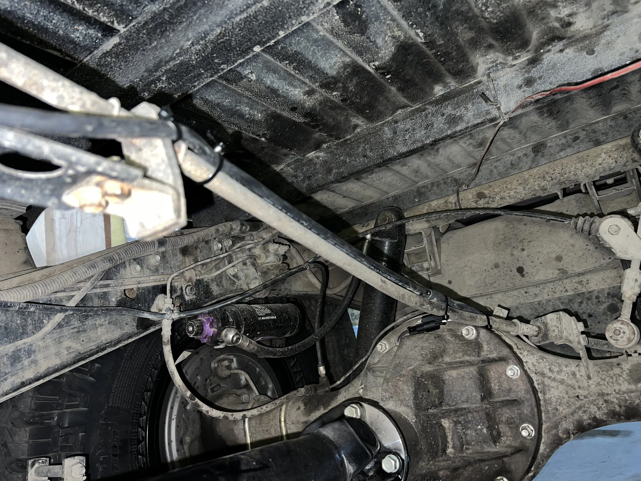

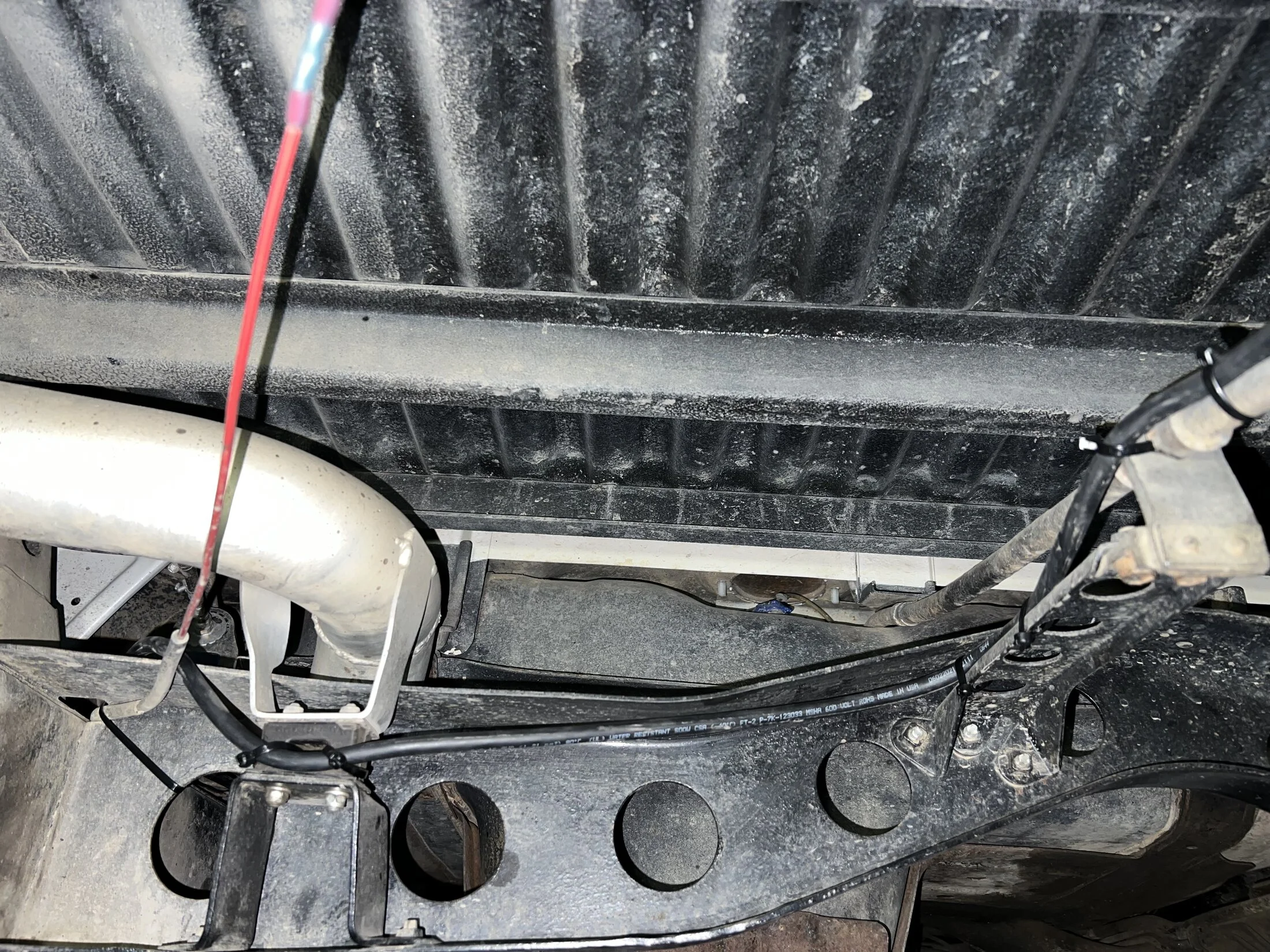

Finally wired up the E-lockers. I used a sPod. And using the Bluetooth function with the app I don’t need to use/mount the head unit in the cab.
I think the wiring loom routing will work.
Rear
Front
