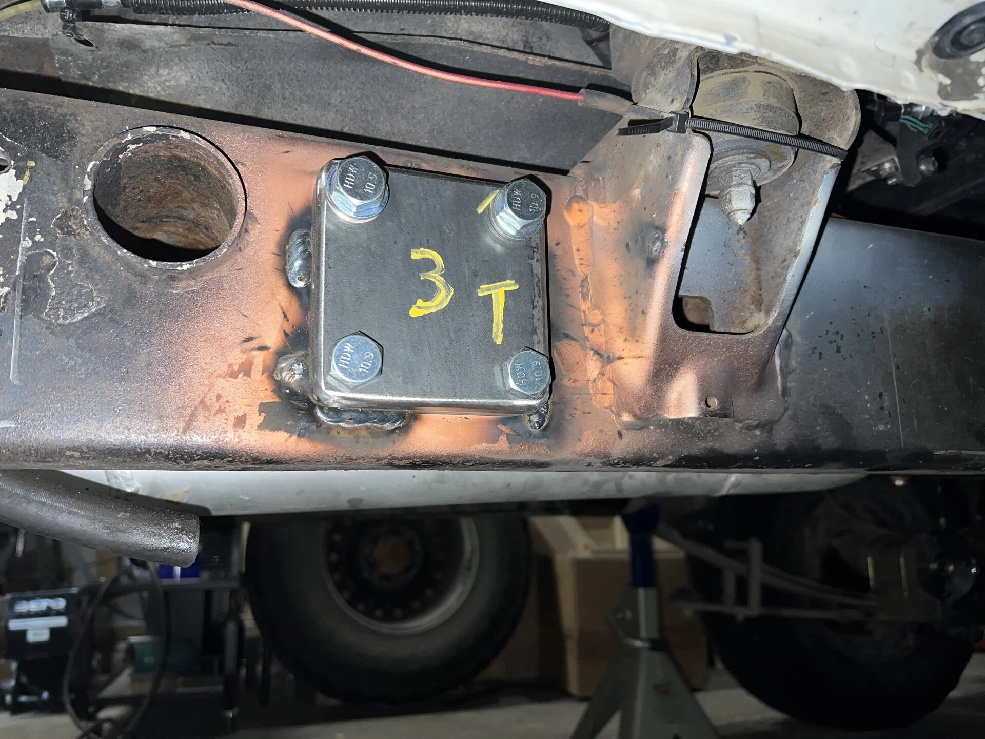

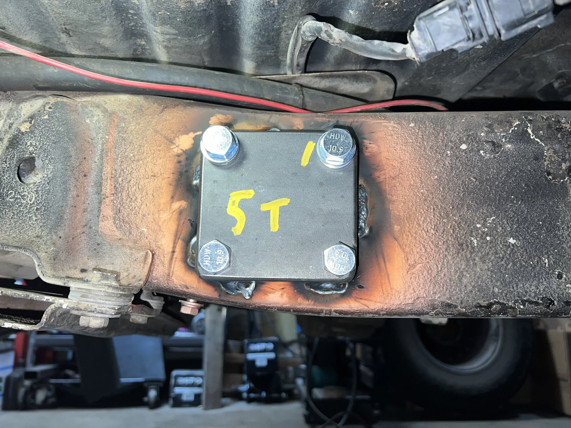

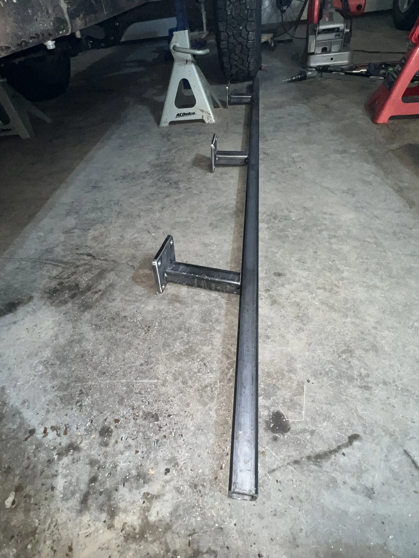

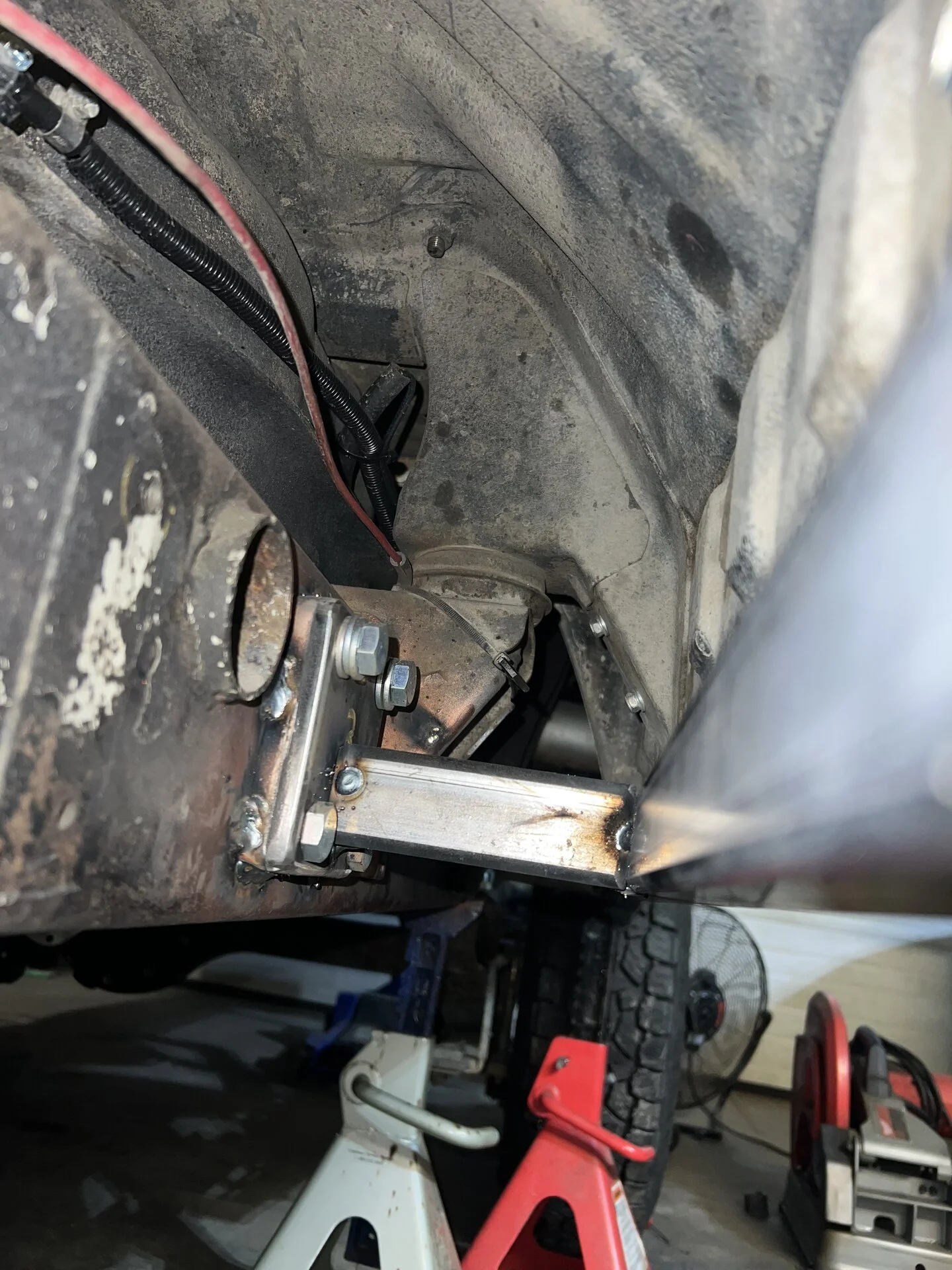

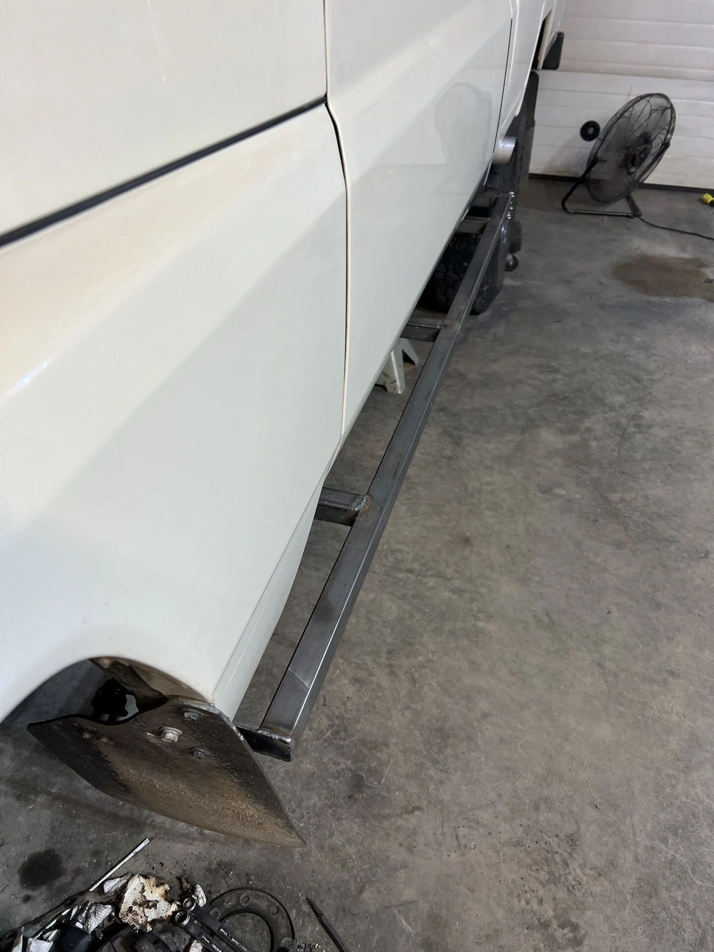

That is a LOT of drilling... I think if I were to ever do the same, I would be hitting up my machinist friend and make use of his machine shop and industrial drill press. All I have is my cordless drill which would take me all day to do that many.

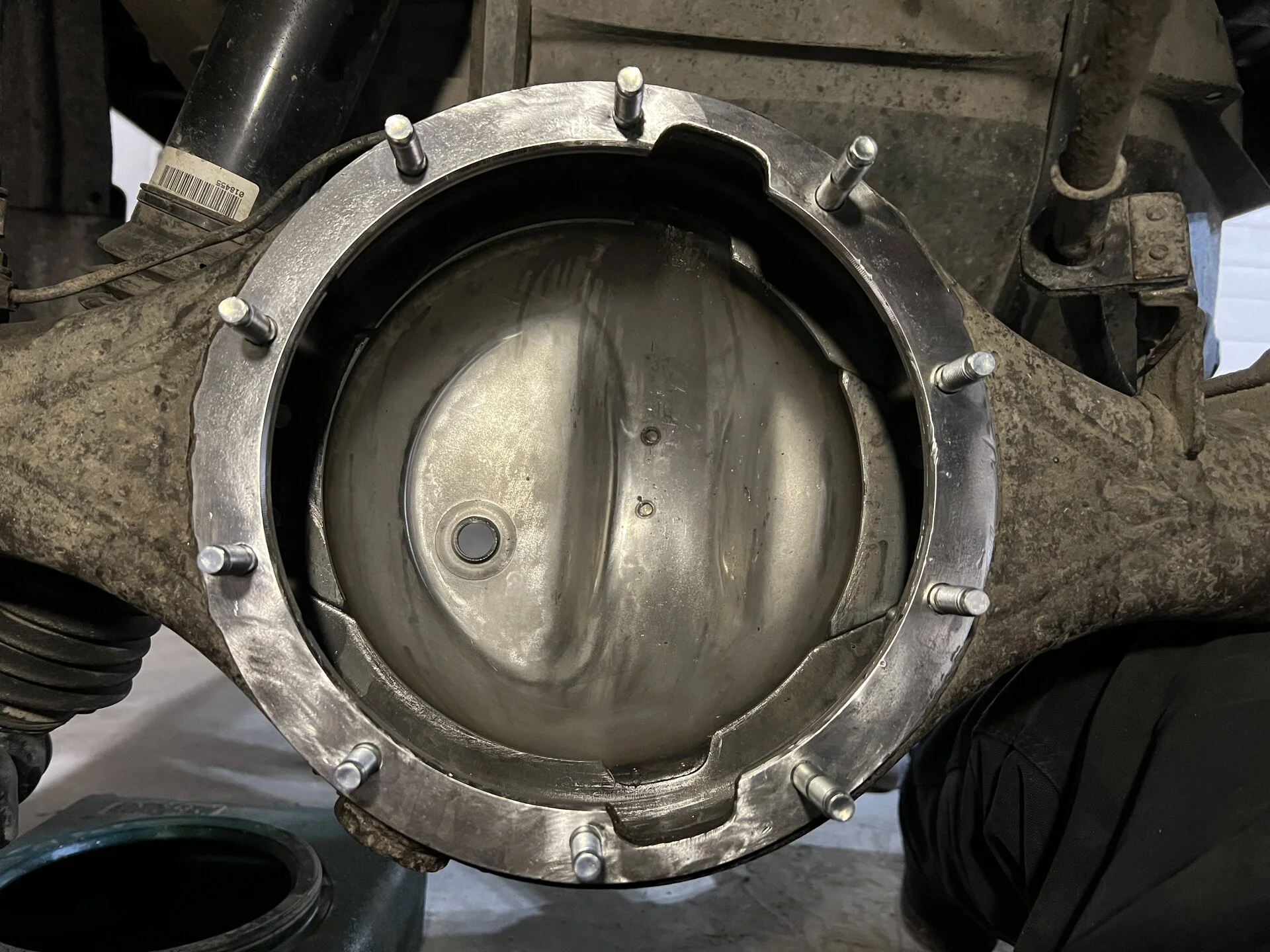

I used a drill press to drill the proper size holes for the tap. I still had to tap by hand and slightly oversize the holes on removing mounts to fit the proper size bolts. 12x1.75

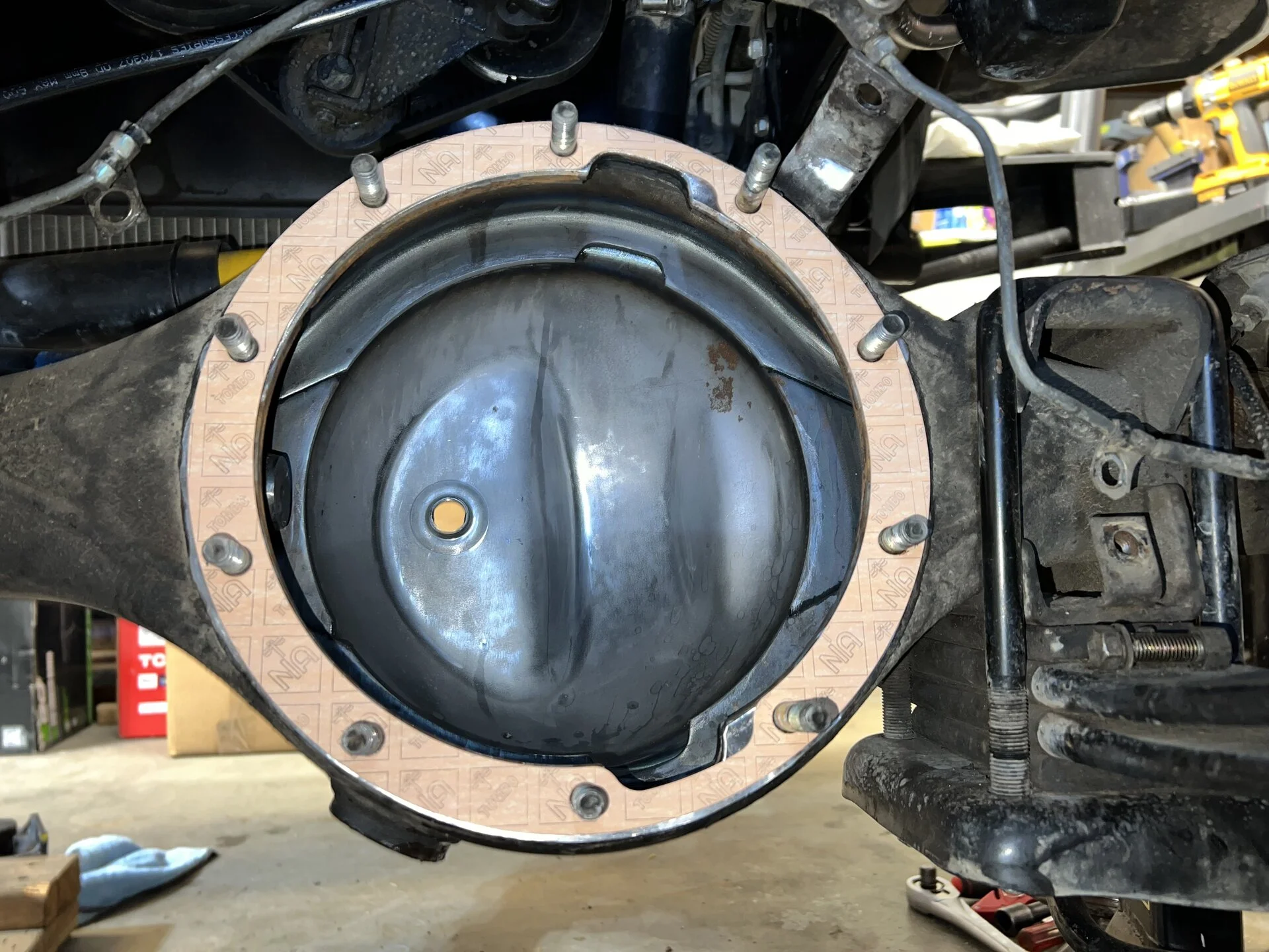

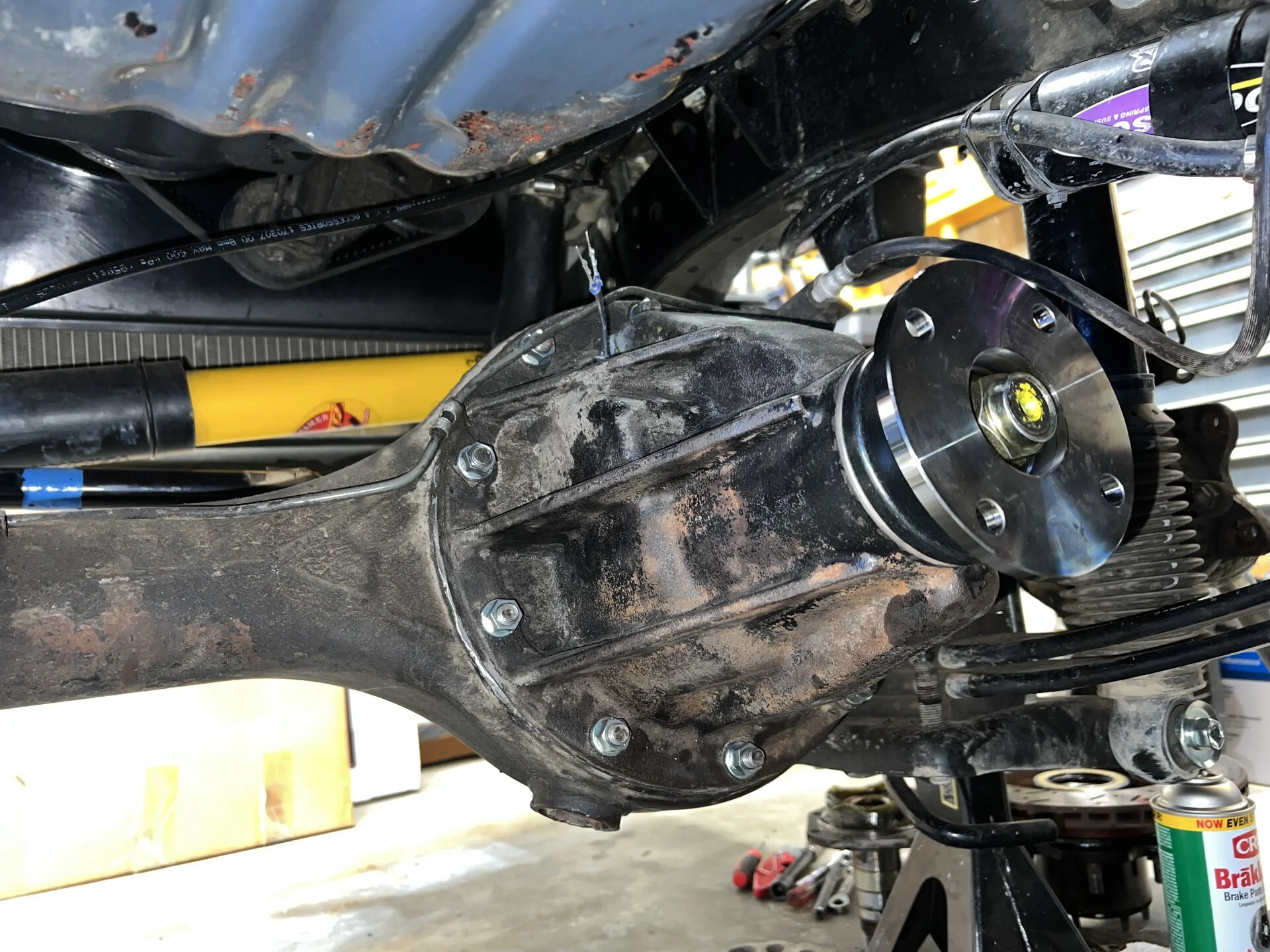

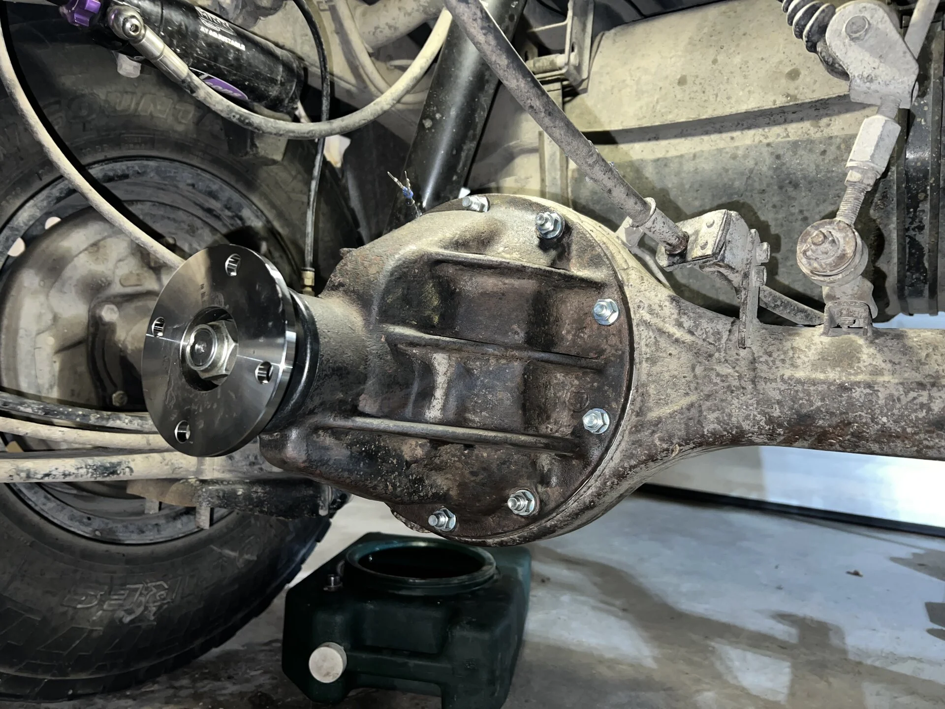

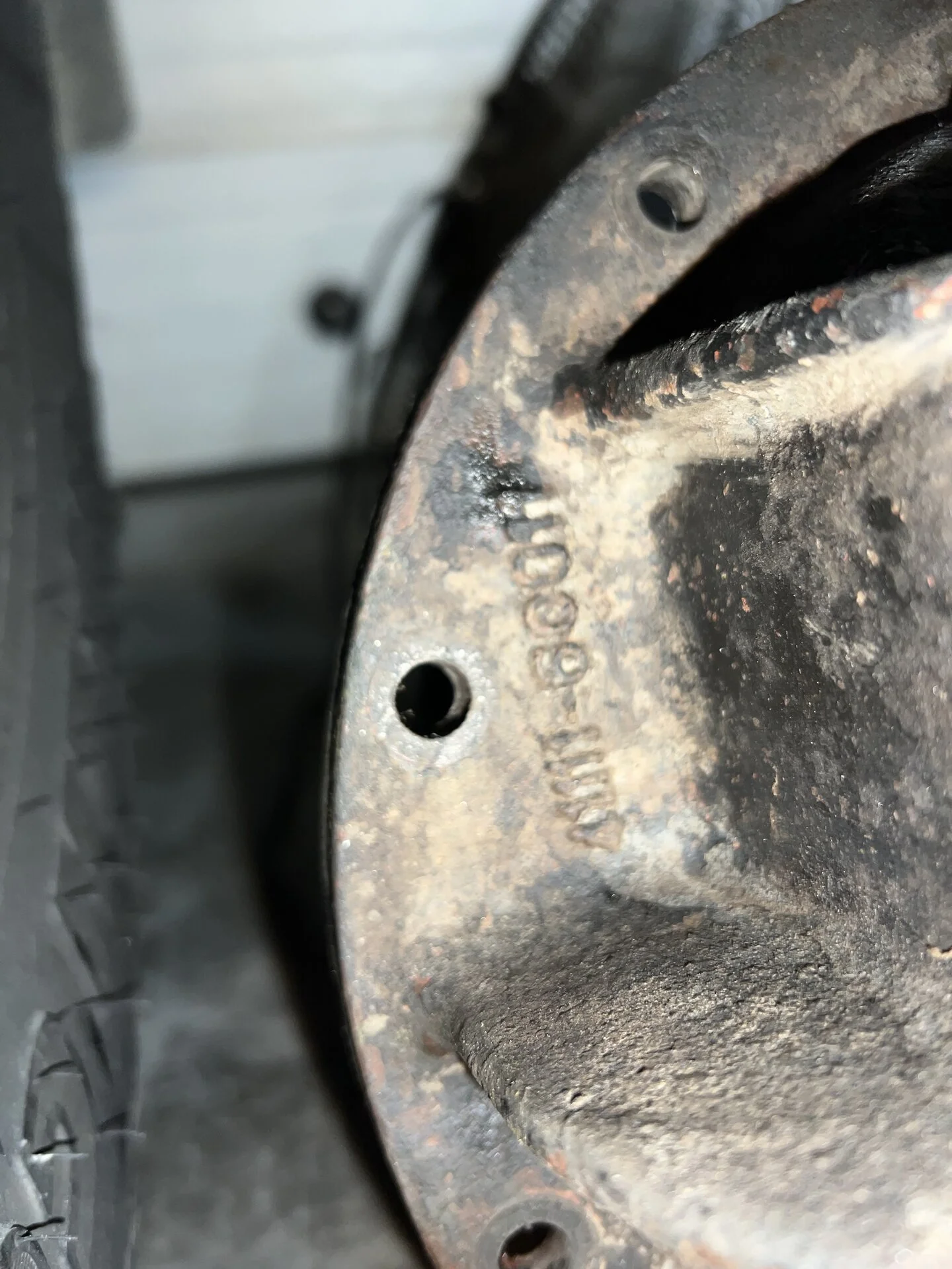

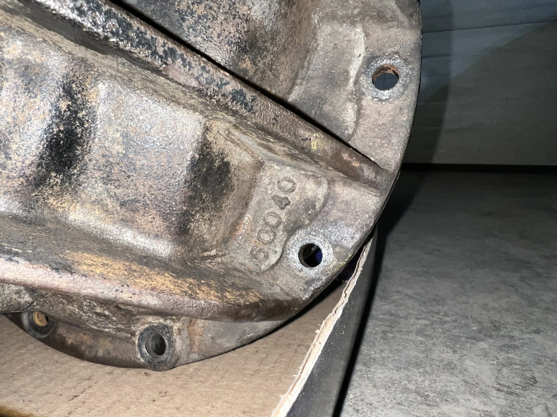

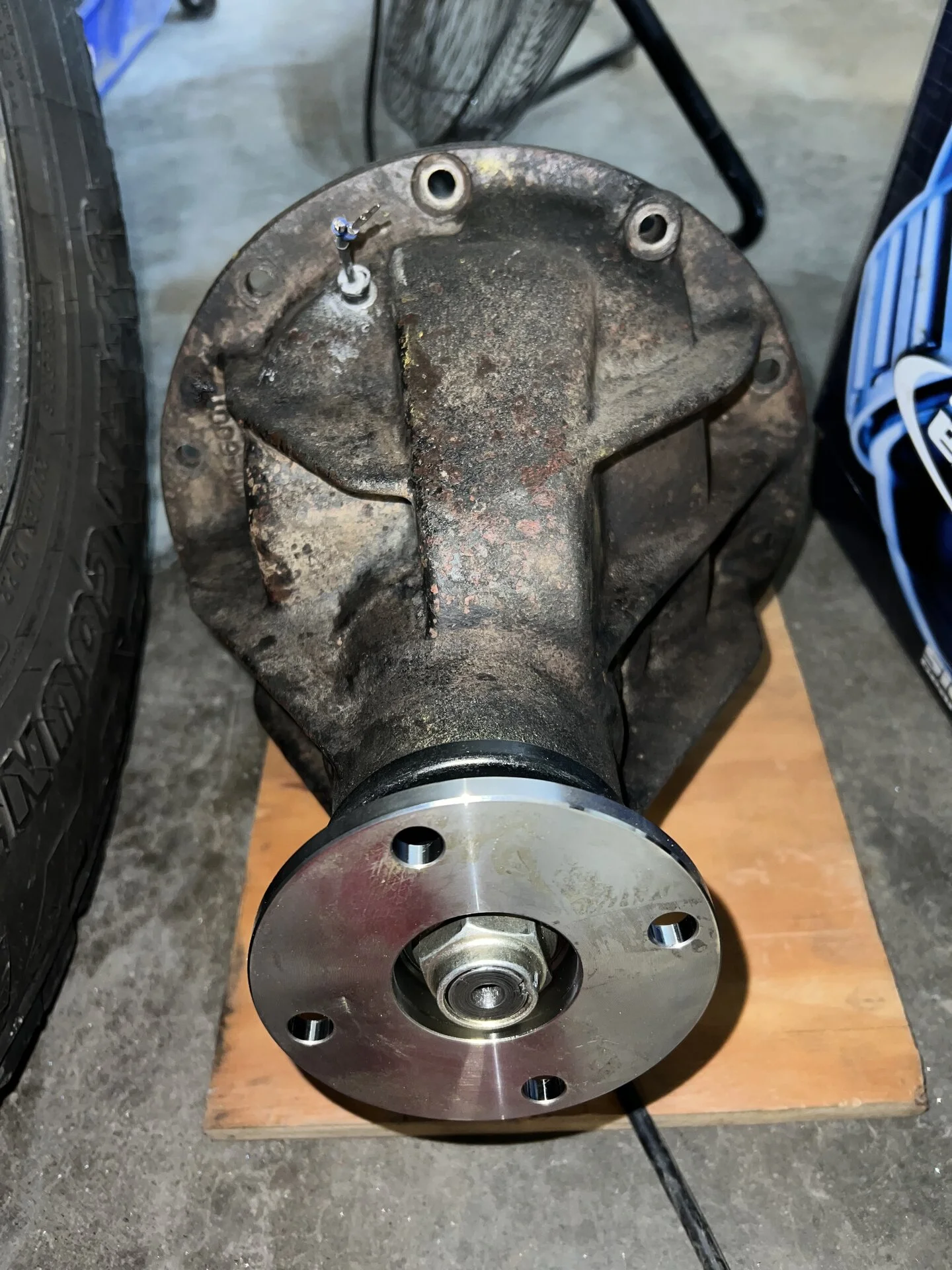

Different housings front and rear.
Front
Rear
Looks like the front has larger ribbing

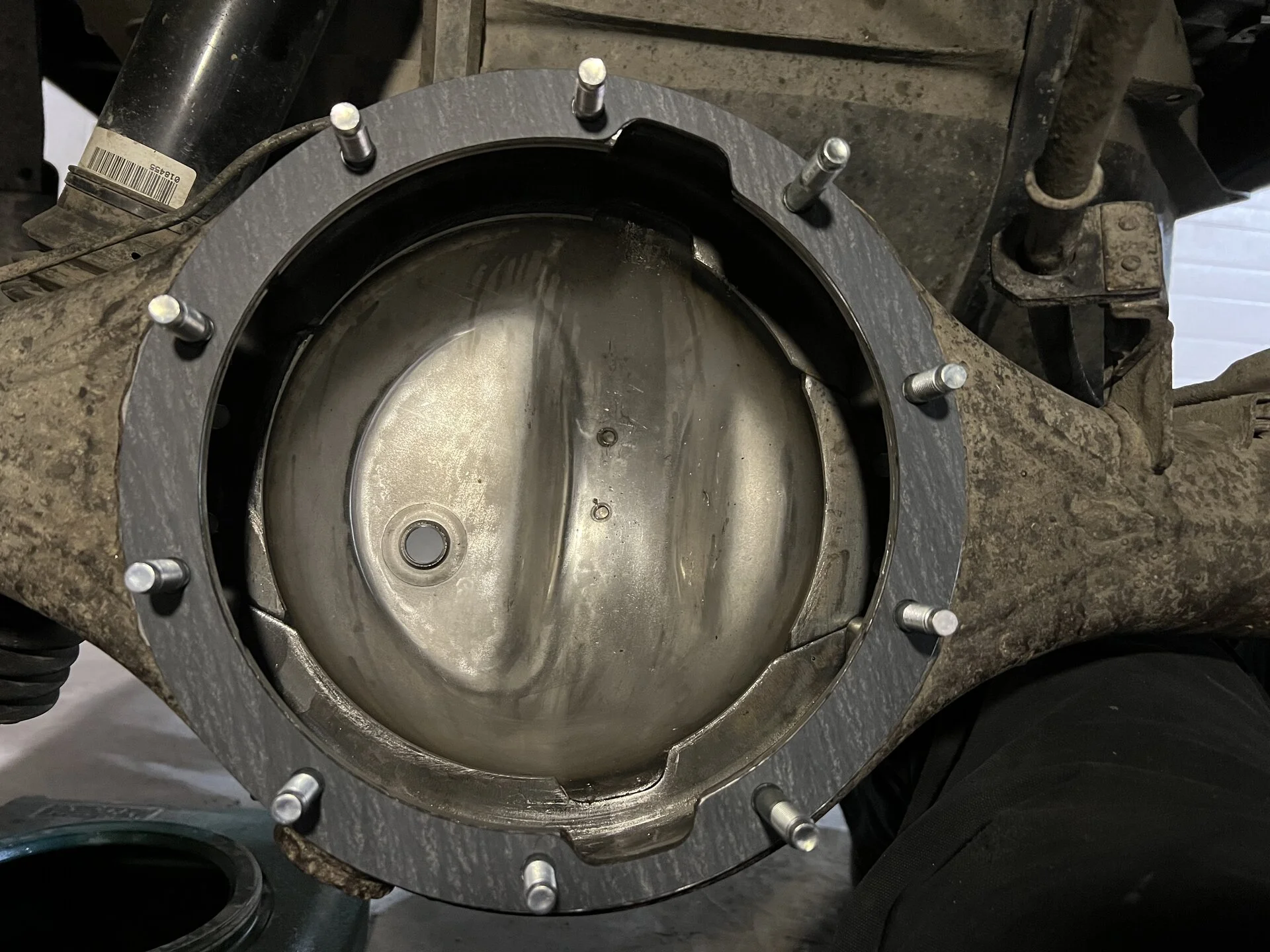

Pulled the rear diff off again and noticed that about 96% of the gasket was still attached on the diff. It looked like part of the mounting surface so didn’t look very closely before installing 🙄. Fortunately I had another gasket here and after cleaning off the old gasket and installing the diff and filling back up so far no leaks👍

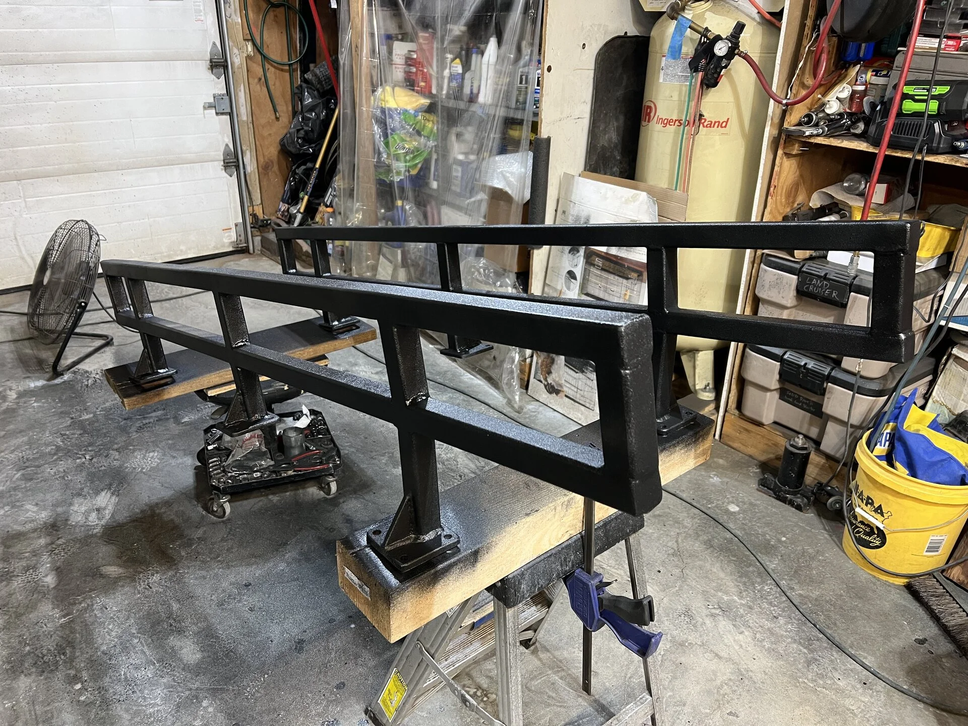

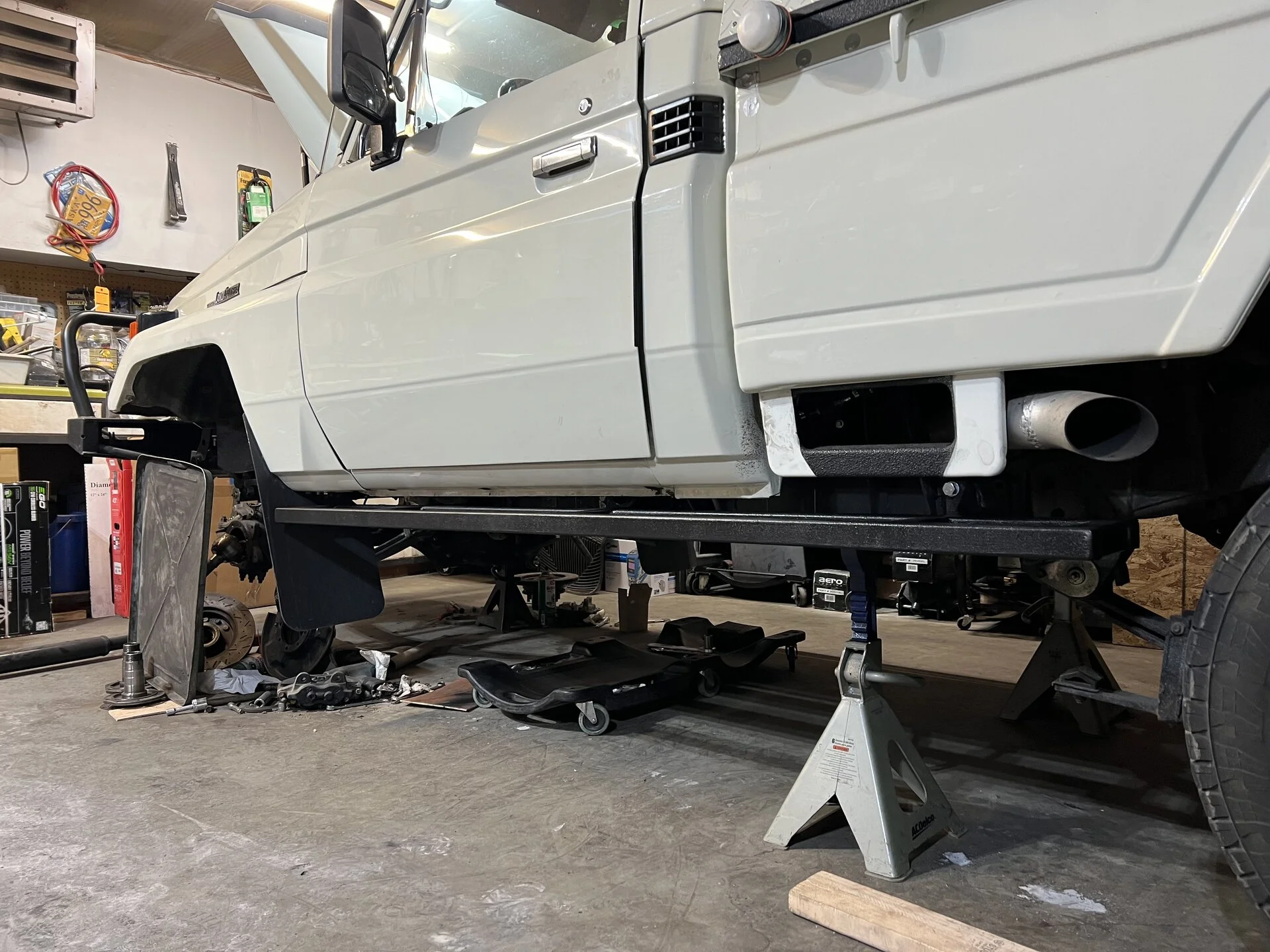

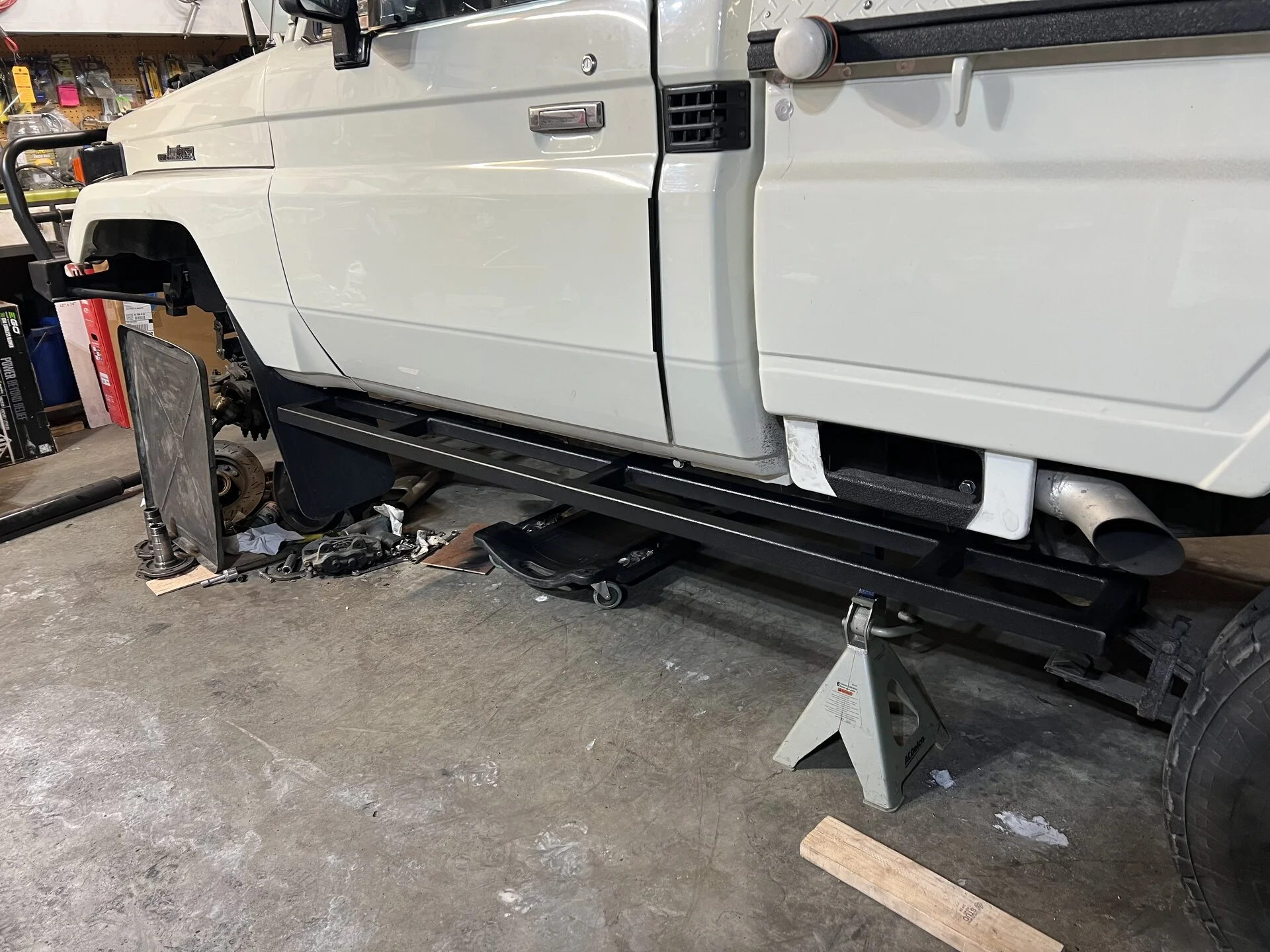

Please come here and organize all the crap in my shop.

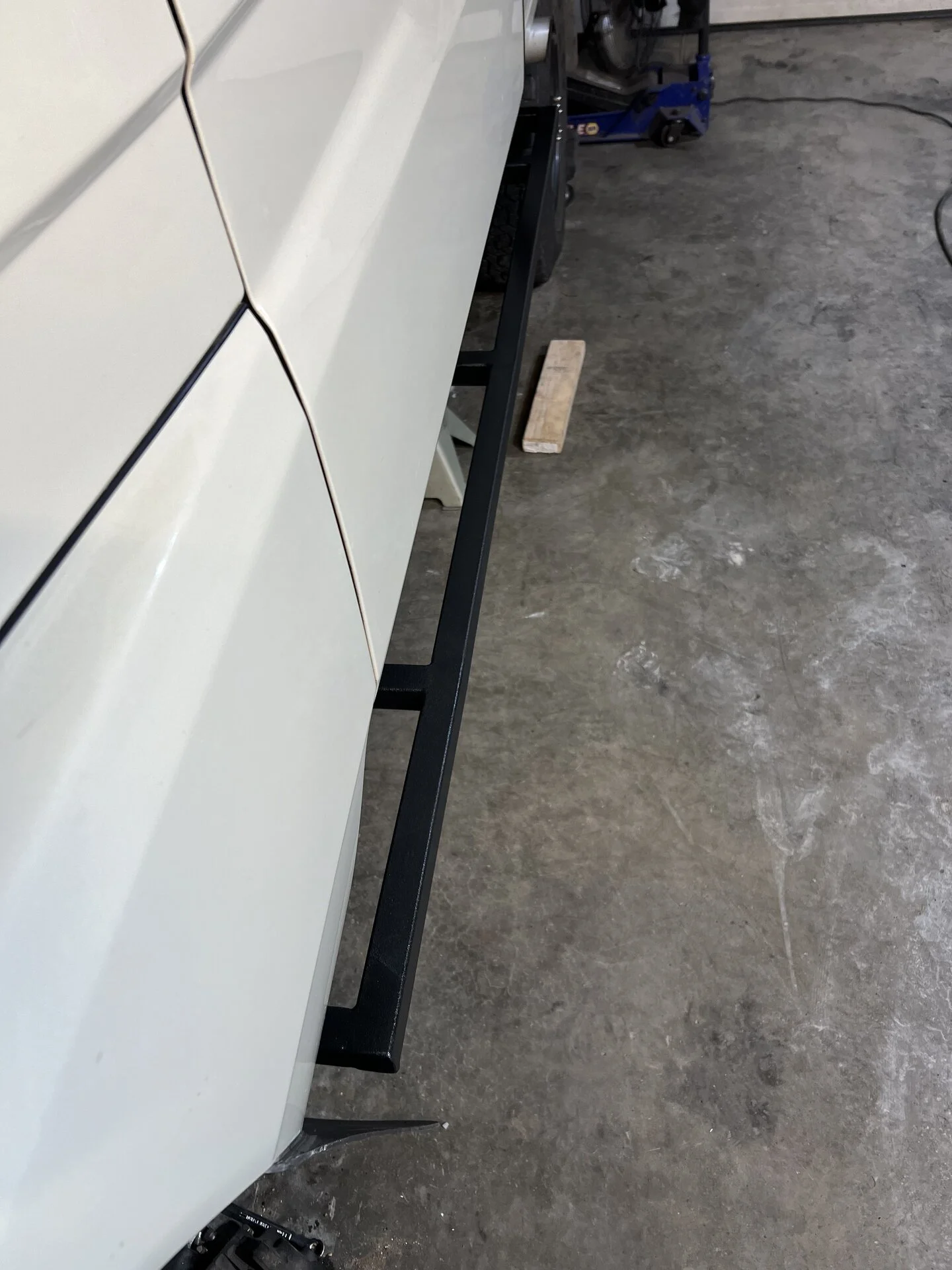

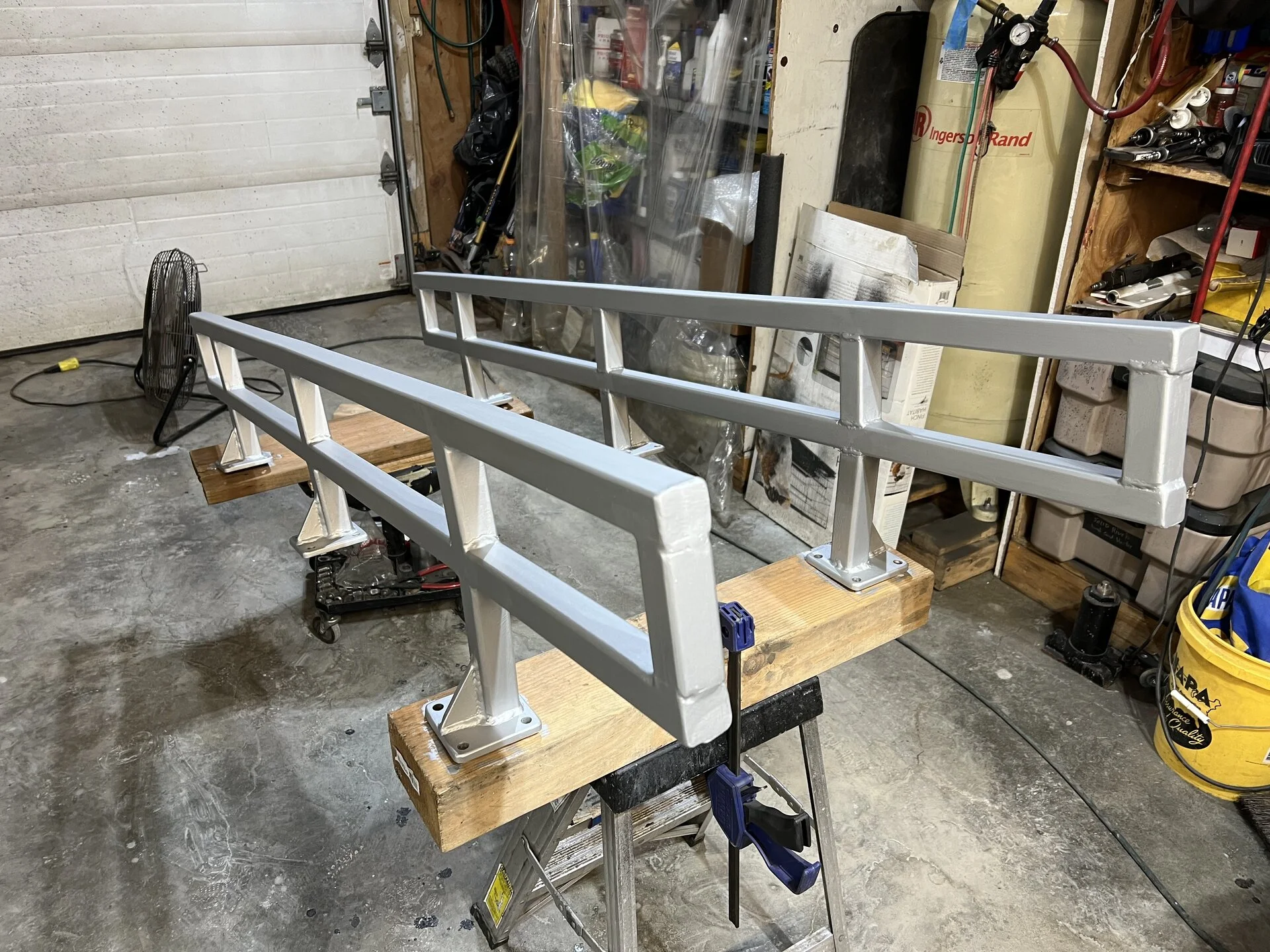

What paint did you use?
I try not to show too much of the garage 🤣 mastercoat for base and raptor liner in the can for top coat. Will see how it holds up
