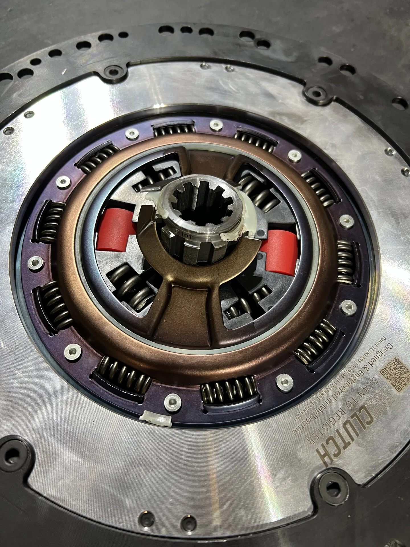

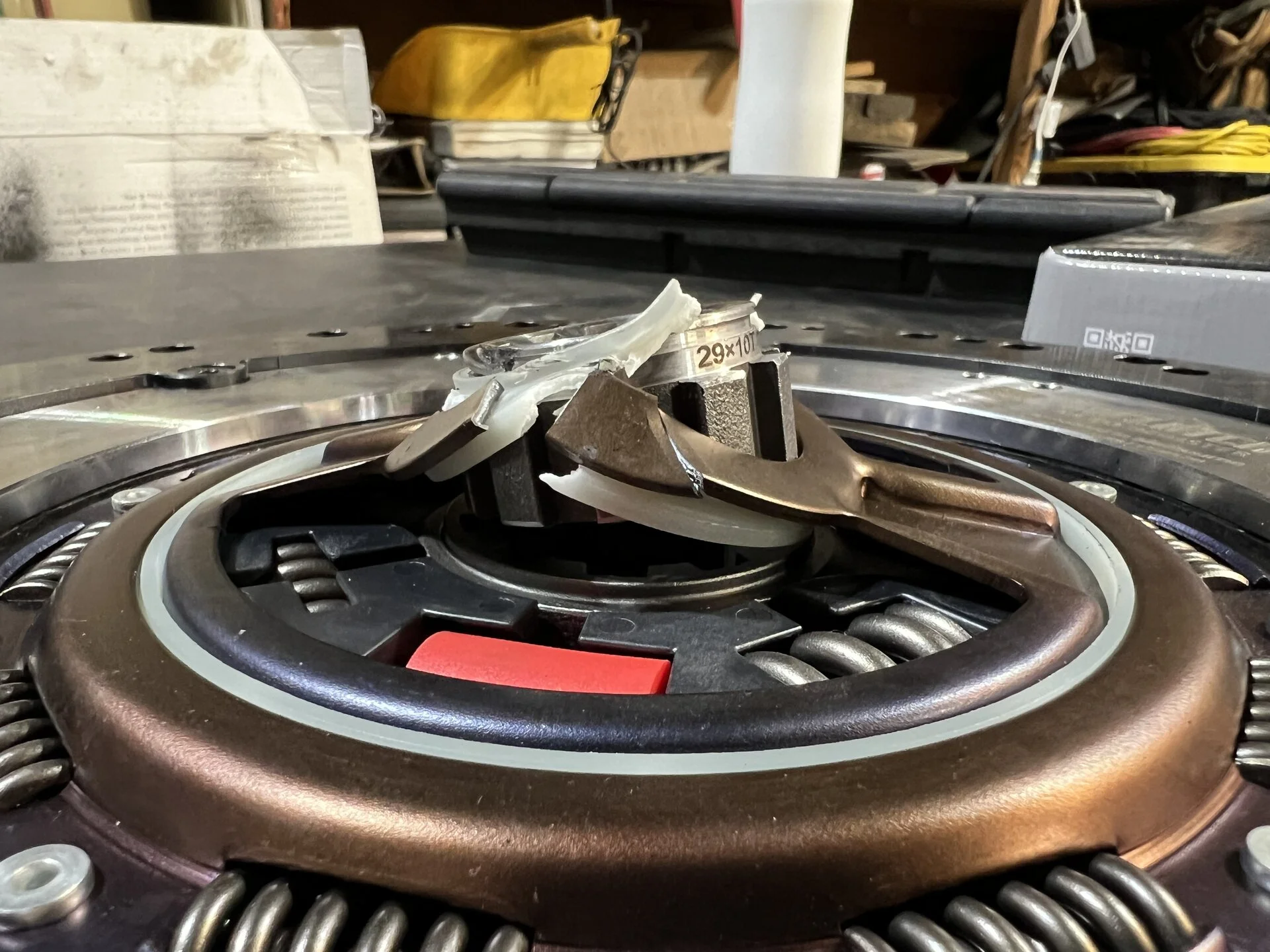

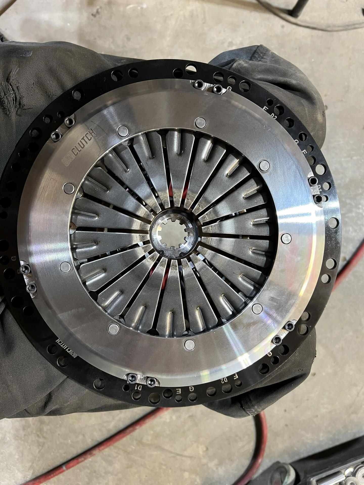

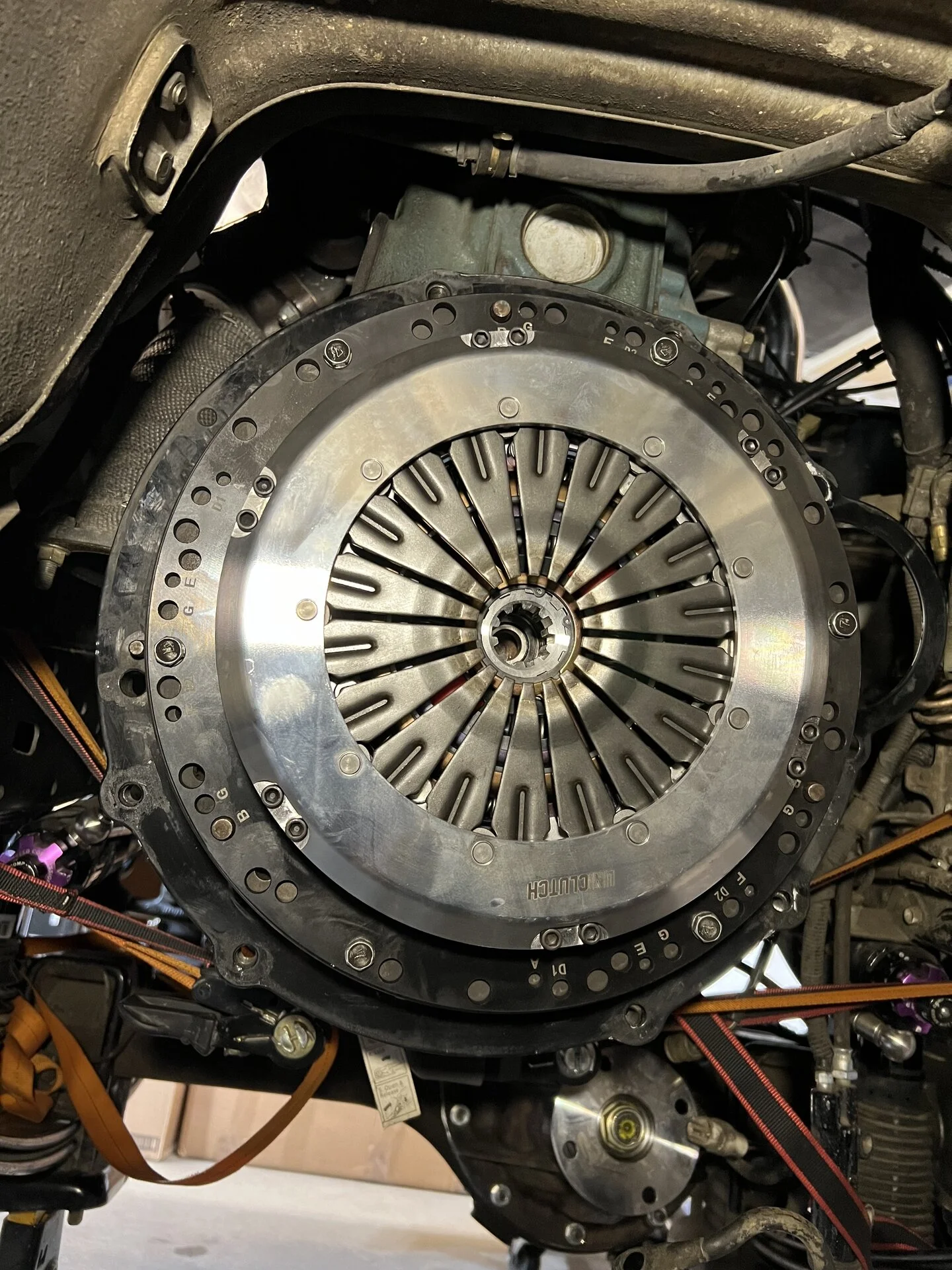

After fighting the transmission for two days I removed it this morning to find what I feared. I destroyed the clutch trying to get everything lined up and slipped in😡

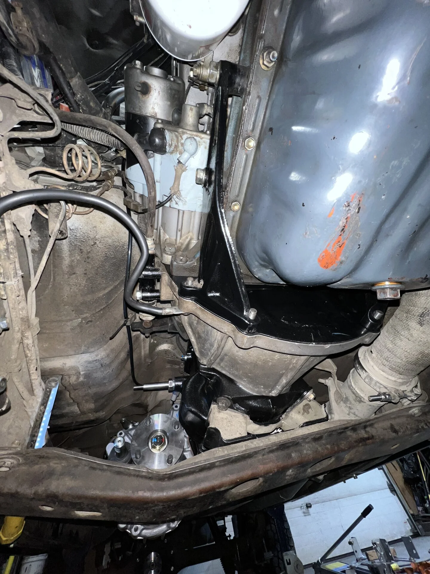

This time I put the transmission into first gear so I can wiggle the rear output to wiggle the input shaft to fit into the splines on the clutch and into the pilot bearing. Tomorrow should be done with putting everything back together and fill fluids. Hopefully be able to test drive before I head back to work tomorrow night

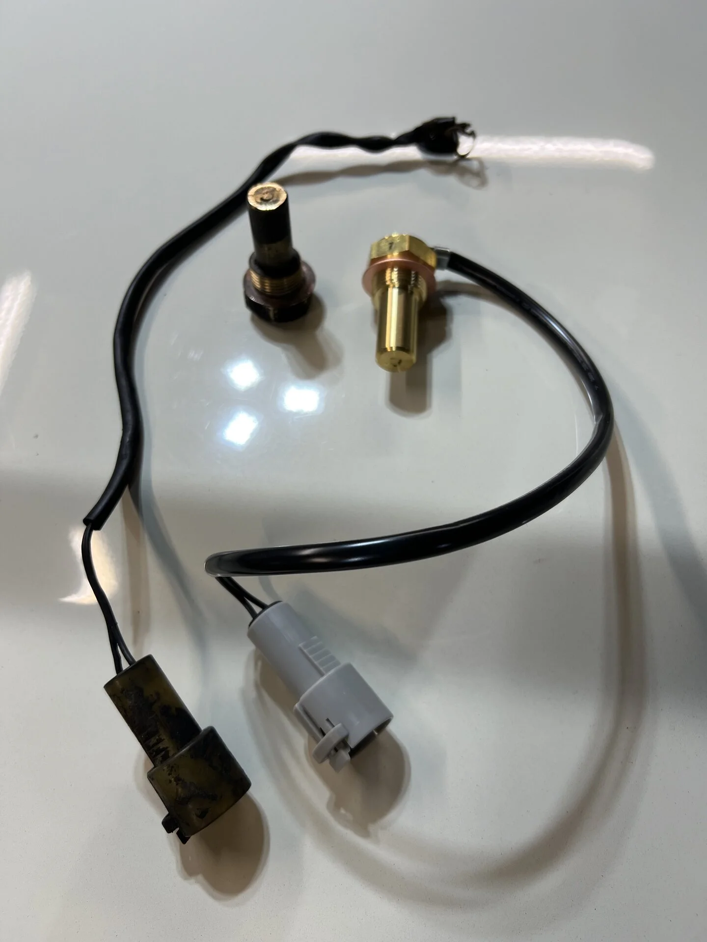

Different model years? Looks like the important connections are in the same places.

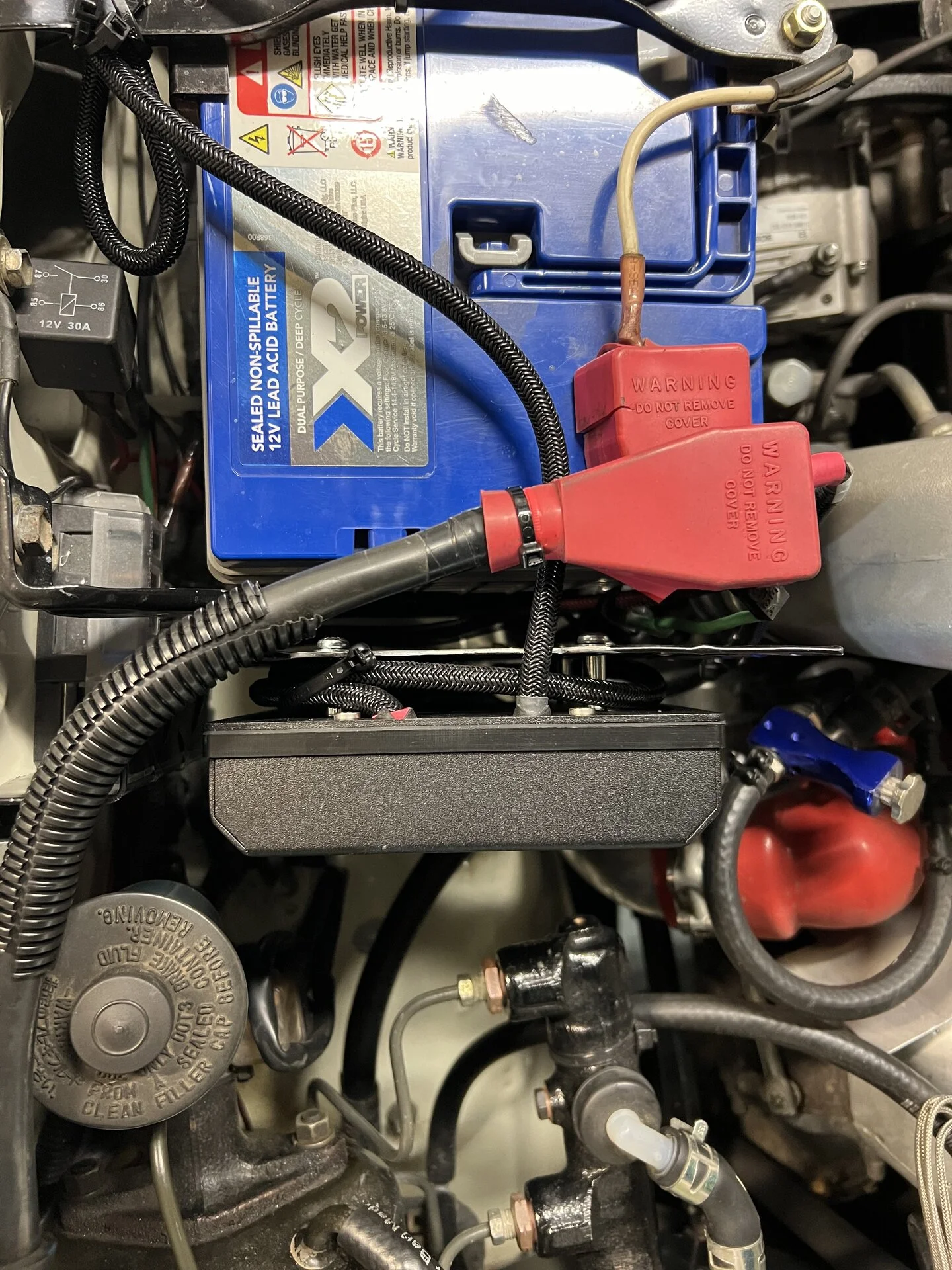

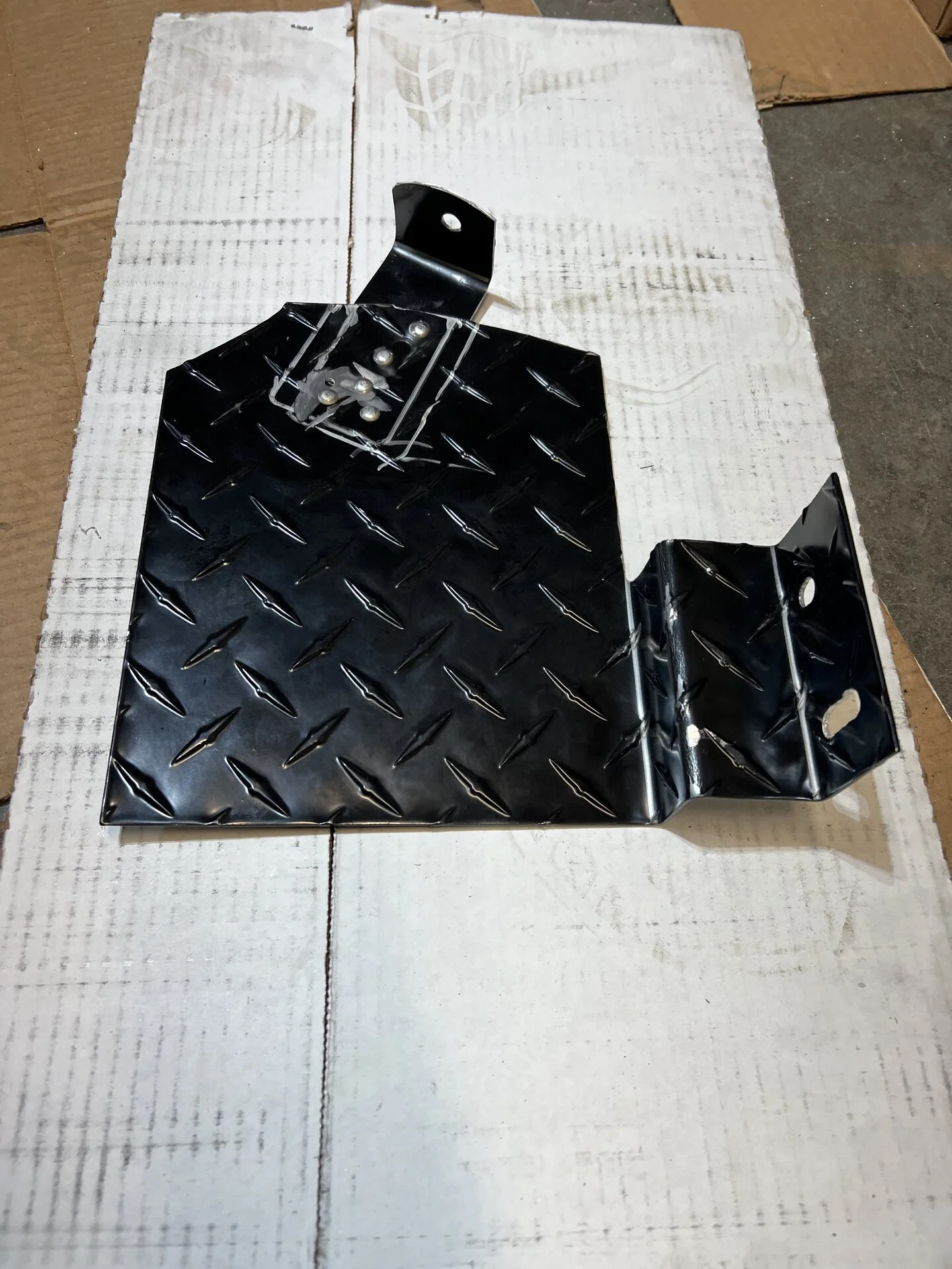

Did you use aluminum diamond plate and rivets to make the 12V bracket?
