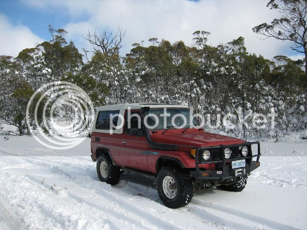

Here is my AIRFLOW snorkle as fitted to my BJ73 been on for over 6 years. No problems. Have had to replace the top but that was my fault...:rolleyes:
Great pic,is that a factory sunroof?
Thanks for the kind words
I wish it was a factory sunroof, maybe it would not leak then....
