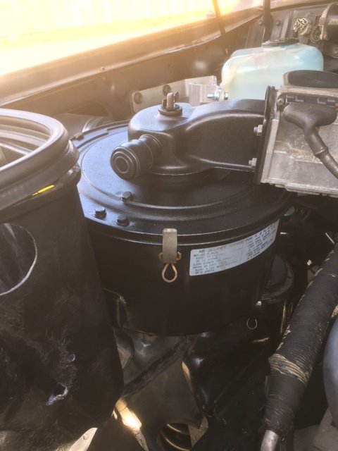

Hello everyone, just joined MUD but been coming here since I got my 94 In 2018. My question is and please don’t piss yourselves laughing but I’m adding a stock battery tray on the passenger side and box on the side of my air can is in the way. I’m been trying to find what is and if I can get ride of it and just run a 90 degrees hose from the air cleaner can straight to the engine 🤔🤔but before I do that would be nice what it is and what will happen.

im trying for the same set up as yours. Not talking about the cruise control. This is a black box looks like something another filter goes in but sealed. Has a hose from the top of my air filter can and at the bottom has a hose coming out into the engine. your air can doesn’t have it, but my 94 does 🤔
this is a pic of another cruiser with an engine like mine. I have my washer bottle moved to where yours is but that pesky box is where my tray will sit 🤔
Sorry, forgot the 93-94s had the PAIR system. Do a search for that. I think guys/girls just delete them. Random thread I pulled up below...

Thanks for the help. It’s a lot easier finding info on something when someone tells you what it’s called 😂😂. I’m going to get a hose and run it straight to the pair system bypassing the box. Then I will have room for my battery box. Of course be awhile until I get a battery for it, until then be storage 😂😂.Thanks again Hobbes you have not only solved a big mystery for me, you have gotten me closer to a two battery system 👍👍👍

Sounds great, as far as I got is moved my washer bottle and the whole pairs system and installed the tray. Now I’m tying to figure out where to go now lol
