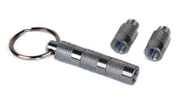

I use these screw on deflators. Cheap and reliable.
"Simply screw the deflators to the valve stems, the further you screw them on the faster the pressure is released. Use any standard air gauge on top of Deflator, when desired pressure is reached, simply unscrew the Deflator from the valve stem and screw it back on to the Deflator key chain. They are easy to setup and you can air down all four tires at the same time."
