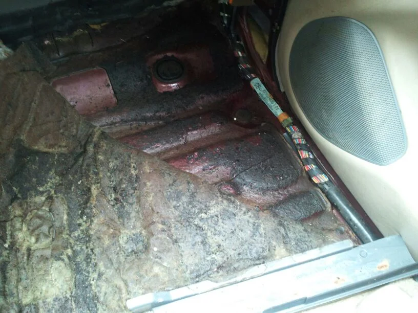

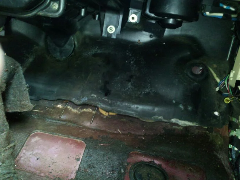

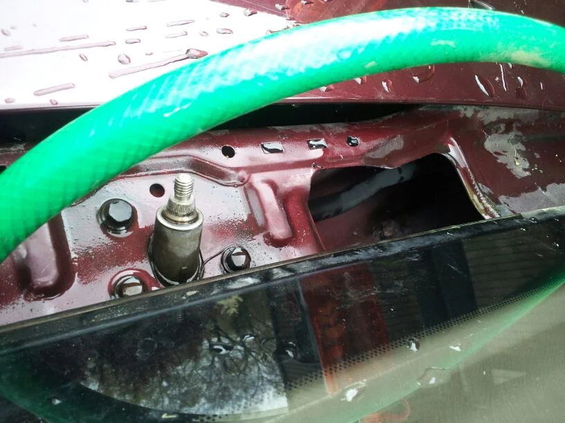

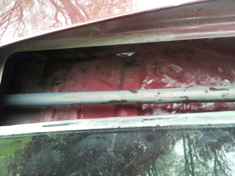

Here are the pics of the passenger side with panels removed and carpet pulled up. Also, two pics of the compartment below the cowling with water running through it-- pretty clean.
sound dampener is, well, very damp! No additional drops came from running the hose on the cowling area or from water on windshield/bubble test.

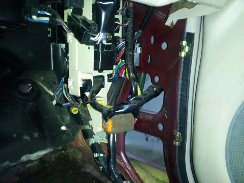

electricals on the right side of the wet carpet is VERY dry! phew!

Notice the drops on the firewall-- is that from the evaporator?

w/o cowling pic
w/o cowling pic
