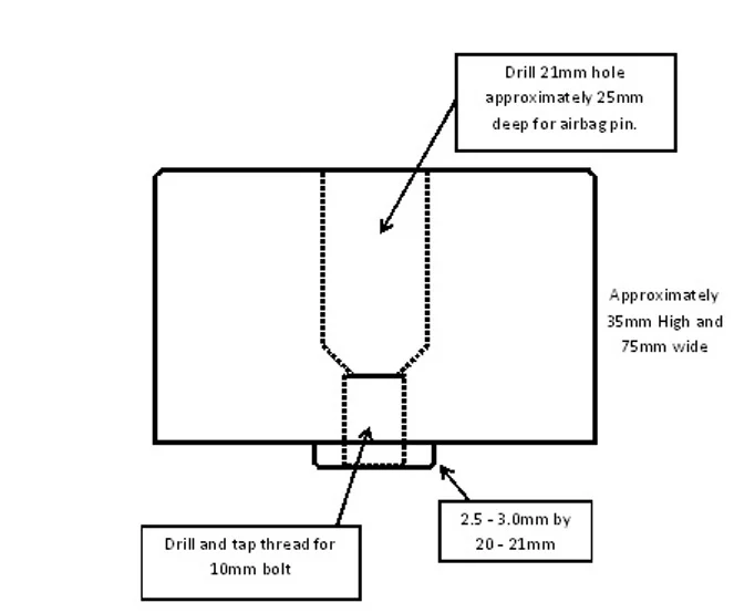

I read on here that there were spacer plans kicking around for the GX470 Air Springs, but I cannot find them. Can anyone point me to where they might be? I'm also interested in a possible source for pre-made ones. Thanks.
AMTS in Australia made some. Message them to see if they still make them.
Had this image saved from someone's post back in 2015. Never used it because I bought the AMTS version above that angles the bags correctly. Not sure about any of the actual dimensions.
Using those plans, what holds the bag in? I thought they had twist and lock tabs on them?
