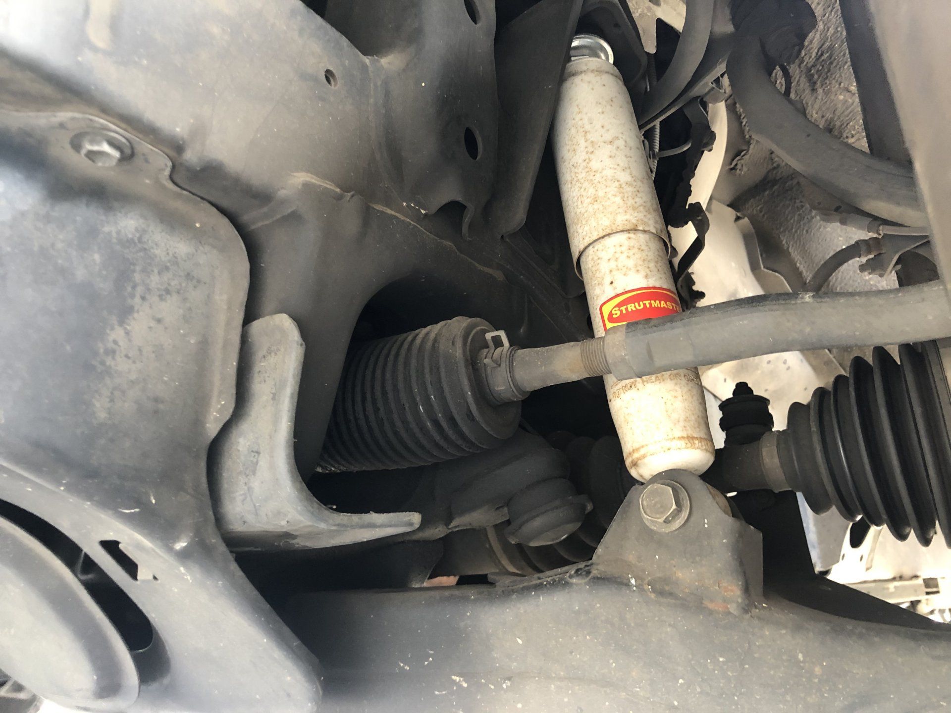

So currently on my car I have a strutmaster kit would i be able to just buy shocks and torsion bar instead of a whole kit. Also I dont know if its because of strutmaster but right now the back or my car is lifted and the front isnt.
I'm guessing that's because the Strutmasters kit (which IMO shouldn't be sold because it's inherently unsafe and I'm amazed they haven't been sued yet), includes proper rear springs and does NOT include proper front springs. You have to reindex the front torsion bars a few times to come close to getting enough spring. Even then, the spring rate is way off. Your rear is properly supported, but the front is not.
Strutmaster's claim to fame is cheap kits to replace air bags on cars with air ride. A Strutmaster kit does not come with torsion bars.
Ohhh ok, thanks for the info that makes a lot of sense now!
