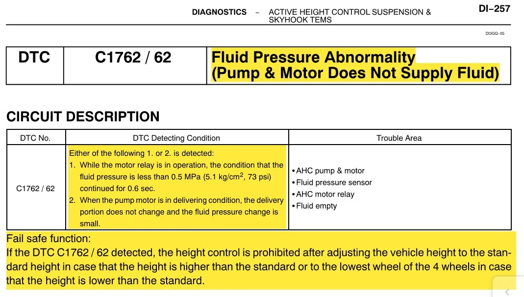

Diagnostic Trouble Code DTC C1762 -- What does it mean?
Main points from the FSM wording:
  • Low flow or low pressure downstream of AHC Pump at Pressure Sensor for 0.6 seconds results in "Fall Safe Function",
  • Real time Height Control is prohibited in "Fall Safe Function"-- vehicle may stay at "N" height, or, in motion over bumps, or on gradients, may go to lowest wheel height,
  • Real time damping is prohibited in "Fall Safe Function" -- damping is fixed at setting 8 of the 16 available damping settings, no TEMS a.k.a. AVS, therefore pogo like 'ride effect',
  • Active Test cannot overide the prohibition imposed by the "Fail Safe Function".
Side-note: Unlike industrial gear pumps, there is no high pressure relief valve protection nor low pressure cavitation protection in the AHC Gear Pump. Instead the protections adopted by the AHC Pump designers is for fast response times in the event of a fault as set out for several pump or pressure or related DTC’s:
C1711 to C1713 (Height Control Sensors): 0.2 sec
C1718 (Pressure Sensor): 1 sec;
C1762 (Low Pressure Abnormality): 0.6 sec
C1763 and C1764 (High Pressure Abnormality: 0.3 sec;
C1751 (Pump over-run): 85 to 100 sec;
  • Each of these DTC's has it own individual, FSM-defined "Fail Safe Function" -- the details are different and important, best to read about these in the FSM,
  • All of the different "Fail Safe Functions" have in common the prohibition of real-time height control, and, prohibition of real-time damping (comfort) control,
  • If a "Fail Safe Function" has been initiated by the Suspension Electronic Control Unit (ECU), then this prohibits real-time height control and real-time damping (comfort) control,
  • The prohibition cannot be over-ridden by the "Height Control Operation Test - Active Test" -- it should not be expected to be otherwise as this would be similar to 'bridging out' a protection in an electrical circuit to defeat (unsafely) the purpose of the protection,
  • The prohibition remains in place until the DTC is cleared,
In the case of DTC C1762, if the DTC is cleared but the fault remains in place, then the prohibition will be re-imposed in 0.6 seconds after engine or AHC system starts again.
This is why a repetitive process of start/clear DTC/re-start/clear DTC/re-start etc, etc, may be enough to gain some height which in turn builds up enough pressure to alleviate the low pressure cause of DTC C1762 in the first place (and why a small pressure spike from rocking the vehicle may sometimes help).

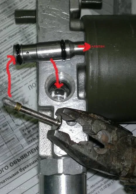

  • partial blockages of one or both strainers in the AHC Pump sub-assembly, especially the Inlet Strainer -- see well-illustrated thread linked below under the heading "REFERENCES",
  • partial blockage of the strainer in in the Return Valve,
  • partial blockages in the actual Return Valve itself, where it is meant to divert (dirty) returning AHC Fluid directly to the AHC Tank, not through the Pump gears -- see second well-illustrated thread linked below under the heading "REFERENCES",

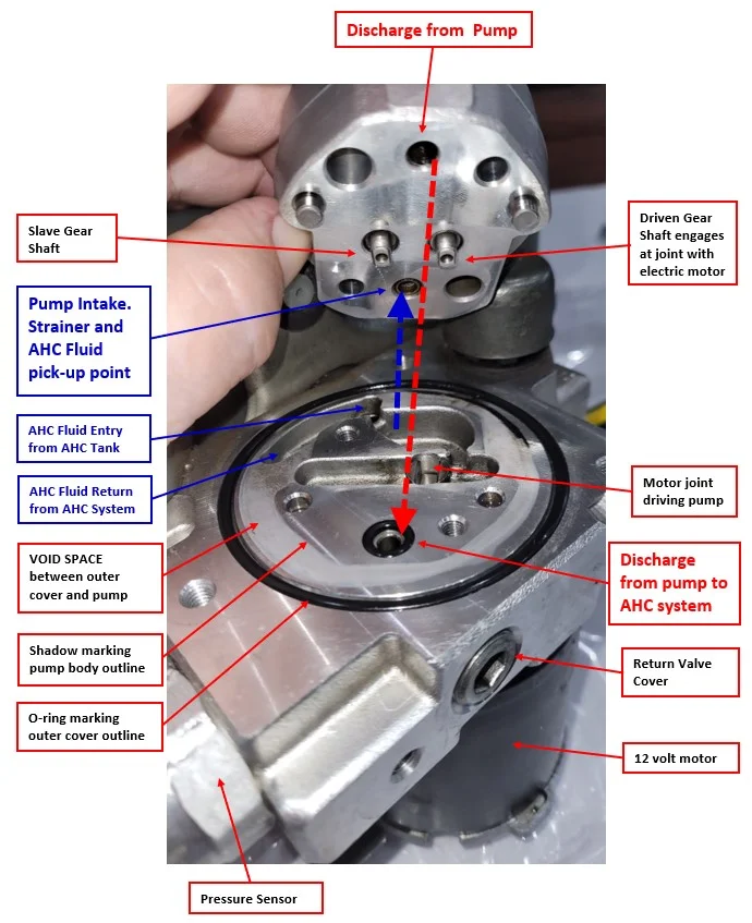

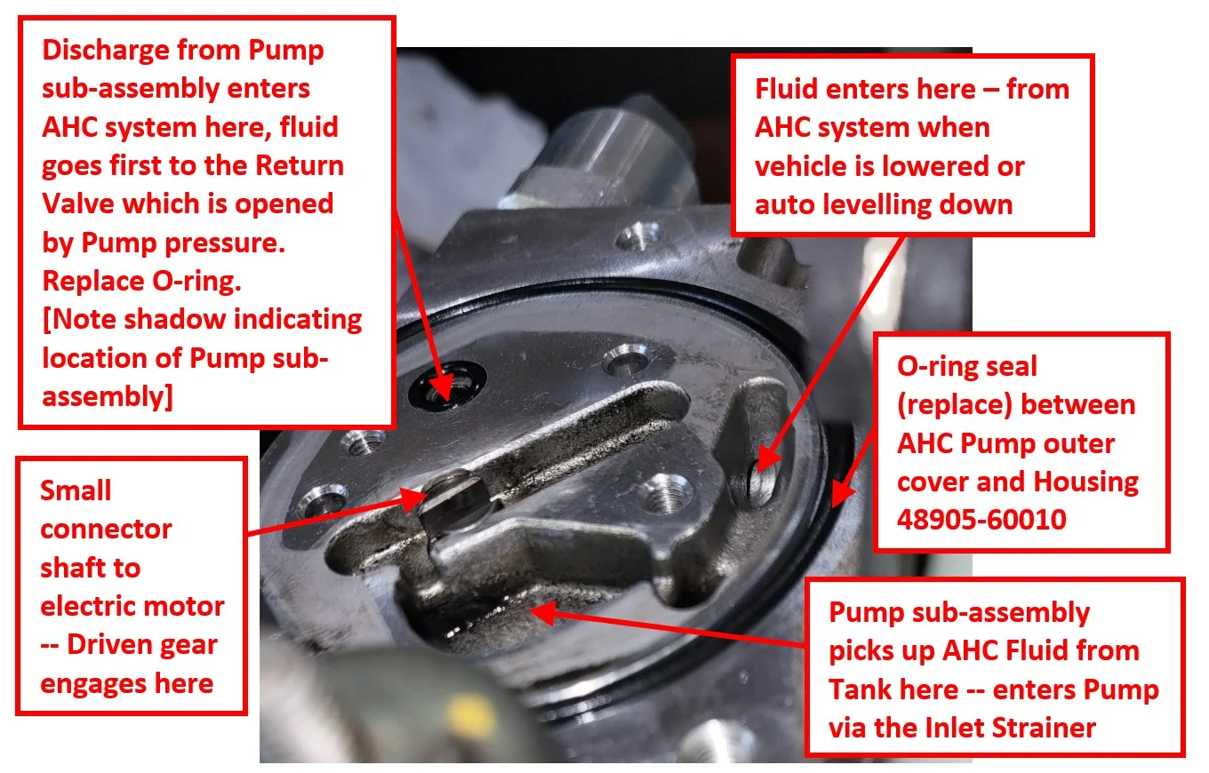

  • air entrainment possibilities on the low pressure side of the AHC Pump could occur at items marked with a Black Diamond on the diagram below -- seems less likely given that Inlet Strainer and potential blockage are on Inlet side of the Pump, so suction head will be lost there, seems more likely that gears will churn, more fluid slip across top and bottom planes of the gears, more bypass flow along clearances between gears and carriers and walls etc -- anyway, marked items listed are best replaced if the whole AHC Pump assembly is removed for other work:
  • grommet below AHC Tank -- Part Number 47255-60010,
  • O-ring on entry to AHC Pump sub-assembly -- Part Number 90301-06012,
  • oil seal at motor joint -- Part Number -- Part Number 90311-10001,
  • O-ring at outer case covering AHC Pump sub-assembly -- Part Number 90301-70003,
  • Note: there are no pathways for entrainment of external air directly to or around the screens/strainers within the AHC Pump or within the Return Valve.

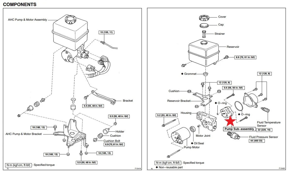

A few notes on the AHC Hydraulic Circuits:
This components and the AHC and TEMS systems are well-described in the FSM "LC100/LX470 AHC-TEMS General Description" extract attached to "Previous Posts", also at HOME | LC100 Factory Service Manual - https://lc100e.github.io/ -- at Index, Tab to Home > New Car Features > CHASSIS > SUSPENSION > Description -- suggest re-read details of components and hydraulic circuits. One scenario (raising the vehicle) is illustrated below:
In relation to questions, there are several points to note after studying the hydraulic circuit diagrams in the "General Description" document:
  • the screens/strainers are completely enclosed in the hydraulic circuit -- two strainers within the AHC Pump sub-assembly Part Number 48901-60010 and one strainer within the Return Valve which is located inside the the milled block Part Number 48905-60010 to which the AHC Pump and its Motor are attached on either side,
  • there is no opportunity for external air to enter around these strainers,
  • build-up of gel or debris in strainers causing reduced AHC Pump delivery is possible in a 19 years old vehicle,
  • Fast raise times suggest only that Height Control Accumulator works properly (when not prohibited by DTC C1762), does not indicate satisfactory AHC Pump performance,
  • significant partial blockage of strainers with gel or debris from around the system would cause reduced flow and delivery pressure and DTC C1762 and prohibition of Active Test -- test flow from AHC Pump with discharge pipe removed MUST look as strong as shown in first picture (not second picture) in "Previous Posts",
  • if flow test is satisfactory, no need to be concerned about strainers,
  • if flow test is not satisfactory, need to remove AHC Pump assembly, dis-assemble and remove AHC Pump sub-assemby, open and remove and clean strainers, OR, after 19 years in use, replace with new OEM Toyota/Lexus AHC Pump sub-assembly Part Number 48901-60010 (Parsouq: USD183.79 plus freight plus taxes/tariffs) for better reliability and longevity,
  • if removing AHC Pump sub-assembly, also suggest take the opportunity to remove and clean strainer in Return Valve and check that Return Valve is clear of blockages -- interference at the Return Valve also causes DTC C1762 and prohibition of Active Test,

How to remove complete AHC Pump Whole Assembly, open AHC Pump sub-assembly and clean strainers:
Read well-illustrated Posts #1 to #15 inclusive at
AHC pump removal with pics - https://forum.ih8mud.com/threads/ahc-pump-removal-with-pics.1227554/#post-13401739 and onwards to Post #15
How to open Return Valve and clean strainer and clean Return Valve mechanism:
Read well-illustrated Posts #1 to #16 inclusive at
AHC pump assembly - bench test NG - https://forum.ih8mud.com/threads/ahc-pump-assembly-bench-test-ng.1344484/#post-15596125 and onwards to Post #16

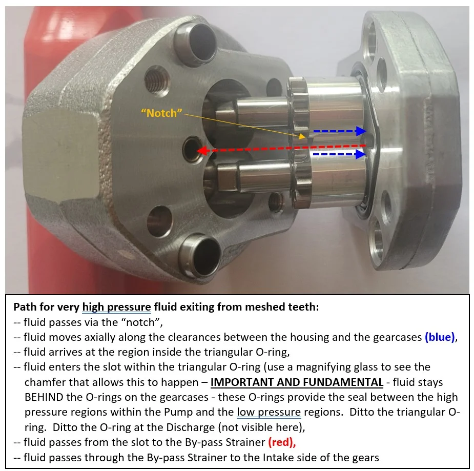

Overall Pump Assembly opened, showing Pump sub-assembly and fluid flow:

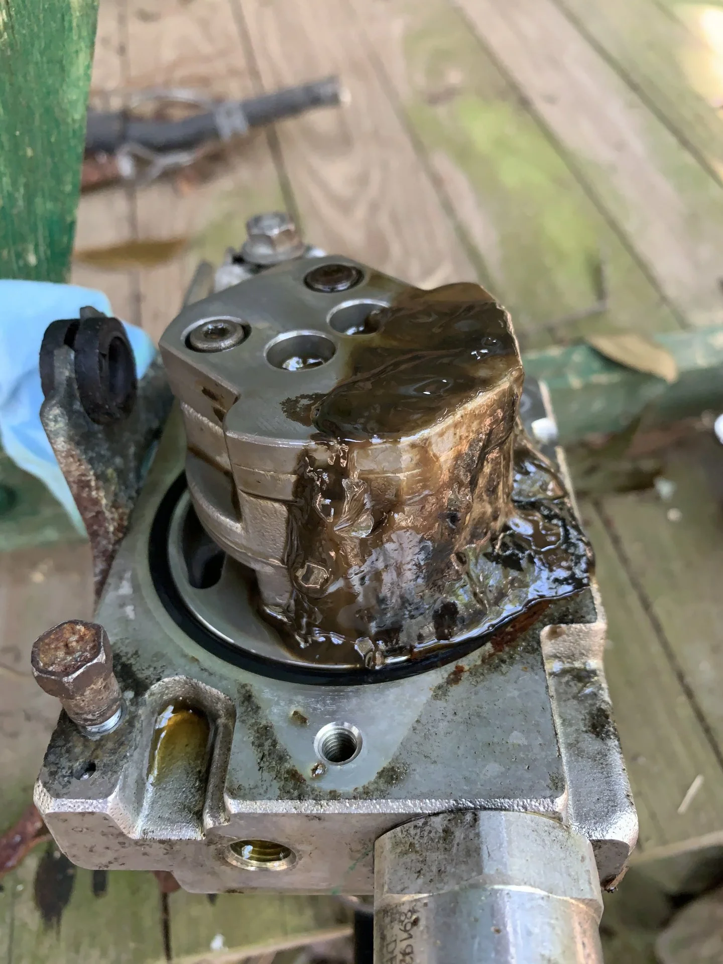

Clogged Pump:

-The C1762 code did not reappear since that one day when I had to jack up the car and rock it back and forth to get it to rise to N. Luckily that was one issue that didn’t return.
