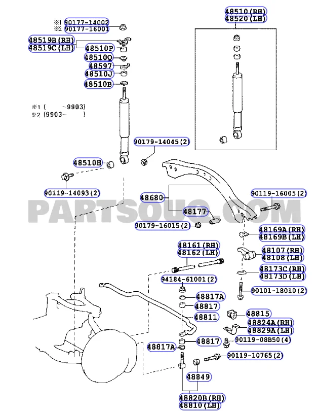

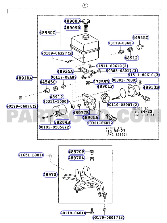

I am looking for Diagrams on AHC system. My fuse for AHC has been removed. I am going to add pictures of my car to better understand what I have/what I need.
For now this is what I have for part numbers and diagram's.
I have been watching removal videos to get an idea of all of the components but I am wondering if anyone here knows anyone who has reinstalled their AHC?
I know there is a Save AHC crew and a Remove AHC crew, what is the verdict if the system is partially removed? To me it looks like shocks/maybe springs were removed and lines were cut and plugged and fuse removed on my vehicle. I am unsure if torsion bars were replaced. my guess is no since the previous owner seemed to not want to put money in to this vehicle the way she once had.
