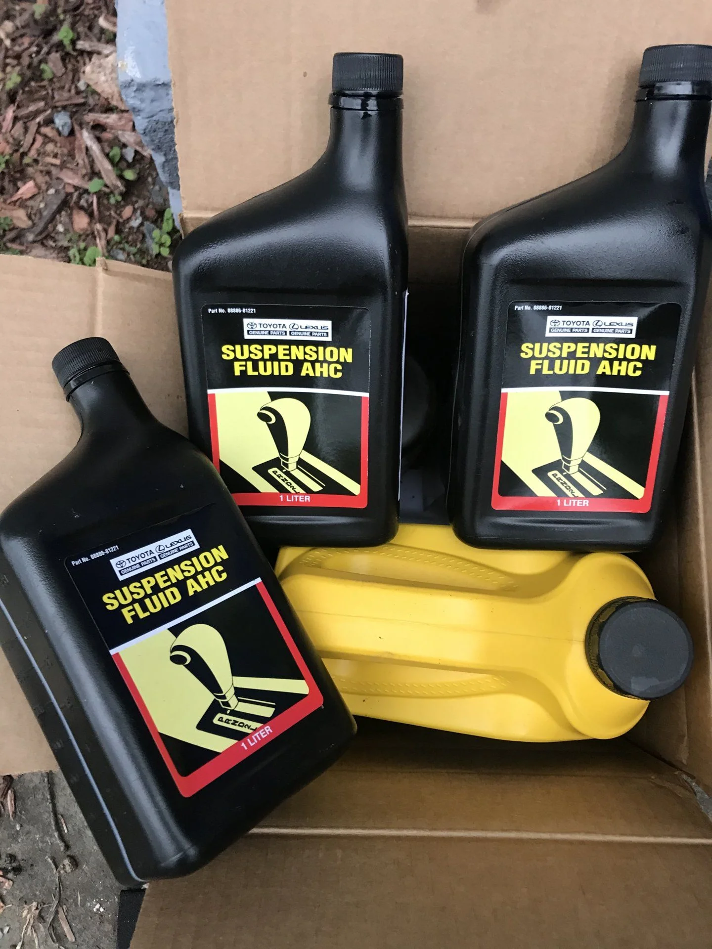

I followed instructions on the 100 forum and replaced the AHC fluid on my 2002 LX470.
Check out the fluid! Looks like cappuccino color at the bottom and dark green up to.
I used all 3L. Must buy specific Toyota/Lexus AHC fluid.

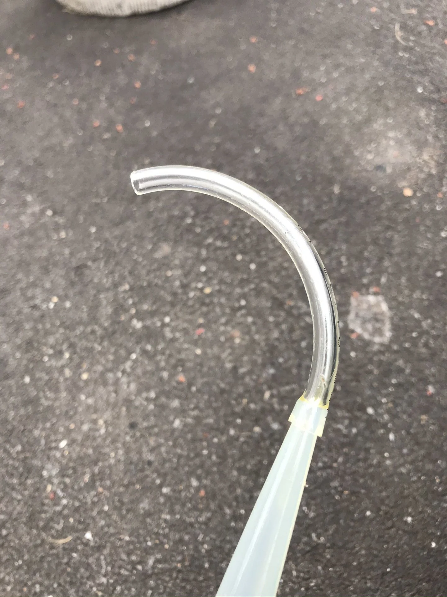

Used a Turkey Baster to remove fluid from the reservoir. Added a tube to reach the bottom of the reservoir. I wanted to get as much out of the reservoir before i started the bleeding process. Started late in the afternoon and then splashed myself with the last unit. Ugh
