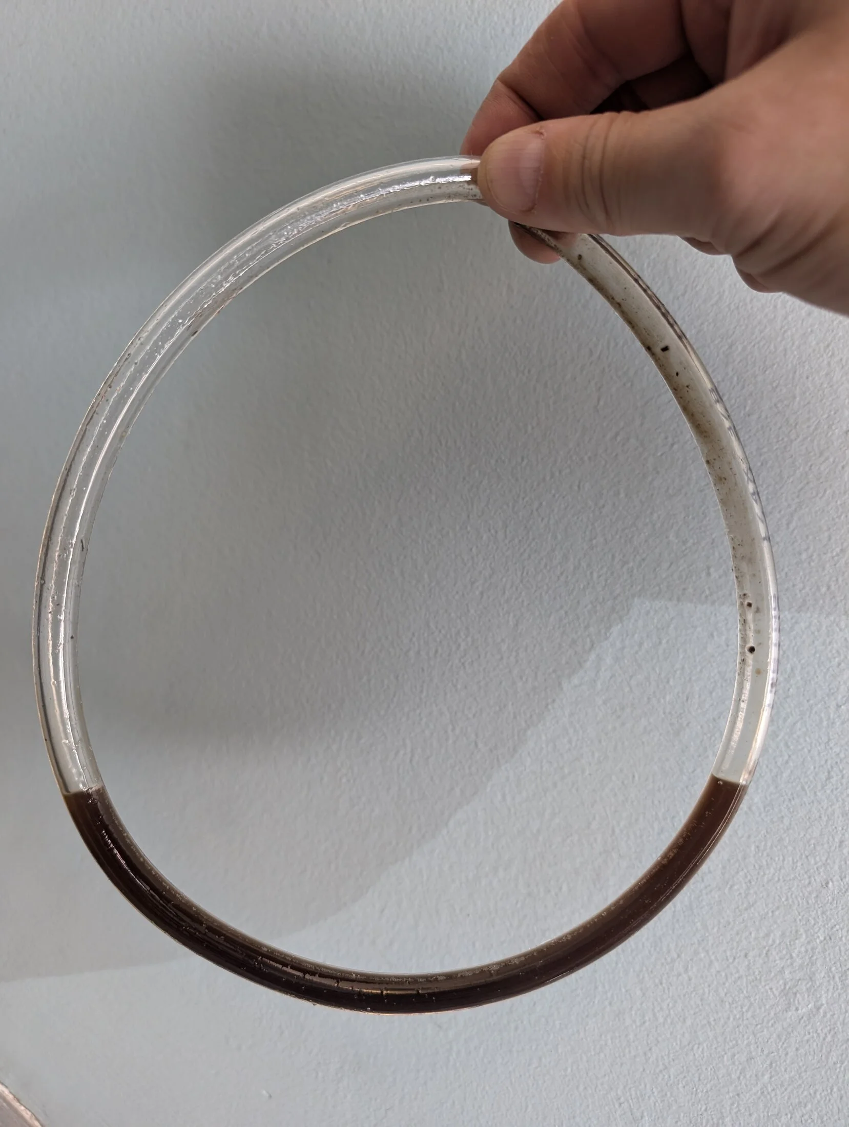

I bled each corner as a test to see if there was air and all immediately spat out clean & translucent (but light brown) fluid. Things took a turn when I bled the center accumulator - it was as dark as coffee and had chunks in it. See photo:

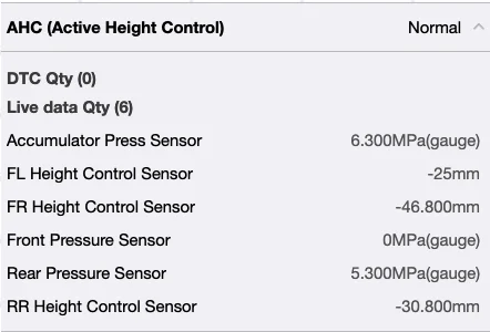

Accumulator pressure readings test 3/13/25 before doing any bleed testing: rear: 5.3mPa, front 0.0mPa, center 6.3mPa

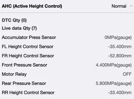

Accumulator pressure readings test 3/15/25 after bleed testing and attempting to raise car to N: rear 5.8mPa, Front 4.4mPa, center 0.0mPa

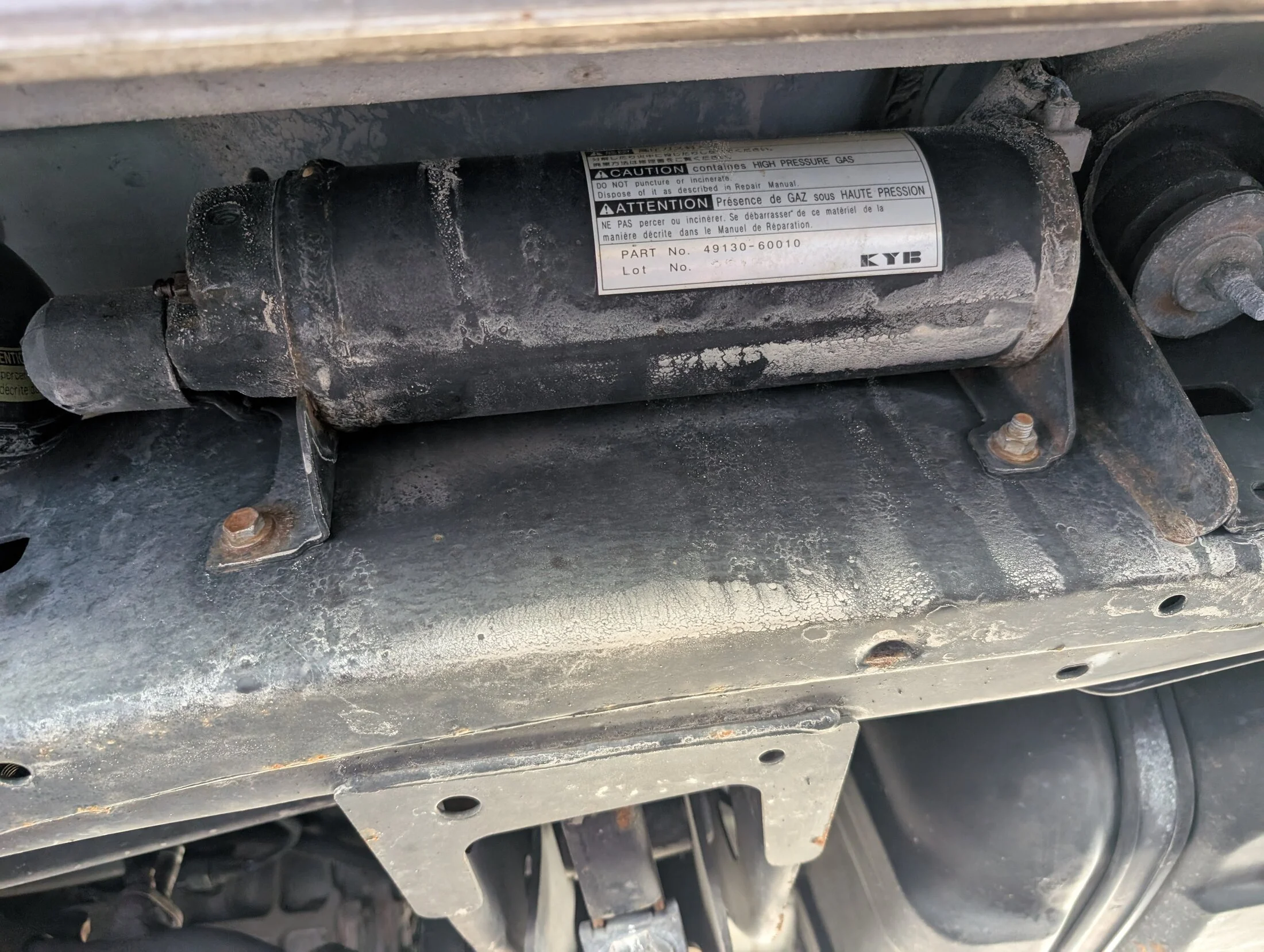

FWIW I have a receipt from the previous owner showing AHC system maintenance in 2023 - he said all four globes were replaced. On the invoice cost of parts was $752 and labor $110 which seemed low for all four, but looking underneath at the car all four globes do look pretty new (the one pictured is representative of all of them). Center accumulator does not look as new.
