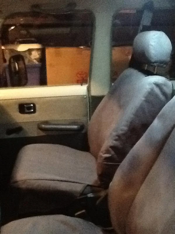

I recently put some manual FJ80 seats in my FJ55, they have a nice low profile that gives you plenty of room under the fixed wheel (same issue as 40s). I bolted them to the brackets that the '70s van seats that came with my truck used, could be easily modified to work with any type of mount:
attachment.php
attachment.php
Sorry for the crappy cell phone pics, they have Endura Great Covers on them, can get pics of the mounts if anyone is interested.
