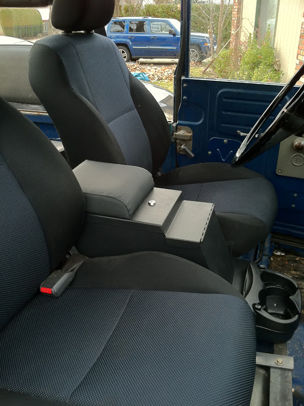

We installed these BMW 3 series seats into a 40 series restoration that we completed in February. They came with power and bun warmers, my favorite seat so far.
