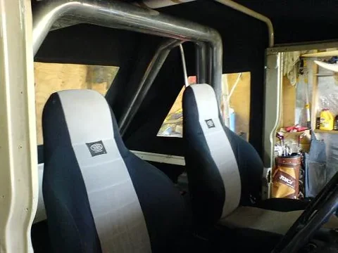

PRP "Daily Driver" seats with seat tray mounted to cage- fab by WickedFabrication in Santa Clara. Seats are really comfy- more so than my old prelude seats, though could use some lumbar support though. I am exploring getting a lumbar "bladder" that Corbeau sells for their seats. The seat tray is removeable so you can get to the tank and tunnel cover.
-Dustin
