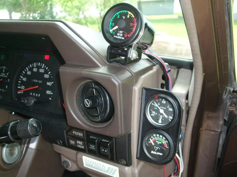

While I can not help you with the oil pressure probe issue ( that is way above my pay grade) I can at least show you how I mounted aftermarket gauges on my LJ78. The factory water temp. gauge as well as the factory oil press. gauge were junk anyway.
Hope that helps......1978HJ45
