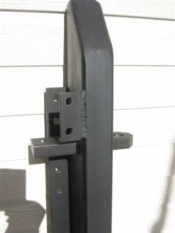

Made of 2x4 rectangle tube with heavy 1/4" walls and unique clevis mounts.
attachment.php
I can make any length you want add hoops and light tabs for you too like this.
attachment.php
PM me if you're interested.

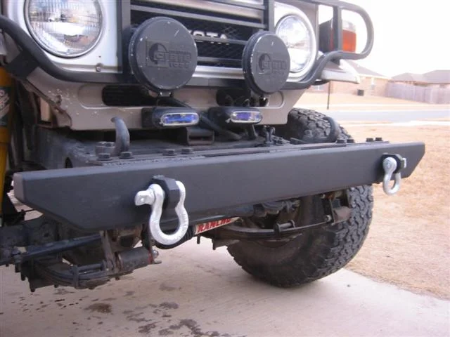

BEEFY D-ring mounts! I can't see why that would not work. I will try to get a better pic of mine. Same idea as yours, just MUCH more ugly.
