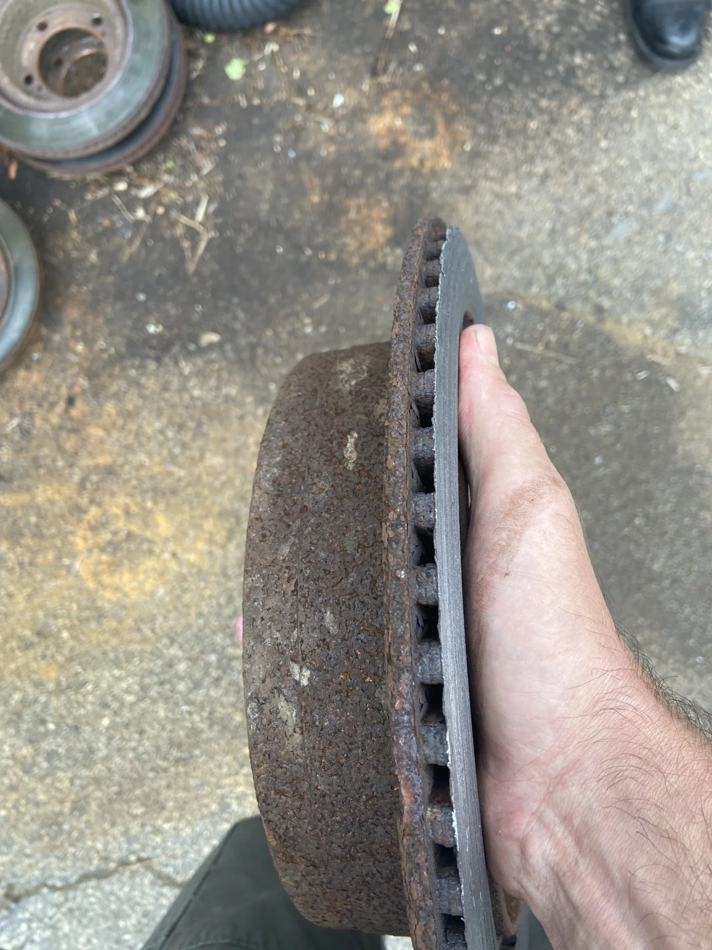

My 2 pennies are the stock brakes are pretty damn good. Probably don't need to say this but check obvious things first. My neighbor was complaining about really soft brakes and a little vibration when stopping.
That's one of the rear rotors. It's a 2011 with 189k original rotors. I replaced them with OE rotors and Tundra pads and did a proper bed in. Unfortunately it needed 2 rear calipers as well. The pistons pushed pass the point of no return on one side. The brake lines where almost gone as well in the back so she sprung for the up grade to stainless lines over OE.
The Tundra pads all around, new rotors all around and the stainless lines worked out pretty well. She is the original owner and said it never braked so firm even when new. I am thinking about replacing the OE brake lines with stainless for what it's worth.
