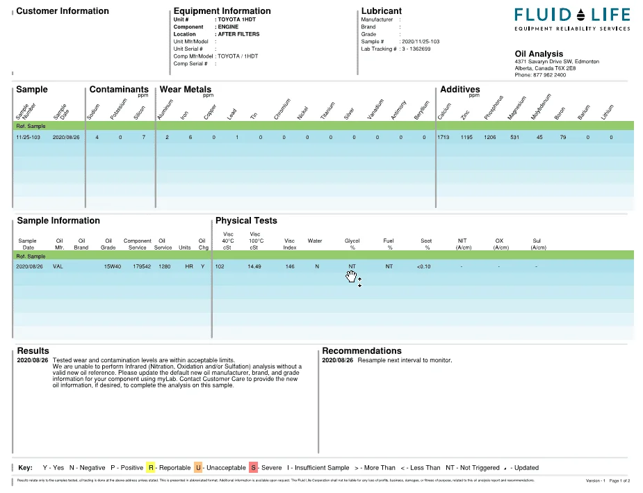

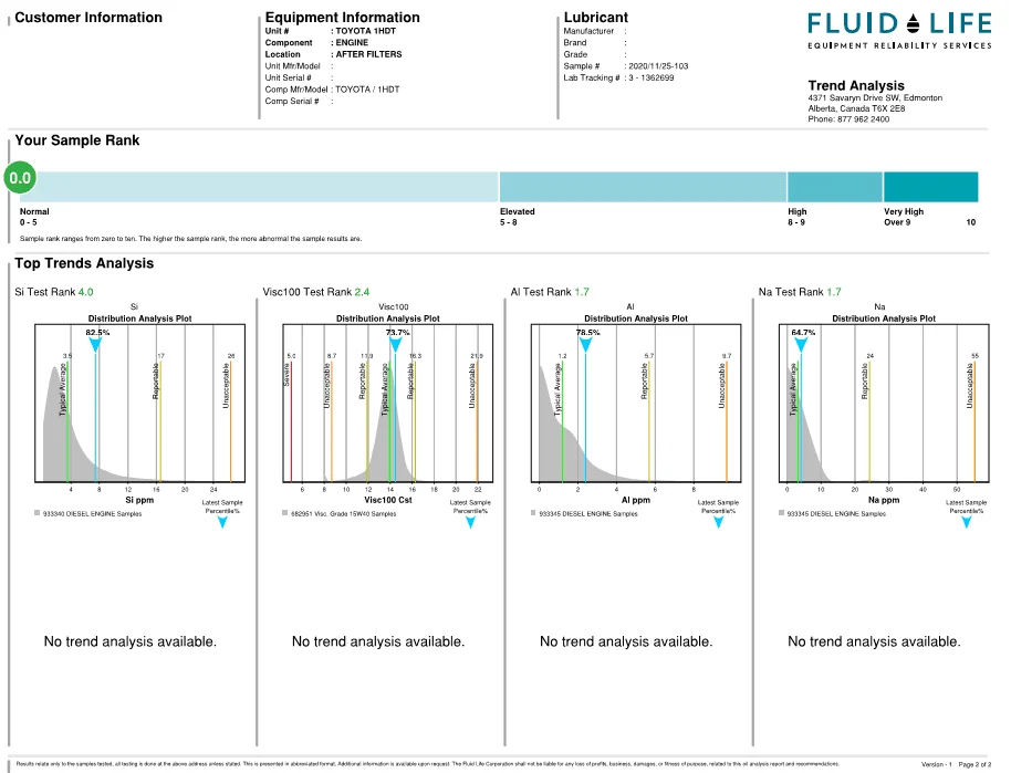

I "should" be getting my oil analysis back soon from that Co-op deal, be interesting to see what it may show from my lack of additives perhaps? Worse case is it doesn't show but I get 3 pails of diesel oil out of it.
And the results are in........but I'd need to send in some more samples to chart any kind of trend, but "wear and contamination are within acceptable limits" from this one test.
What brand/weight oil @Enigma?
Been running an oil analysis on my current truck every oil chance since new and it’s recently caught a coolant leak (confirmed it actually). It’s worth it in my eyes for the $20 an oil change to get a blood test for the motor
