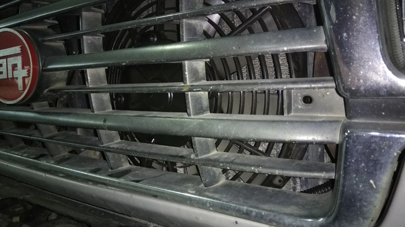

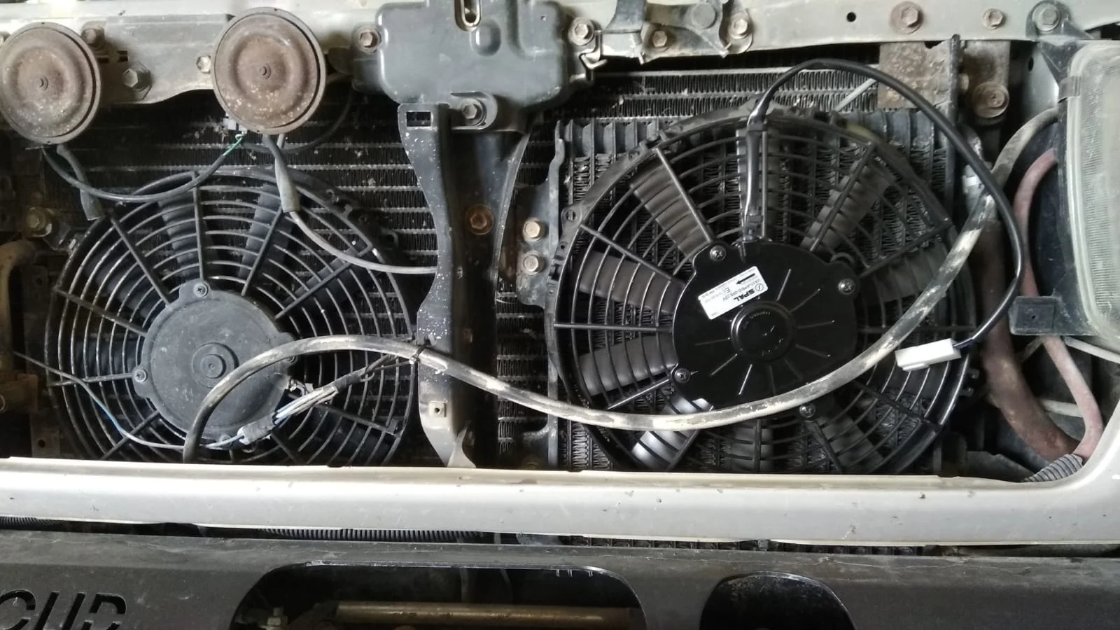

Added another front AC electrical fan for desert extreme hot weather
Jul 5, 2017
113
1,708
Israel
Added another front AC electrical fan desert extreme hot weather .
The PS is Toyota OEM I don't know if USA 80 have them its cascaded to AC and starts when the AC is switched on.
The Driver side Spal fan is operated manually

Any difference in operating temps?
Which Spal fan is that? Looks like a pretty low profile to fit behind grill.
