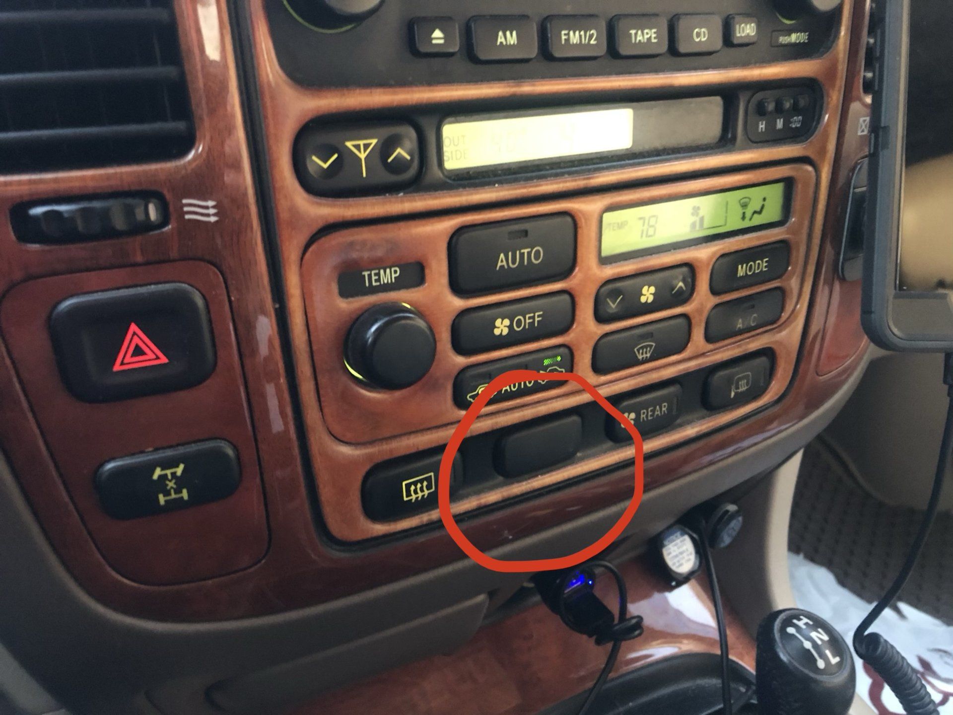

The rear AC and the rear heater are two independent, separate systems. The rear AC is for cooling only and has it's own switch up front (in addition to the controls at the back), shown here just to the right of the red circle:

Are you saying that you have both rear AC and rear heater?
I only have the button in the first pic, but if the rear controls are switched to hotter temps, it'll blow hot air. Is that different than rear heat?
There is no heat added to the air in the rear AC system, it just recirculates the cabin air and cools it down if required.

So, I found this interesting, and just played with both of them for a while in my '99 LC, and found it to be entirely wrong.
The rear controls on the ceiling most definitely control the rear heat on the floor, and both are turned on by the 'fan rear' button up front.
There was no heat coming from behind the console the entire time I drove to work, until I turned on the 'fan rear' button up front. Then on the rear ceiling controls, if I turned it to cold it shifted toward only cold air coming out up top and no heat from bottom. Turn it toward hot, and cold air up top turns off and floor heat turns on.
I have no idea if there's any valve switching coolant flow off and on, and the controls may just be turning an electric fan on and off that get the heat from it. But I just know the rear console vents were cold as can be until I switched on the rear system.

Your explanation is accurate. The "rear" switch on our dash board allows the console in the rear on the ceiling to be powered and active. If you want heat it only comes out of the floor in center console and is coming from up in the engine bay. If you want AC you need to be on head mode and it's coming from the rear AC system, flowing from the main ac compressor. If you have head and foot mode on, the middle center console vent will blow air and probably will be hot.
