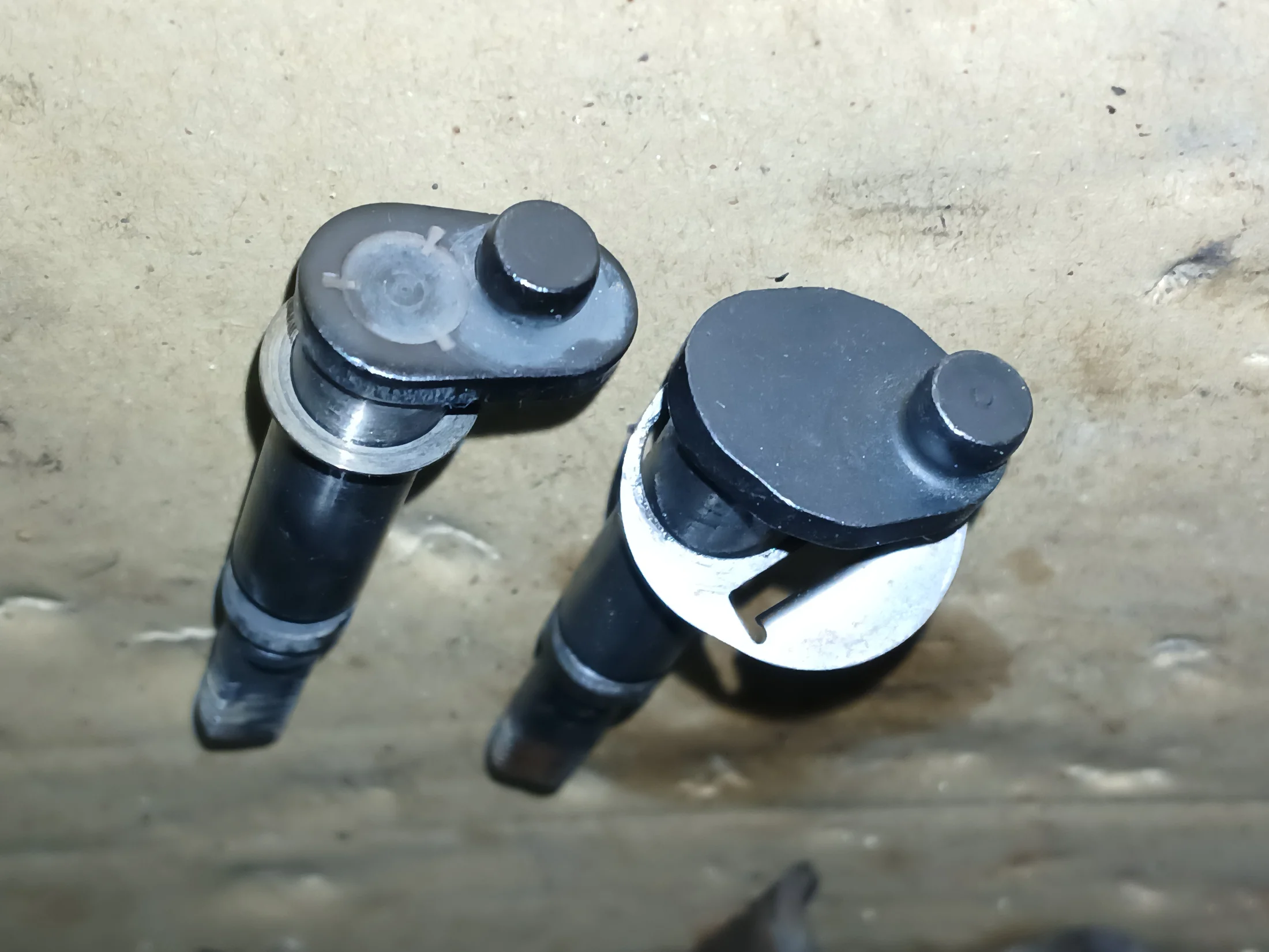

In the following picture are two ACSD shafts:
Left: a 14B ACSD (which went into production in 1988) from my 1994 15B-T engine.
Right: courtesy of @frankenyota, a 15B-F ACSD (which went into production in 1995).
Notice how the 1988 ACSD has a two piece shaft where the cam appears to be pressed/stamped onto the shaft. From what I have seen, it is this part that always disintegrates when the shaft fails. On the 1995 ACSD, the shaft appears to be turned from a single piece. A 'billet ACSD'! It also has a much larger cam, and a much larger washer. I would suggest that this has been done to prevent shaft failure, and that these design of shafts will not fail in the same manner.

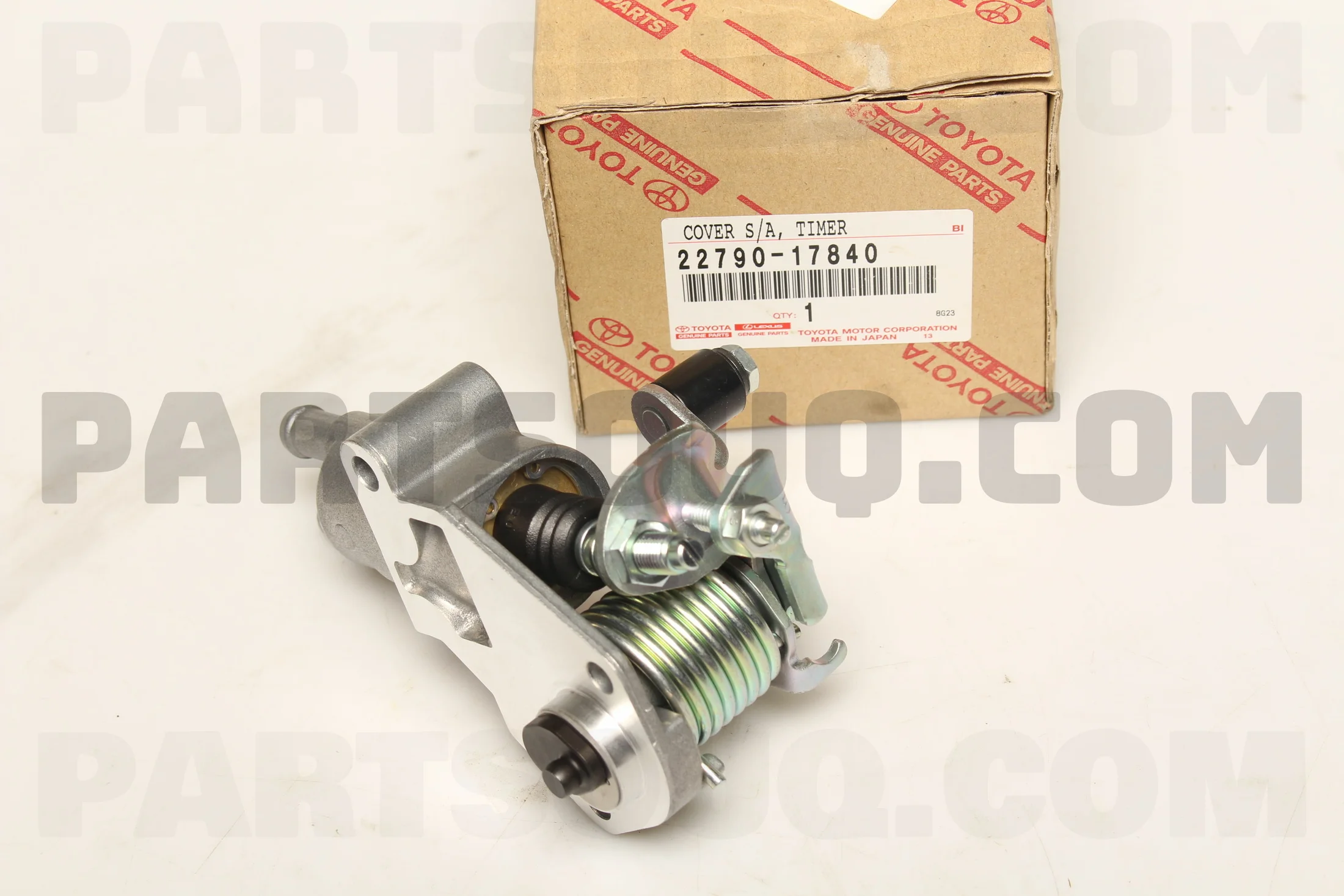

Now, let's look at 1HD ACSDs (both photos taken from Partsouq website).
Firstly, the 1HD-T ACSD, 22790-17141, launched in 1990:
And the 1HD-FT ACSD, 22790-17840, launched in 1995:
So, the same design change that I documented in the 14B vs 15B-F ACSDs.

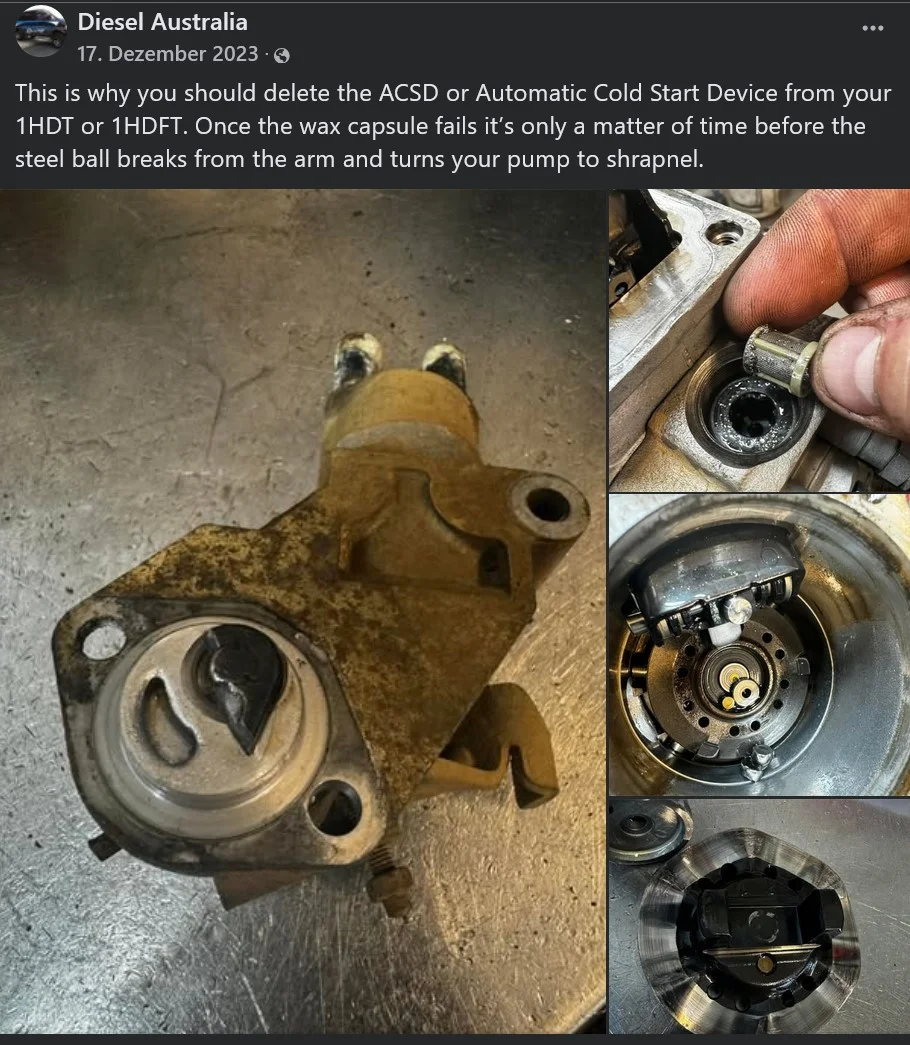

I remember seeing this post as well looking for information, from a FB account called "Diesel Australia".
Looks like this is from an early design ACSD as well
I wonder if they have seen a broken 1HD-FT ACSD, or whether they just assume they are the same. Also, I don't think the shaft failure has anything to do with the wax capsule.
I agree, it looks like the 1HD-T type ACSD with the pressed on cam. All the pictures of failures I have seen look like this. Looks like stress cracking around the joint of the shaft and cam to me.
