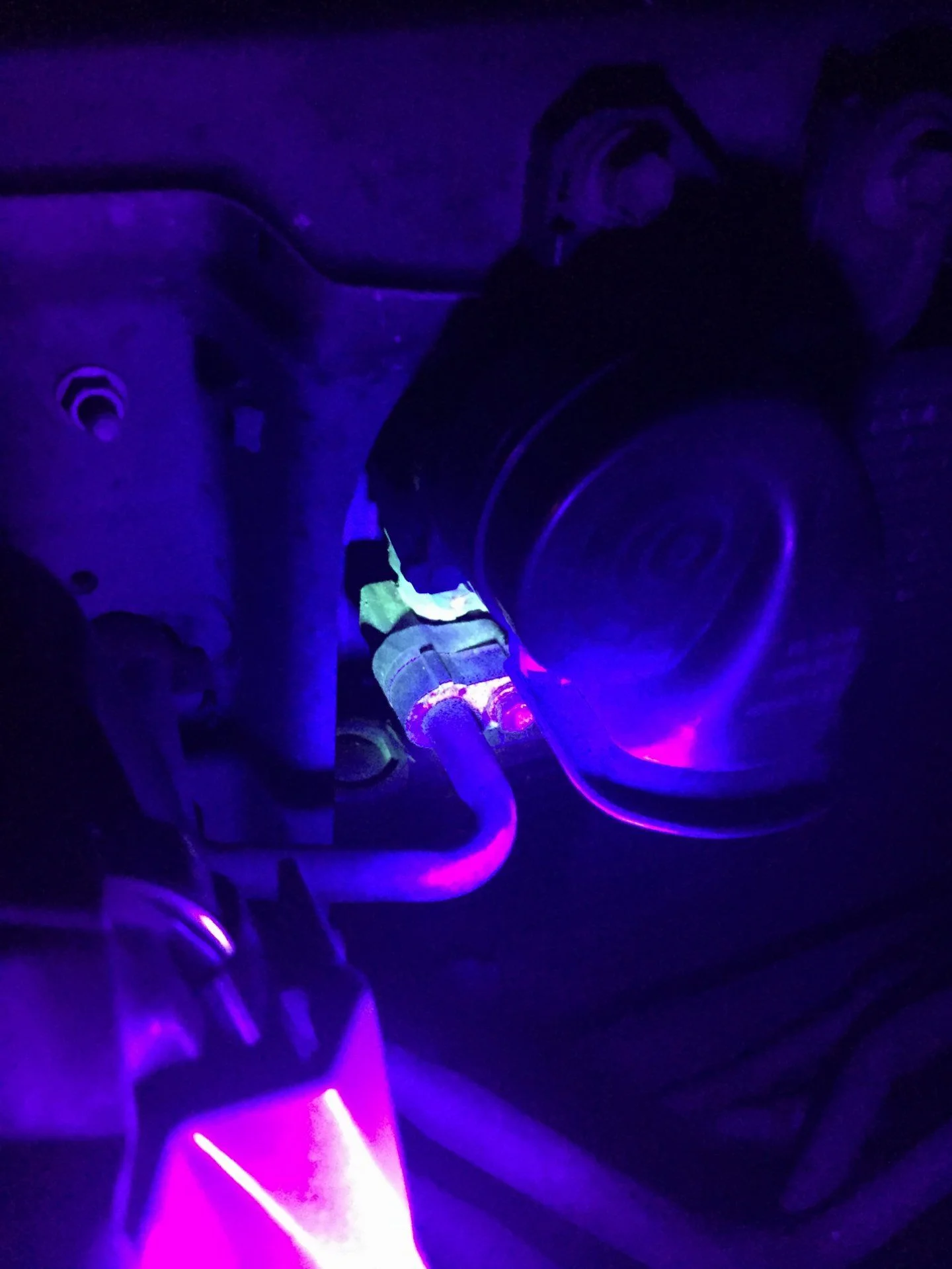

this is where mine is leaking. I tightened the bolt and and hope it fixes it. next step is to replace the o ring in the fall if the pressure drops again...
Tightening a joint like that is not going to help the leak. The O-ring is shot. Get AC type O-ring and put it all together.
It will in this case, but not the way the OP had intended. ;)
FML...
