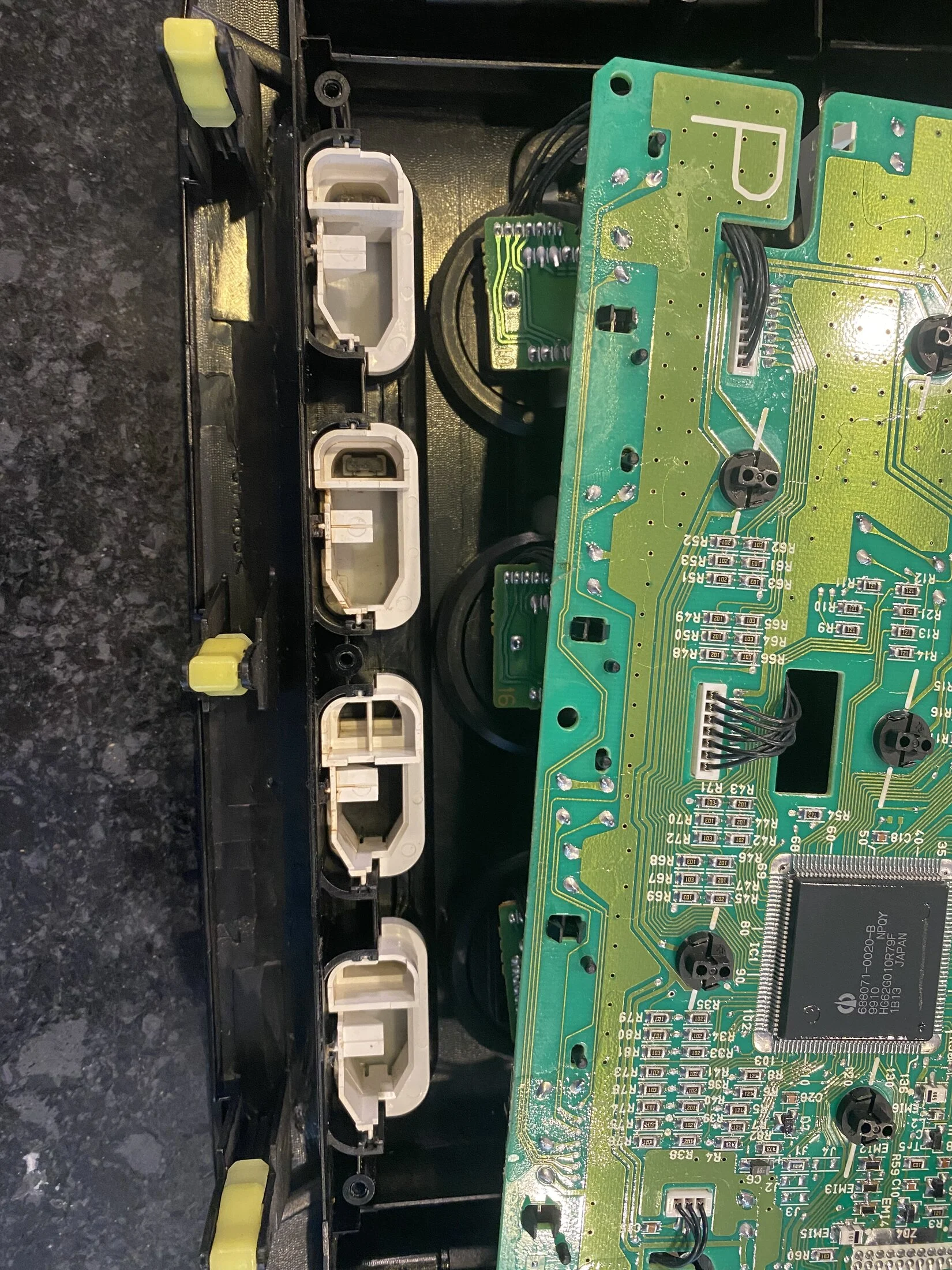

Looks like in the 24 life of this thing some one had coofee possibly spill and is gumming up the buttons.
How do I remove the white push button?
How much did it help? Risk/reward?
Risk is cracking or breaking something plastic. The buttons slide in and out better now but the one for the rear ac still doesn't press the micro switch on the PCB, so I'll have to try again some time. I saw a youtube video where a guy glued little bit of match book to the button. his claim was that the plastic shrinks with time and it does press the switch all the way.
