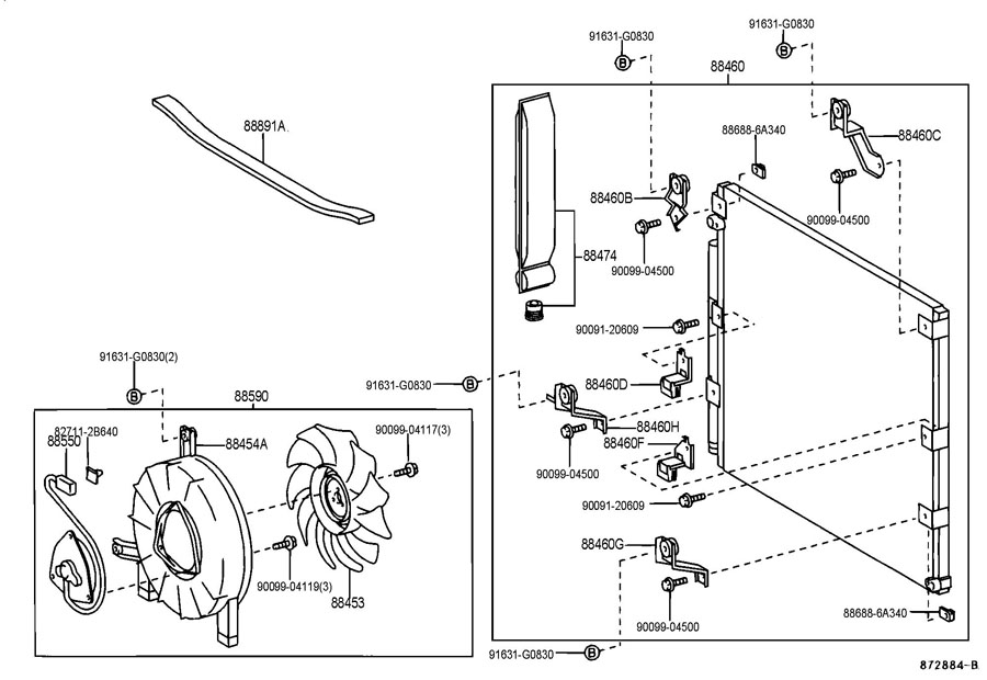

There's an AC condensor fan on my 99LC. No surprise there, but:
- It does not appear in the 2004 FSM in either teh AC or Body Electrical sections
- It does appear in the Toyota parts catalog
I'm trying to debug an issue with the fan. Anyone know which switch controls the fan power and what conditions it need to run/not run. Mine's not running.

I thought about, would like to install an electric fan to aid in cooling when the AC is on.
Is there a kit factory kit that bolts/plugs right up??
Looks like there is a part number right there. CDan will know about availability. IIRC, he was able to source the same thing for the 80-series trucks as their a/c isn't quite as stout as in the 100, and every bit helps.
