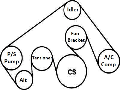

Negative.
Harmonic Balancer is at the very bottom of the engine (the large pulley at front/bottom) It connects to the crankshaft of the engine and is the pulley the powers everything the serpentine belt drives.
Labeled 'CS' (Crank Shaft) in this legend.
