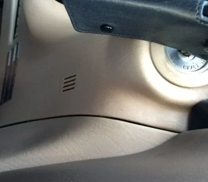

AC has been acting up lately. When I set the temp at say 72 degrees, all of a sudden, the blower will go to full blast. Then if I go off AUTO to #1 or #2 it slows down to a normal speed. Its an intermittent issue, but lately happens a lot more frequently.
I found something that says there is a sensor for the temperature in the cabin, behind this panel. Does anyone have any advice on how to get to it and what needs to be done? Cleaned or replaced?

Do a search - there's a few threads on this topic.
IIRC the sensor is by the right knee on the DS. You should be able to pull the panel apart and see the wire attached to it.
Yup. Run a search on cleaning the sensor. Also, the hose (white on my 99) was disconnected and kept it from reading the correct cabin temp. A zip tie fixed it.
