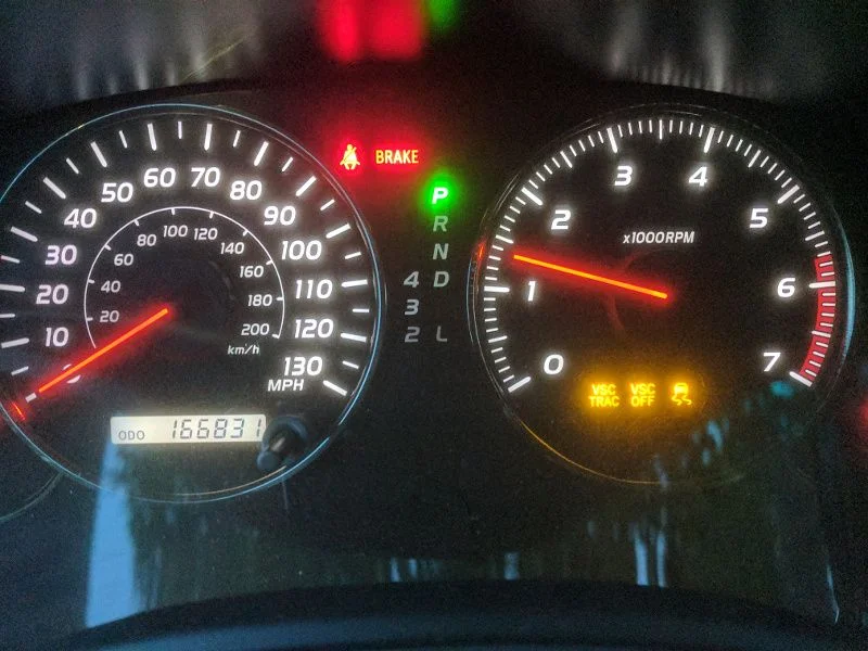

ABS/BRAKE/ALL 3 VSC lights on.
good advice about the o2 sensors. Went ahead and ordered bank 2 sensor 2 (Denso from Rock Auto). They get here Wednesday.
I cleared the codes using my OBD II reader.
Got a weird one today: driving home on a straight flat road and went to brake for a stoplight. Weird metallic screech noise, but no lights this time. No braking issues either.
Worried the sound is a sign of impending death for the master cylinder. If master cylinder is failing, would I expect softer brake feel? I’ve had no braking issues at all, just the noise and, until today, brake and vsc lights.

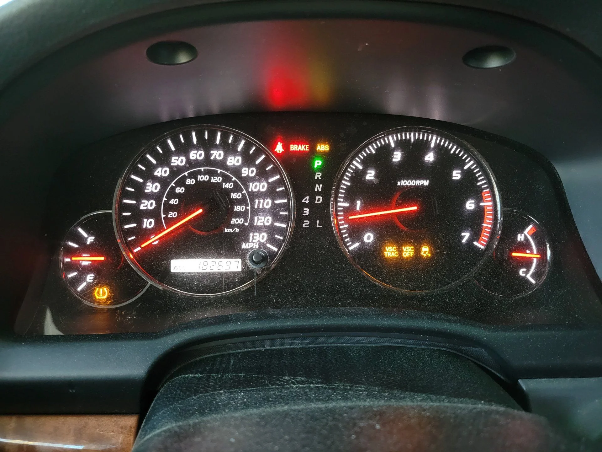

No lights at all on the 4-hour drive to the beach. No lights while driving around. The minute we get on the road to drive home, and the car is screaming at us with the beep and screech light, brake light on, and VSC lights on.
Now I have to delay a work trip to get this to the dealer tomorrow morning.
Saga continues…this car is not safe to drive at all.
Dropped it off at the dealer yesterday afternoon. 1 hour round trip (thanks ATL traffic).
Get a text today saying it’s good to go. They stated, “My shop foreman stated the error code was not erased after repairs. I had my Tech and Master Tech overlook the repairs and also perform a road test to make sure the vehicle is safe to drive.”
Coming to a stop on the way home, dash lights up like a Christmas tree, brutal screeching noise from the pump, brakes went soft. Pulled the e brake. Braking came back right away. Dealer initially asked me to drive it back to them.
