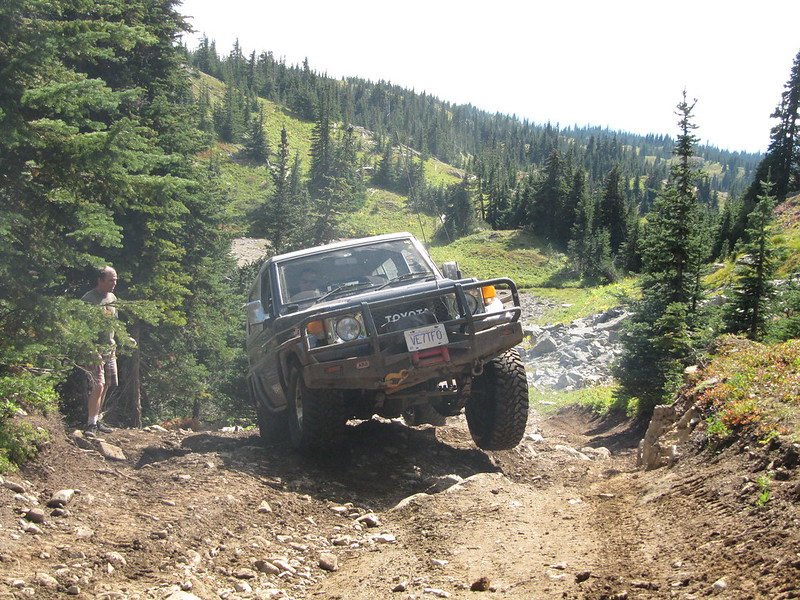

I've had 35s on my 74 for about 4 years now. Emu heavies, front axle moved forward 1".
Get a little rubbing but not bad. Wheels great with stock 4.11s and Marks 3.05:1 t case gears.
I got the 1.08:1 high range set, but if I were doing it again I would have gotten the 1:1 high range. I do some long highway trips and the truck is happiest about 60-65 mph. Oh, it'll go faster, but it's less happy about it. 4.11s and 35s would be just fine with the 13B-T, which I believe is similar in power to the 1HZ?
The 35s are definitely harder on wheel and knuckle bearings. I sure like the set up though.
