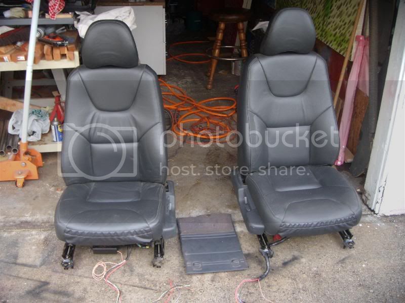

OK, so here's some photos so far:
first up, near perfect match for color to the stock interior- looks even closer in person.
red and black are power/ground wires; purple is an switched 12v (only moves when ignition is on?), and from what I can tell so far, the orange and blue wires are for the seat heaters.
looking good and I haven't even cleaned them yet!!!
driver's side- more wires, but basically the same setup if/when I take out the memory computer
and another shot of them from the side
stay tuned for some install shots as I get going on them.
cheers

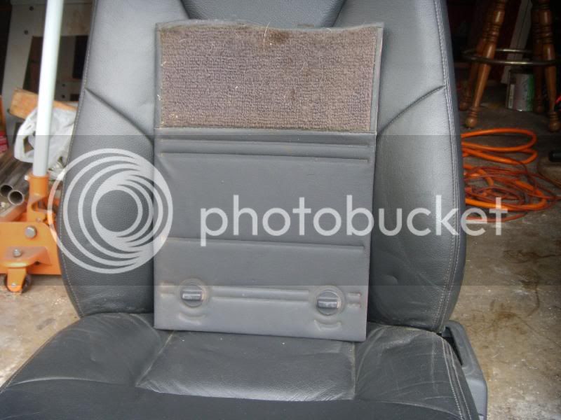

as to the seats, I started the first mock-up stuff today- boy are these seats BIG! I'm going to remove the rear heater (Haven't used it once since I bought it) and possibly move my amplifier as well so that I can make room to mount the seats a little lower than these pics show. It really looks like the actual mounting won't be as bad as I thought it would be.
I need to take out the heater and maybe the amp because they interfere with the motors on the seats (there are three or four of them).
even up high and on blocks of wood to help place it, the seat felt perfect!
I'll get to making mounts and removing stuff probably on Monday sometime, enjoy the pics!
