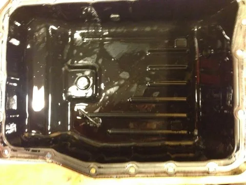

After removing the drain plug and letting it drain for a while, I dropped the pan and what I found was perhaps not the most awesome thing I could have:
Yes, that's a bolt in the bottom of the pan, stuck to a magnet. There's so many damn bolts on the VB, it took me a few minutes of laying on my back under the truck alternately looking at the FSM and up at the VB to sort out where this came from. It turned out to be from the corner of the filter, not super critical I wouldn't think. While never a good thing to have something like this rolling around, I'm more concerned with why this happened in the first place.

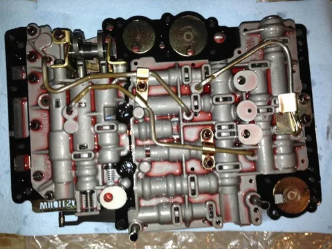

A couple hours of loosening bolts and letting more fluid drain, I finally got the VB out. I think what I might do is talk with a transmission shop to see how much it would be to have them take a look at this thing. Honestly, I think it would be cheaper than mailing it back to Wholesale...

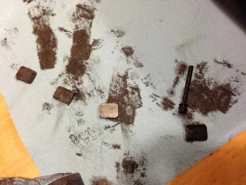

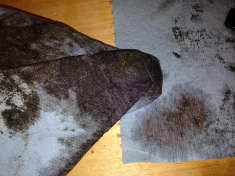

Now to the troublesome part. Ideally, we wouldn't ever find flecks or shavings other than on the magnets, but is there any amount of this that's okay? The streaks are what I pulled off the magnets.

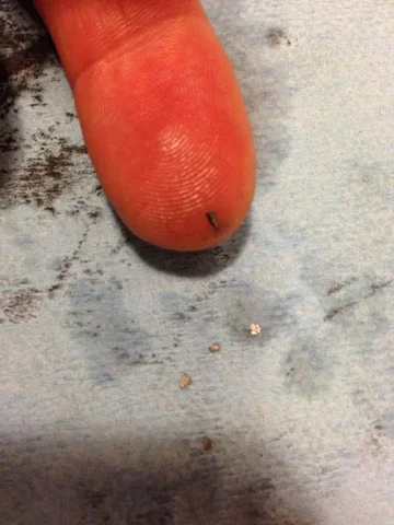

More of what I found. There were definitely some flecks floating around in the very bottom of my catch basin but nothing too large and pretty sparse I suppose. What you can see, though, is that some of this is bronze from bushing wear... The largest steel piece I found can be seen on my finger.

First off, let me just say the folks at Wholesale Automatics are fantastic. I spoke with Rodney and Trevor and did a little troubleshooting. They even went so far as to stay on the phone and walk me through a few things I could check myself before doing anything more drastic. But, as nothing we did revealed anything obvious, it'll be going back to them for a warranty rebuild. Amusingly, having now poked inside of the VB in detail, I really don't think I understand the specific workings of this transmission any better than I did before...
As for the flecks and fluid I found, their opinion is that this is about what one should expect after 20,000km and the fluid looked perfect. So, I guess that's that for a while. Might as well start the rebuild at this point I suppose.
