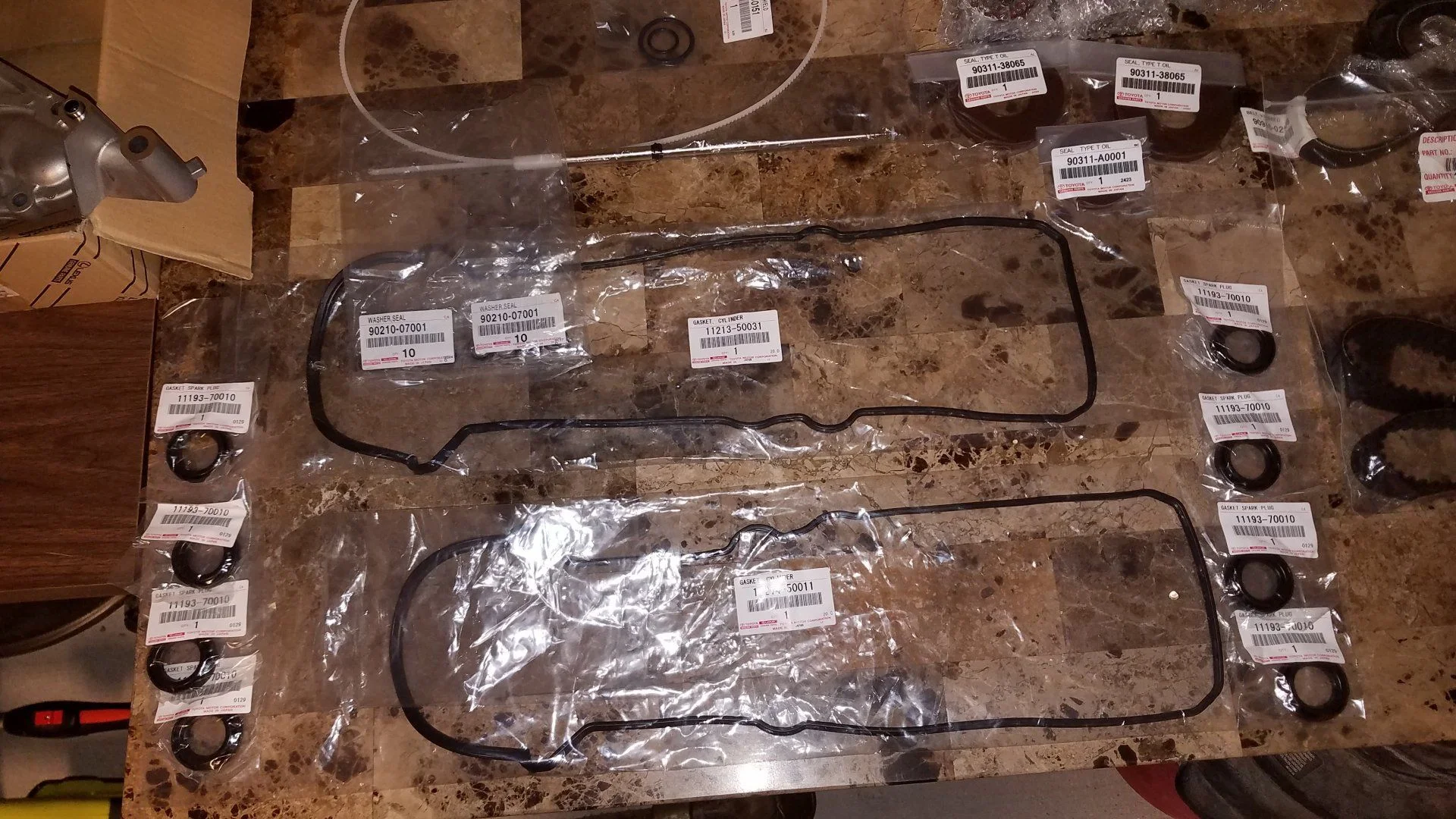

Thanks for the reply Jim. That was my first instinct, then my concern became what ifs, like what what if the little bits of rubber clogged something like the oil pressure sensor etc. I did run the engine and go for a short drive and oil pressure looks normal as far as i can tell from the gauge cluster . I have a set of valve cover gaskets coming in early next week so i'll update after i pull the cover.

I will check the write ups here for sure before proceeding. Don't have the FIPG or know which type to get yet may have to wait to get at the dealership on Monday. I did order the bolt seals 90210-07001, and the spark plug tube seals 11193-50010 . My plan is to re-use the bolts themselves, if that is advisable.
Oh sweet, I didn't even realize that they sold the seals alone. I think you want 00295-00103 black Toyota FIPG, but you may want to double check. I'm not able to look it up atm.
Yep they sure do, but i would order the Wits End valve cover gasket kit 100 Series 2UZ Valve Cover Gasket Kit- PRE 08/2002 if i ever do the job again as it includes new bolts with the seals and spark plug seals as well and it's twenty bucks less than what i paid elsewhere. Hopefully i wont have any broken or missing bolts.
