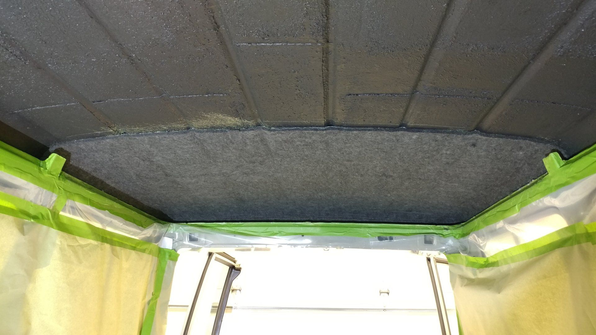

Had a chance to do the headliner today...another big job I wanted to get done. I used a product called Thermozite....bought it here:
Neat material. Allows for some stretch so it was nice to tuck in the corners. Made from recycled bottles.
I had bought a proper spray gun for this job....just like the pro guys use. I've always used cans of 3M spray adhesive....this was easier and I plan on doing some more with it. Used a pretty standard contact adhesive.
Sprayed both surfaces
Then we started laying it in. I started with the center and worked towards the edges. A little tricky getting glue in the edges but we managed. I think I could have a career as a glue sprayer. Probably not a career as an installer. Very challenging.
The seams get covered by the roof supports....they're wide so we had a lot of room to get the seams where we wanted them. Between the Damplifier Pro, the Spectrum and now this covering, we're going to have zero room between the supports and the roof. Supports go in tomorrow.

Is the dappled appearance on the roof due to the contact adhesive or the Spectrum?

Spectrum.....we brushed it in so it was not uniform at all. We should have sprayed or rolled. But I knew I was going with the thicker material so it wouldn't be much of an issue. Plus when we spray we have to tape everything out....brushing gives way more control and way less mess. We do that on floor boards usually if there is going to be carpet going in. You can really lay it on thick too.

I REALLY like how your roof/headliner solution went. I'm going to flagrantly steal most of this... already have the Spectrum.

You should lay down some Damplifier Pro before you Spectrum...just a few sheets...nothing crazy. Really helps tighten things up.

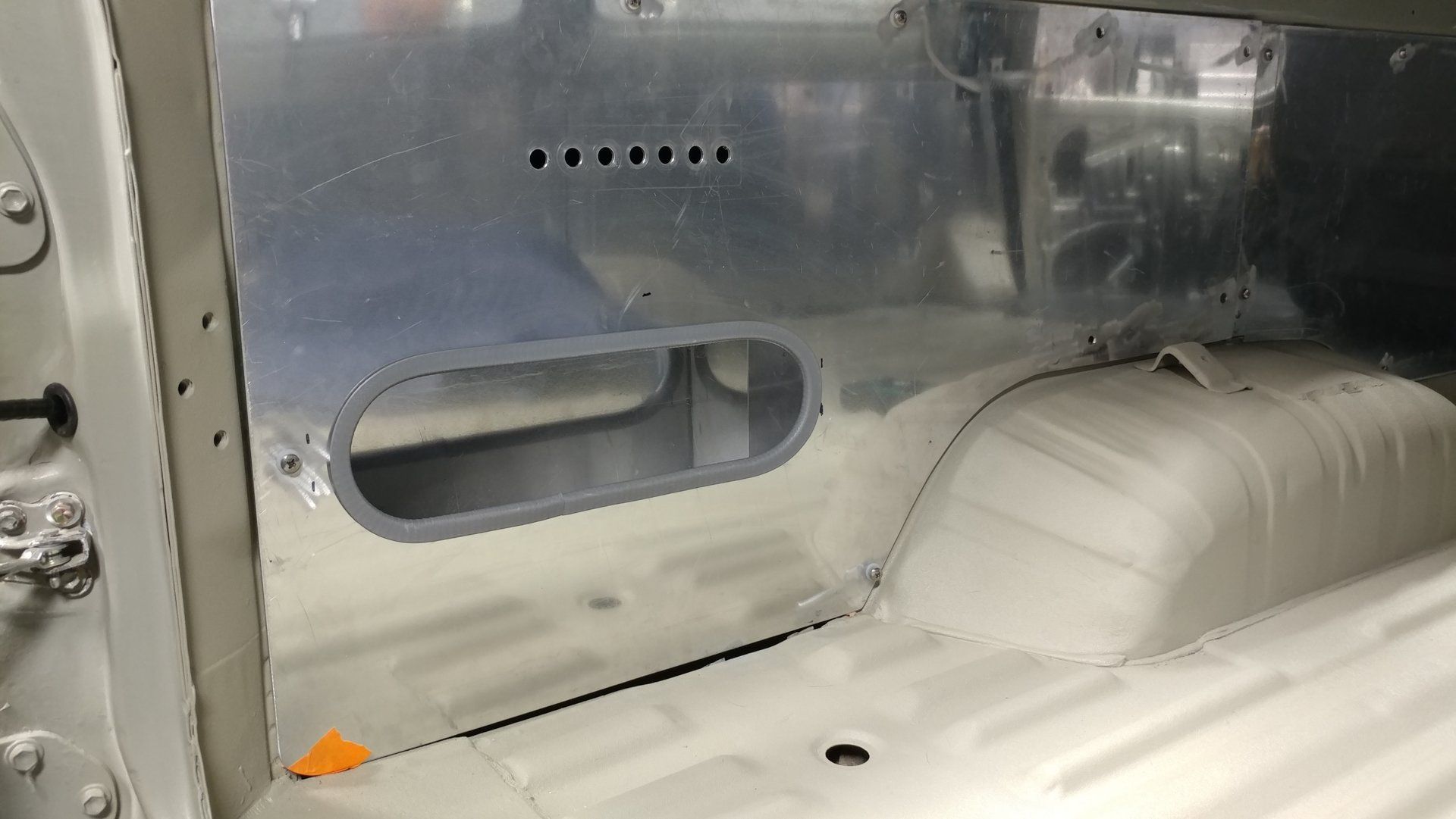

Back to our side panels and storage.....came up with a simple solution.....a box mounted behind the panel.
Make a box out of aluminum,
Situate box on rear of panel
Cut opening out
Trim opening out with leftover edge moulding from roof project
We'll line the box with carpet once everything is dialed in.....going to repeat this for the other side. Surprising amount of storage in this little cubby.
Like the solution for the rear panels, looks great and gives great access to the space withouth having to remove the panels. How did you manage to screw the panels to the body? Rivnuts?
Yes on the rivnuts....really nice for this application.
I like the idea of storage without hatches, doors or panels that have to come off. Just nice simple storage areas for smaller stuff. Going to be nice once they're coated and fully installed.
