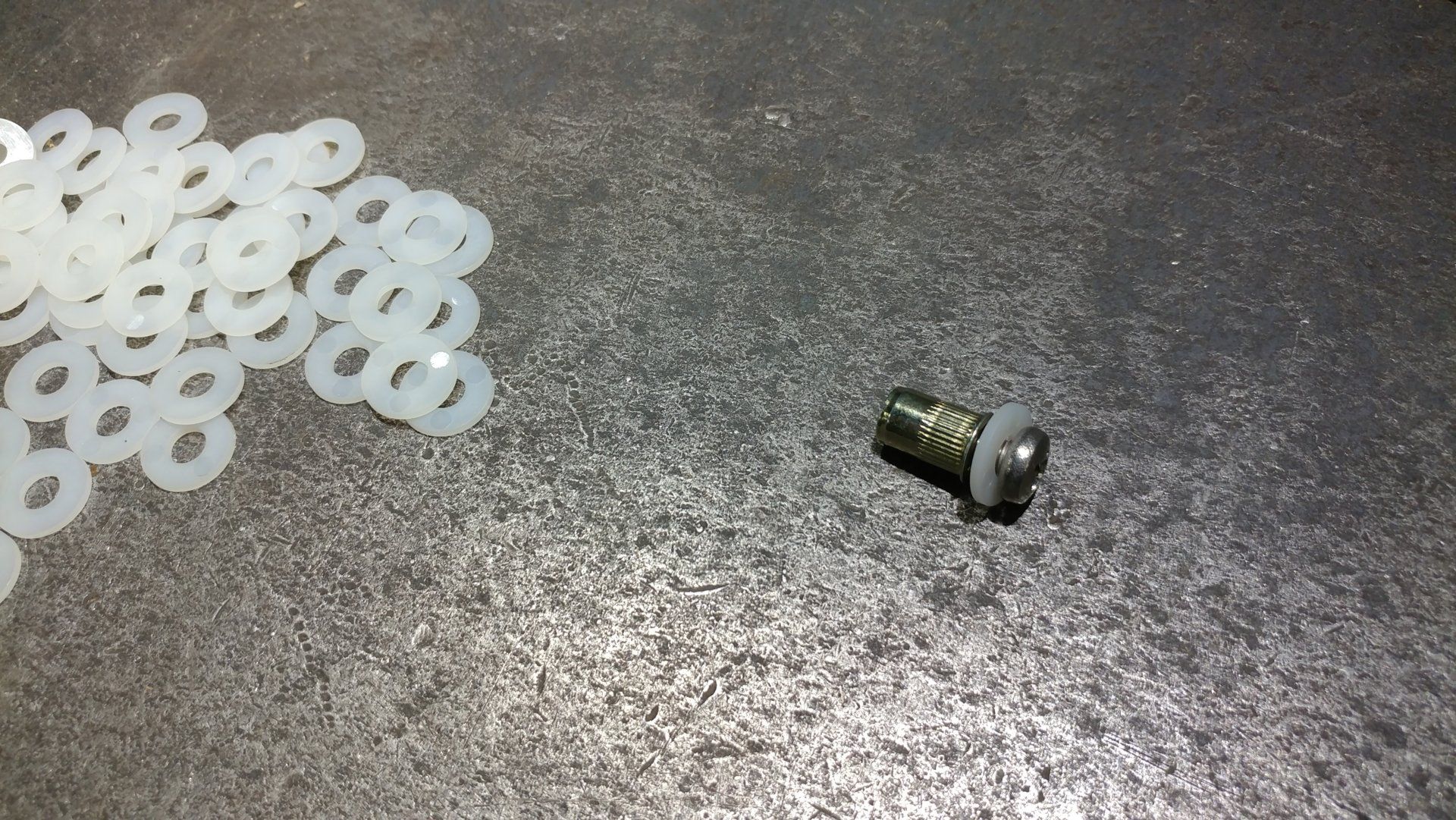

At some point we made a run to the fastener store and picked up M6 riv-nuts, nylon washers, stainless screws.

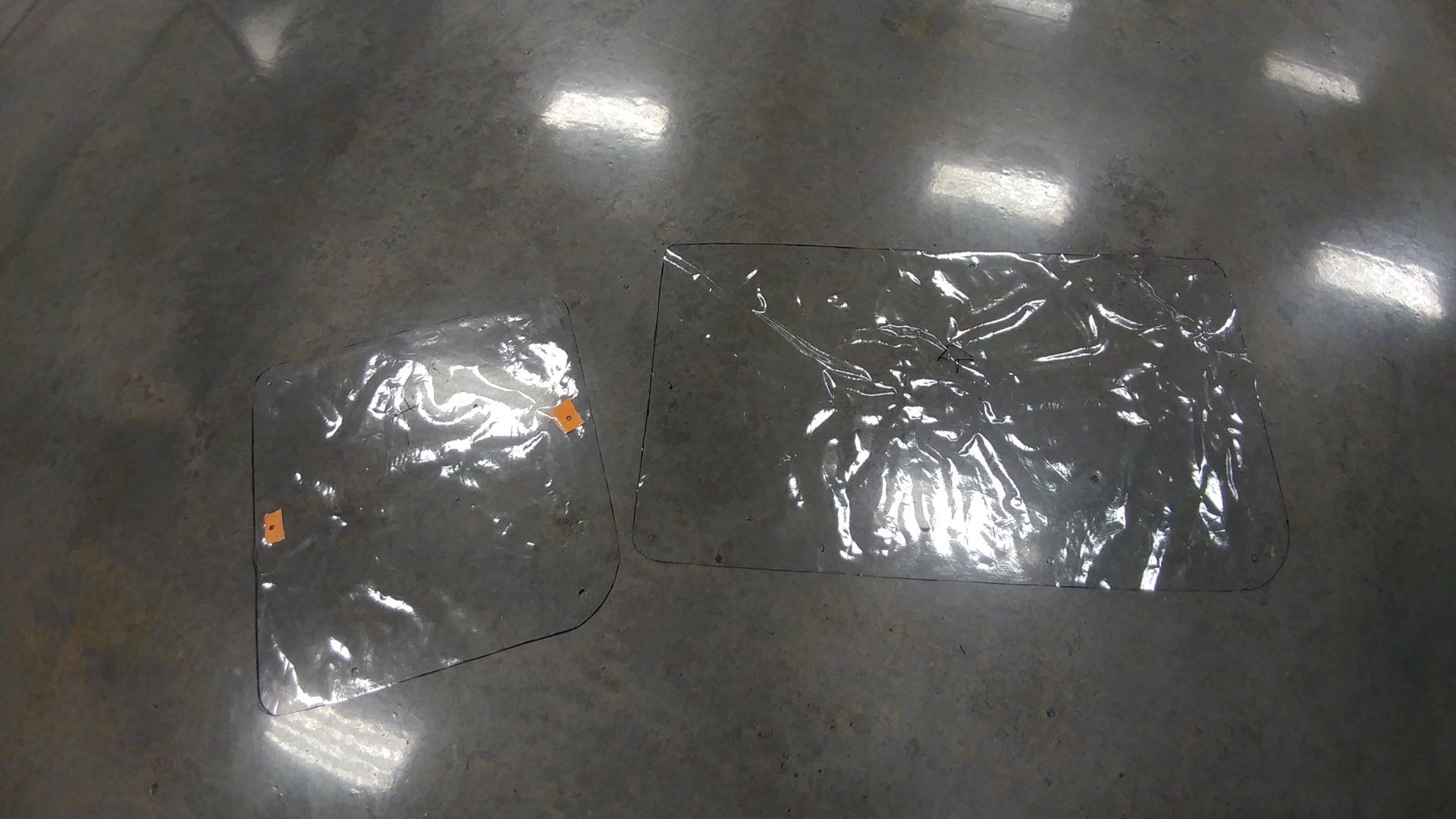

Get the CAD file printed and trace...
This is how our CAD setup went.
We traced the openings on some shower curtain plastic that we use for vapor barriers(easy to trace out the pattern you need for doors). Added bonus of being able to mark all the holes. We'll see how close we get.
Transferred onto the aluminum sheet.....let the cutting begin.
That clear shower curtain idea is rockin'. You'e got me convinced I don't need to pay to have mine laser cut. You've pulled off a super sharp look with patience and attention to detail...
The shower curtain worked like a treat and there is probably a way to use it as the vapor barrier.
We spent far too long finishing the edges nicely and all that good stuff....we didn't need to do that since we'll be coating them with Raptor. If they were going to be wrapped in material, nothing would need to be done on the edges. Jigsaw, file, sanding block...all set.
