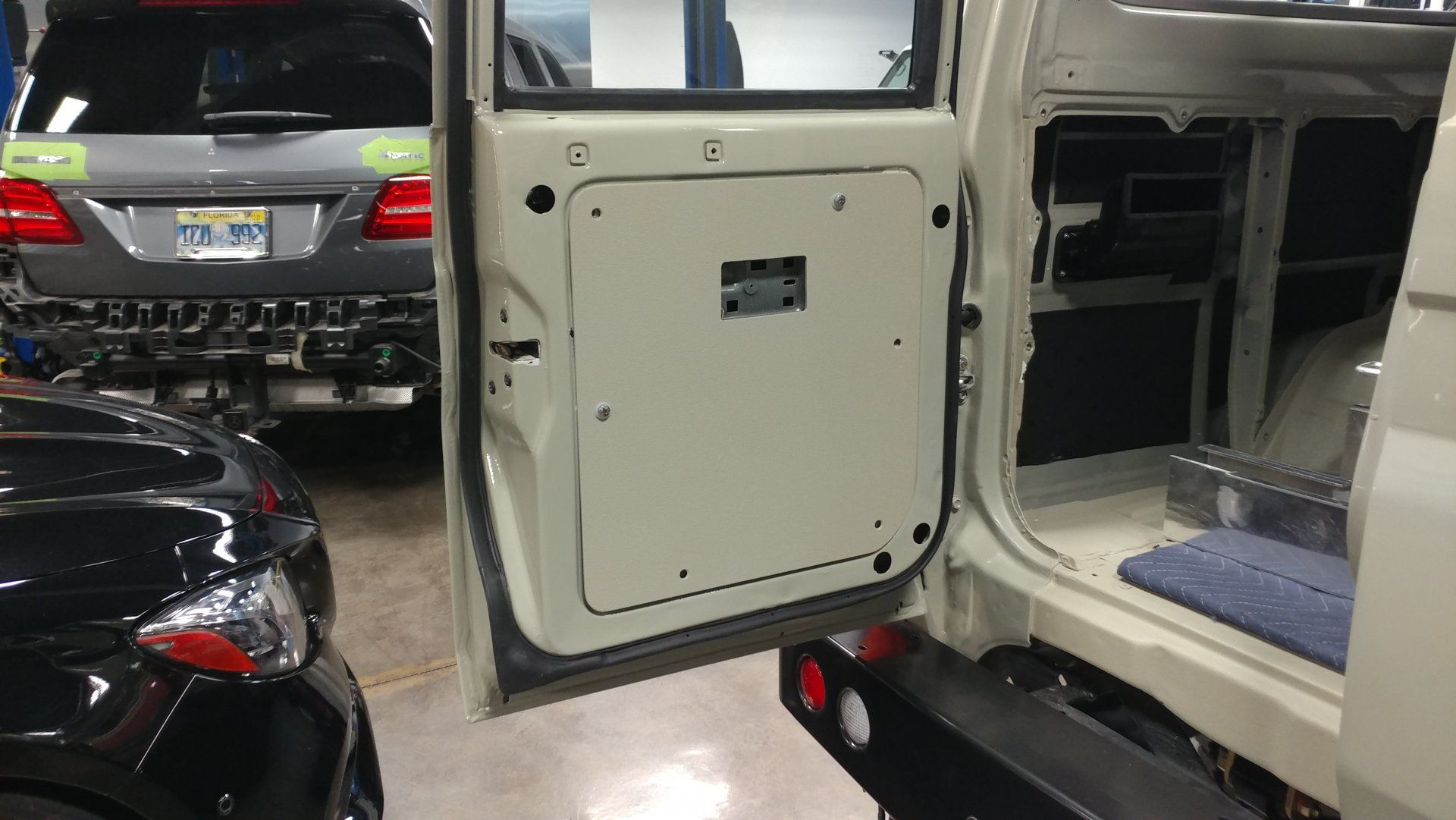

Also decided yesterday that the paint finish on the doors wasn't really as good as it should have been. Those poor rear doors....they should have gone in the dumpster. Just a total mess. Decided to do them in Raptor.....then got rained out.
But it's FL so by afternoon it was nice enough out to shoot....
Storage pockets turned out really well.....
Trying to figure out a new camera....Troopy makes a good practice subject.
Rear doors all done.....kind of.....I have a grey inner rear door handle release that is hung up in Japan in a post office somewhere. No biggie. Color is a little off on the panels...for some reason it doesn't bother me. Really happy we went this route.
